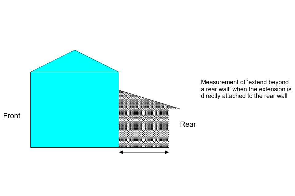

I have a prior approval for a larger extension on a detached house. The extension has been built to 5.7m (to rear wall face) with an overhanging flat roof of 1 meter. The architect put in for a 6m extension as they believed the roof doesn't count towards the request. We should have gone to 8m for more coverage and are kicking ourselves for not!
The neighbour did object the application, and the planning officer found zero issue in approving the application.
Anyway within a week of the roof being on the neighbour has called the council (I assume) and the person who came to see said the overhang counts towards the limit as it's not a normal size, so we are 70cm over. I am expecting a letter/email from the planning dept soon.
So far my research has led me to this technical guidance for permitted development and looking at A, G, ii
https://www.gov.uk/government/publications/permitted-development-rights-for-householders-technical-guidance/permitted-development-rights-for-householders-technical-guidance#other-classes-under-part-1
It says "Measurement of the extension beyond the rear wall should be made from the base of the rear wall of the original house to the outer edge of the wall of the extension (not including any guttering or barge boards)." And has this nice little picture
Is my understanding correct and are we safe or should I be worried and what would be the next best steps?
Thanks!
My own thoughts are that, I would do nothing, and if planning come back to you, show them the picture above, and wave goodbye.

Hi all,
An unfortunate update! Help requested.
The council have responded to say this is an issue and have asked us to either remove part of the roof that's been built or  put in a homeowners application for retrospective approval. Details below of why they are staying the 1m roof overhang should be counted into the measurement...
We had approval for 6m. The wall is out to 5.7 and the overhang brings it to 6.7. although the council see no issue if we built to 6m and had a 30cm facias/soffit.
Council explanation;
"I would agree that the provision of a slight overhang to form a soffit or fascia would be considered a de minimis protrusion for the purposes of measuring a Class A extension. However, I cannot agree that the overhang in this instance can be considered slight, minor or de minimis. The roof oversails the extension by 1 metre and is not considered necessary to accommodate finishing materials or guttering etc. Page 4 of the Technical Guidance makes it clear that “given the very substantial variations in the design of individual houses, this guide cannot cover all possible situations that may arise” and does not specifically address the matter of roof oversails"
Essentially, based on whoever id judging they can make up any rule according to the line stated on page 4.
My architect used the points discussed in the first post but the council didn't budge. Additionally they said we need an application to cover the whole build and not just the roof as the roof forms part of the extension and that means the whole extension is not permitted.
I've asked my good neighbour to submit a positive comment when the notice comes through.

At a minimum, your prior approval application would have required a block plan to be included showing the proposed extension. Block plans are top-down views and usually show the largest outline of your proposal which should have been the roof with the overhang.
The tech guidance carries limited weight compared to the regs. The regs use the wording "the enlarged part of the dwellinghouse would have a single storey and extend beyond the rear wall of the original dwellinghouse..." so I think it is fair for this to include large overhangs. You can no longer rely on the prior approval and therefore must make a retrospective householder planning application. No merit in requesting a different planning officer.
