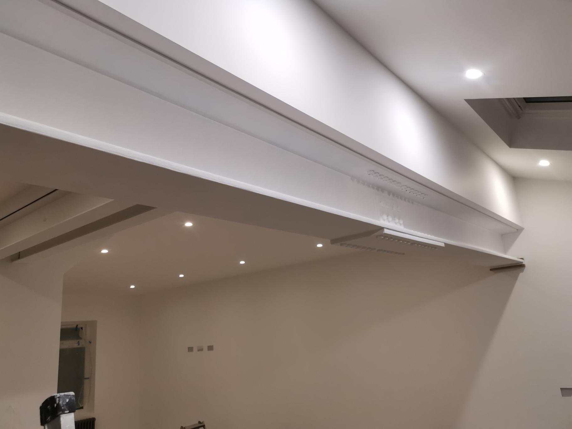

i had something similar, i think. I used a strip of 10mm aerogel and then boarded over the lot, that section of wall isnt any colder than any other so i guess it worked.
I did notice also that once i had painted the main beam with intumescent paint its no longer cold to the touch, no matter what the temperature outside so i guess that has some thermal properties also.
  • Like 2
Posted
Did you do anything for the horizontal steel above? (Got a similar set up going in soon).
Posted
yeah, ground it clean, primed it, intumescent painted it and then eggshell over the top. Probably one of the most long-winded jobs ive ever done in my life as its over 8m long and exposed on 3 sides. Here is a pic of it after the intumescent.
  • Thanks 2
Nice!
Stupid question: surely there is some cold bridging from the upright steel you insulated with aerogel, to this horizontal steel as they are touching?  Or is it so many minimal it's best ignored?
Posted (edited)
3 hours ago, mistake_not said:
Nice!
Who knows, id imagine so but I have no way to measure such a thing. I insulated the upright more to stop condensation behind the plasterboard. All I know is the house is 23° and the beam is warm to touch even though outside is -2°.
