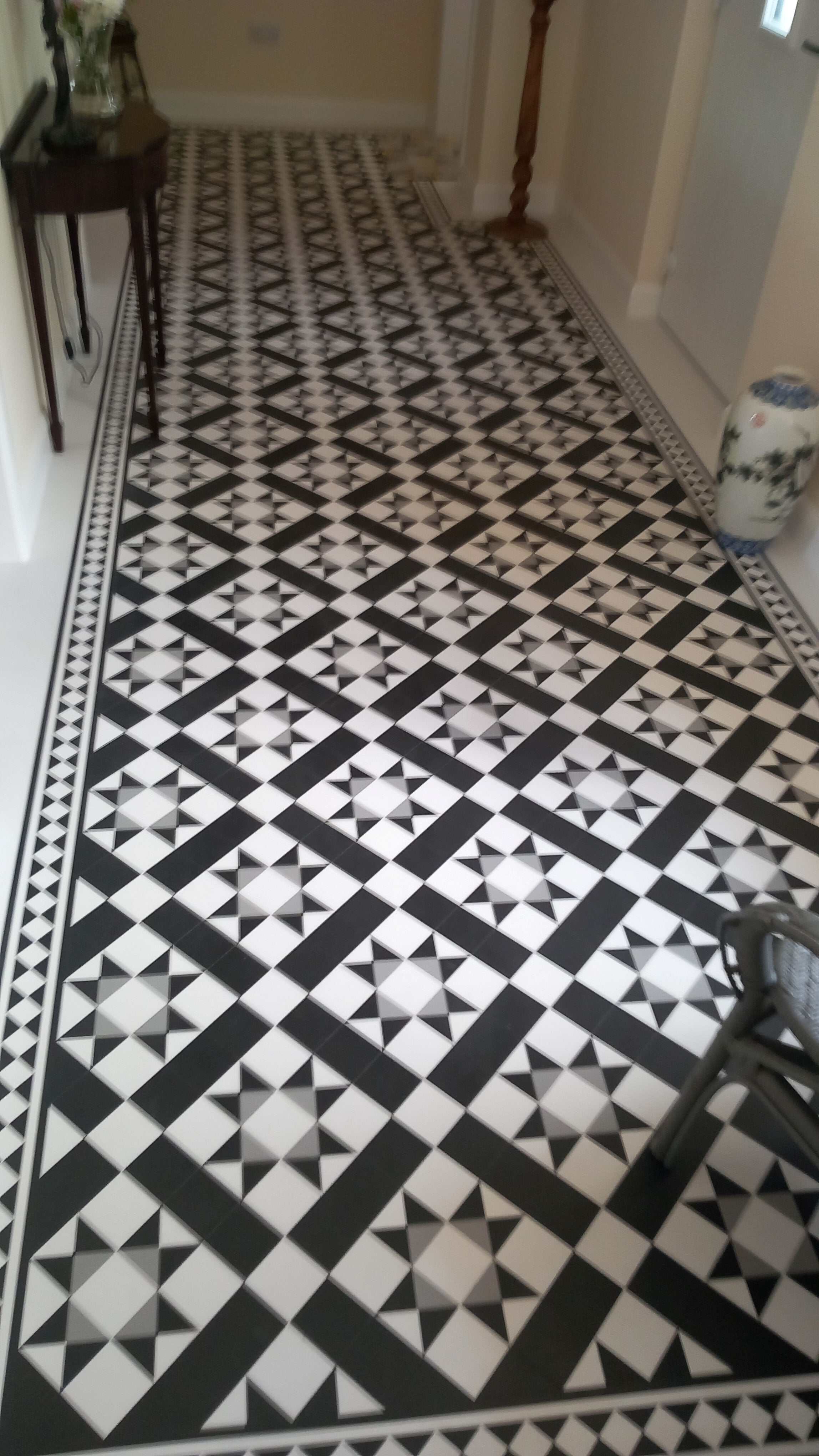

scottishjohn Posted May 28, 2025 Posted May 28, 2025 (edited) Iwould worry that it is too thick and will take foreverto dry out Icould be totally wrong just when mine was done it took 6weeks with underfloor on to get down to the 3% moisture the floorers wanted to lay stick down LVT and that was after they had ground it all to get it toally flat but the final job showed they knew what they were doing best trade on the job by far that floor is made up from hundreds of little bits only big bits are thesquretiles -even the border is seperate bits Edited May 28, 2025 by scottishjohn
