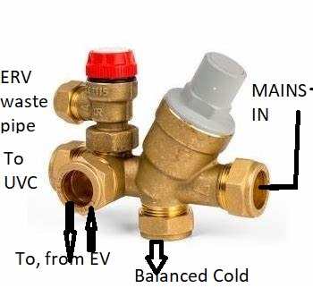

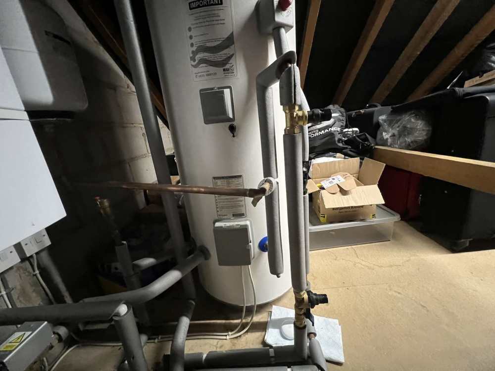

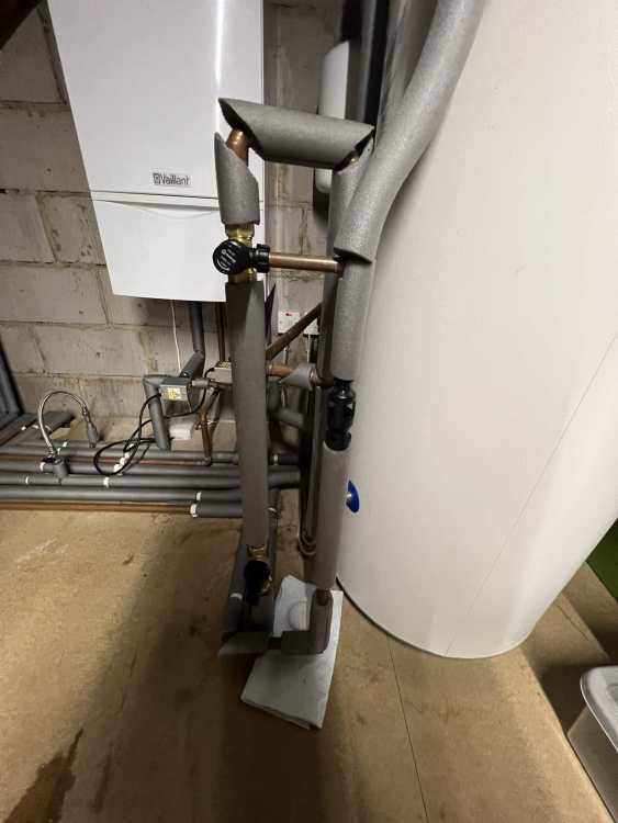

Mattg4321 Posted February 12, 2025 Author Posted February 12, 2025 2 hours ago, John Carroll said: Is your system plumbed up like this?. Yes although EV from pipework to cylinder. Which looks fine from my research.
John Carroll Posted February 12, 2025 Posted February 12, 2025 Is the EV just teed in somewhere down stream of the valve set on the cold supply to the cylinder?
Nickfromwales Posted February 12, 2025 Posted February 12, 2025 2 hours ago, John Carroll said: Is the EV just teed in somewhere down stream of the valve set on the cold supply to the cylinder? Ah! It’s a dark pic, but I think the issue is that the EV has mistakenly been teed off before the PRedV / control group. @Mattg4321, can you take a better pic or confirm if that’s the case? If so, then we’ve got the answer methinks. The EV should be tapped in by removing the black plastic plug on the rear of the control group, ideally.
Mattg4321 Posted February 12, 2025 Author Posted February 12, 2025 2 hours ago, John Carroll said: Is the EV just teed in somewhere down stream of the valve set on the cold supply to the cylinder? Yes
Nickfromwales Posted February 12, 2025 Posted February 12, 2025 2 hours ago, John Carroll said: Is the EV just teed in somewhere down stream of the valve set on the cold supply to the cylinder? Upstream, not downstream
Nickfromwales Posted February 12, 2025 Posted February 12, 2025 It looks like it’s teed into the rising main?
John Carroll Posted February 12, 2025 Posted February 12, 2025 To avoid any confusion, it should be teed in somewhere between the valve set and the UVC cold water inlet, I call(ed) this downstream, which I think @Mattg4321 has confirmed, in other words, correctly, whatever about ideally.
