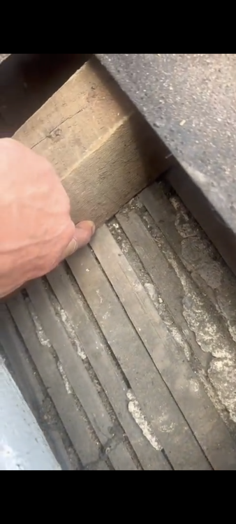

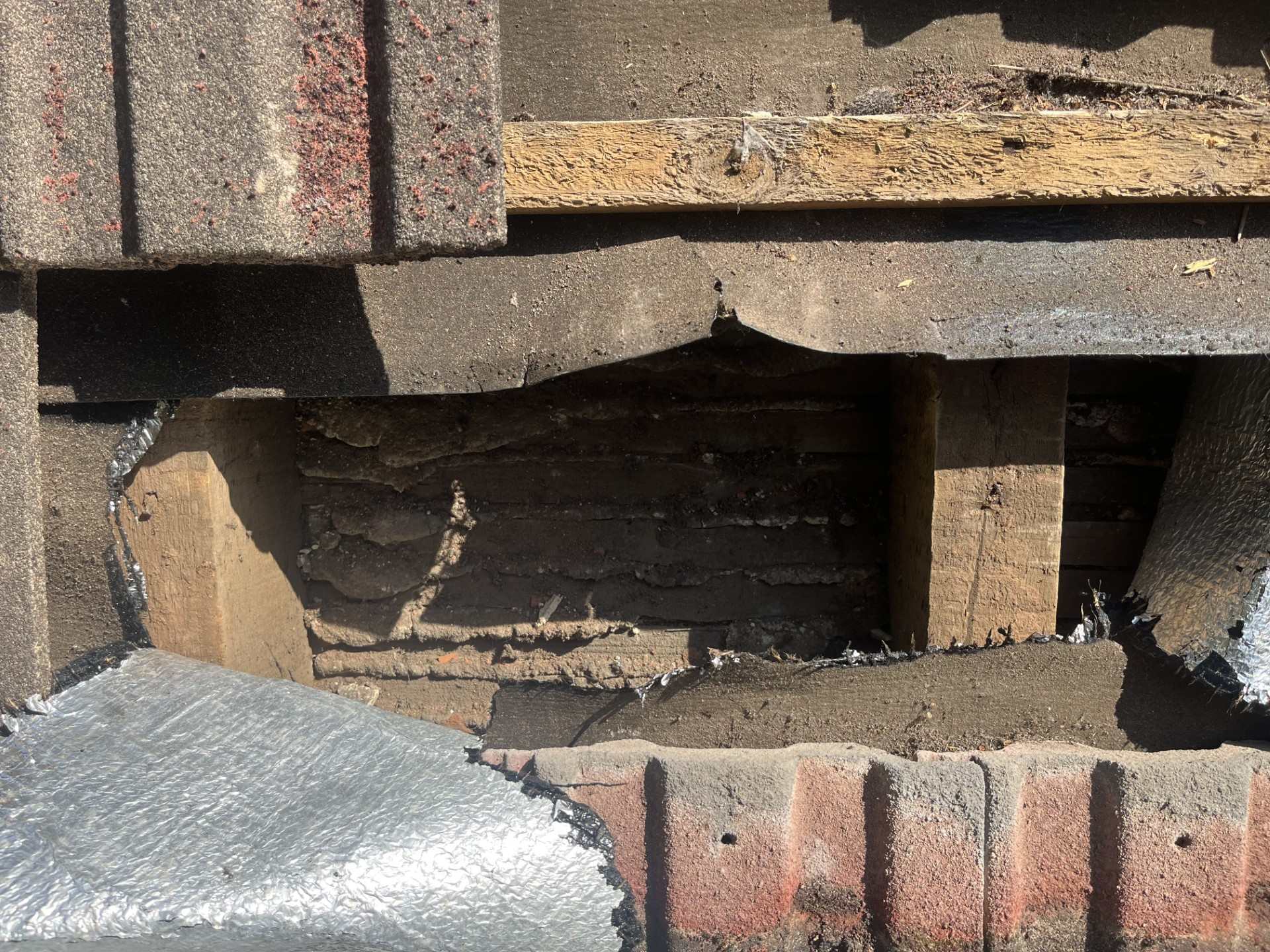

I am currently converting a Chapel building and unfortunately discovered a lath and plaster ceiling in the roof in between the decorative tongue and groove wooden boards and the rafters ...I have some photos if needed. I had an insulation spec from my architect who I have not taken through to construction stage and I now cannot achieve this spec and the lath and plaster is obviously in the way.
The original wooden sarking boards on the inside I really do not want to take down (from a cost perspective) therefore I think the L&P has to remain in place, you could not take it out from above.  The building is not listed.
Building control do not have a solution as apparently it is not part of their sign off to get the insulation to the spec below.
Does anyone know how I would go about solving this problem to achieve the same U value in the original spec, there is maybe an option to raise the roof an inch and therefore create or create a warm roof instead (??) (currently spec is a cold roof design), there are parapet walls in the building so raising the roof would not be too hard.
But essentially, if I wanted a re-calculation of the U value to make sure any different insulation arrangement maintains the same U value 0.13 - who would I employ impartially to calculate this or are good roofers able to do this? Sadly my current roofer does not seem engaged in finding a solution which is a shame or potentially it is normal to be provided with an exact design / insulation build up.
I have contacted Celotex technical department to see if they can help, but yes sadly this is my first roof so I am quite sad about it :)
Are lath and plaster ceilings frequently found, are there any work around suggestions?

If you weren't intending on removing the existing internal cladding boards, I'm not sure how the discovery of the plaster behind them introduces a problem. Perhaps some pics would be useful.
Hey Jay
Thanks. Discovered the lathe plaster ceiling from above when we lifted some tiles from the roof off ..so if insulation goes in from above the ceiling is in the way?
Thanks

If the current panelling is just fixed directly to the L&P ceiling I don't see it makes a difference.  Or are you saying there is some kind of gap between them?
1 hour ago, ProDave said:
Some sketches or pictures showing the roof construction and timber sizes is needed to have a meaningful conversation.

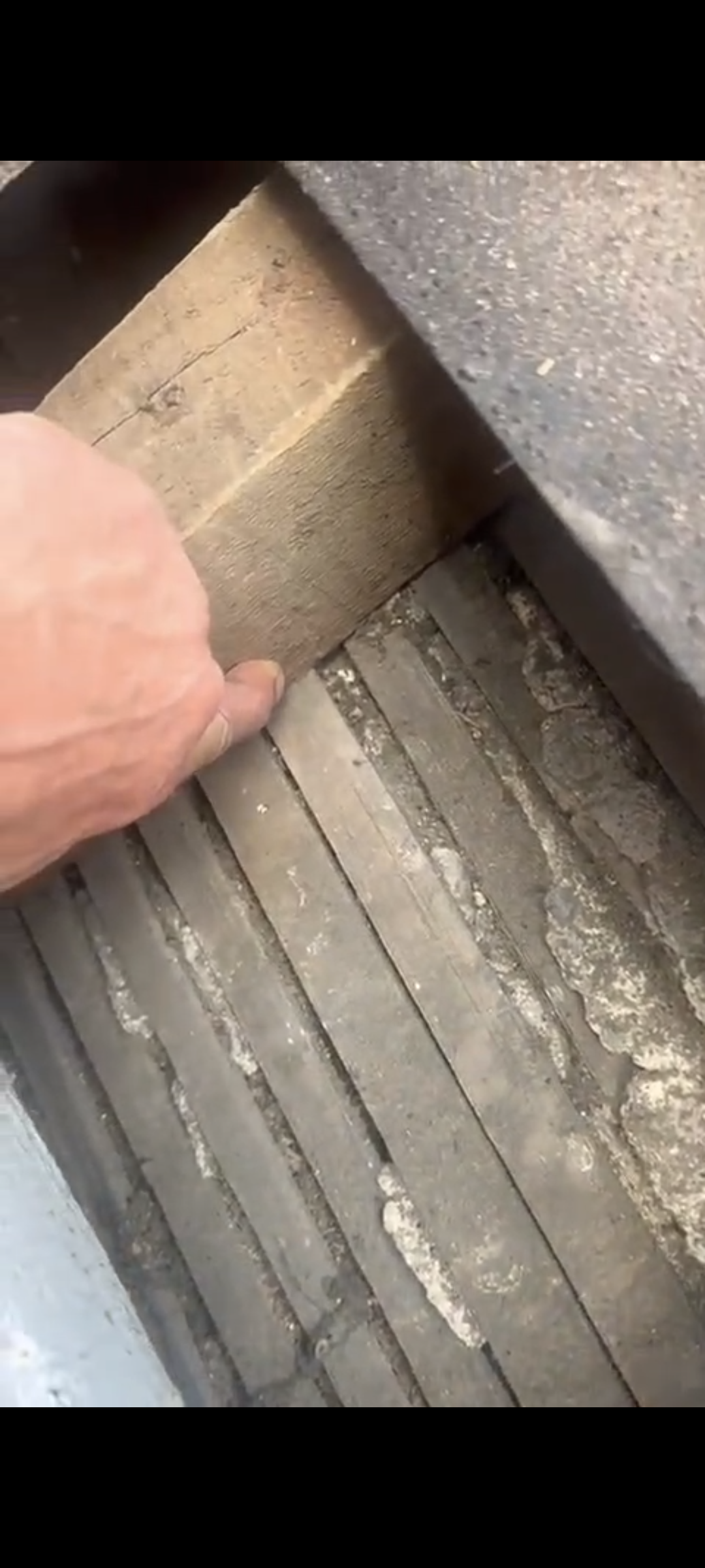

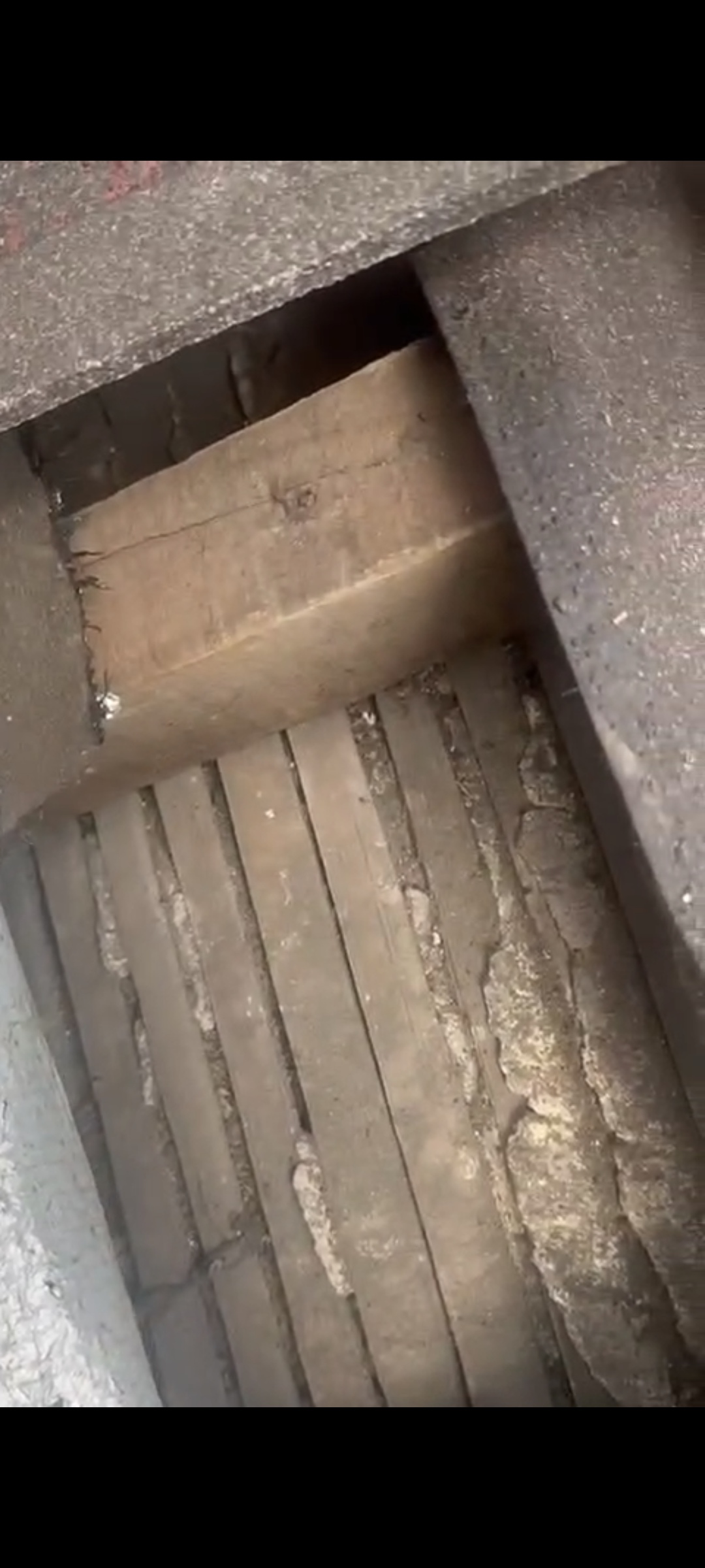

Yeah, this is head-scrambling! So the original plan was to take off the roof-covering, insulate with PIR leaving the T&G below the rafters and install further PIR below, yes? Insulation-to-insulation contact is, in my view, always best, but yes, if it was only the T&G there and you could get both layers 100% tight to the T&G there should be no risk of thermal by-pass (cold air in the 'layers of the sandwich'). However with the L&P there you are really going to struggle because of the 'snots'. HOWEVER... Since the L&P is 'under-boarded' and no longer needs the 'snots' to hold plaster to lath you could rake off and hoover out the snots and insulate tight to the lath. If it were me in these (less-than-ideal) circumstances I would primes the sides of the rafters and, after foam sealing any gaps, air-tightness-tape the PIR to the rafter edges.

Hi Everyone - thank you for all your responses... Some photos of the L&P attached and a word doc with the roof build up elevation
He talks of a warm roof make up, but then mentions a ventilation gap which would make it a cold roof.  Which do you want? ; - i would like a solution and a warm home - ideally cost effective, and also he is no longer my architect. :(
If the current panelling is just fixed directly to the L&P ceiling I don't see it makes a difference.  Or are you saying there is some kind of gap between them? - I do not know as I have only investigated from the top (outside in to L&P) - I could take some panelling off from the inside to see how tightly it is all affixed

The architect has specified insulation between rafters (I assume fully filled), breather membrane above, counter battens and battens, then new tiles.  You won't need to touch the ceiling.
