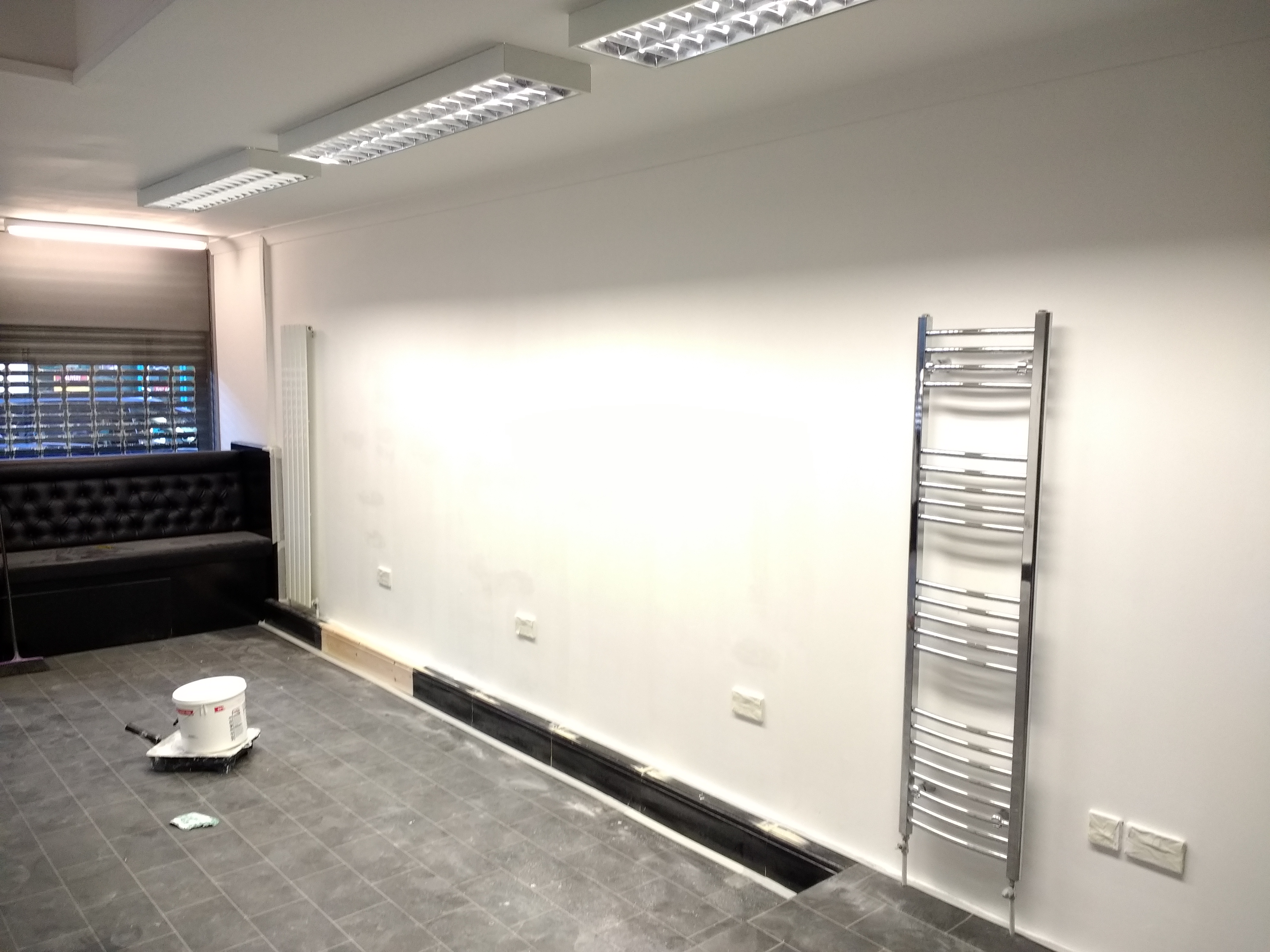

Tennentslager Posted December 3, 2017 Posted December 3, 2017 @Nickfromwales might help me out. Is it possible to add 3/4 radiators to an existing electric boiler set up. 28Kw boiler and 4 small radiators in the big front office. Three vertical ones and this towel rail thingy, it used to be a hairdresser. In the back there's 3 small rooms and a kitchen but with electric panel heaters which I guess are going to be very expensive to run. I've a small window of time to improve this...could insulated (or coated) microbore pipe be used to connect up some wet radiators. Don't really want to disrupt the nice floor and wondered if you could clip the microbore to or just above the skirting? It's a back office so doesn't have to look brilliant but not Uber shabby either? What do you think?
PeterW Posted December 3, 2017 Posted December 3, 2017 @Tennentslager use this stuff https://www.encasement-onlineshop.co.uk/PBSCProduct.asp?ItmID=20297796&AccID=120926&PGFLngID=1&gclid=EAIaIQobChMItciZvPvu1wIVy53tCh07UQoiEAQYCCABEgLCcvD_BwE
Nickfromwales Posted December 4, 2017 Posted December 4, 2017 Just run above the skirting and use Talon clips. They have lugs on the side to hold Talon trunking ( 10 / 15 / 22mm ) and just cut mitres. Tbh I'd just surface mount 15mm pipework and paint them, acceptable in most homes so ok for an office . Go to a few local plumbers merchants and ask for damages return radiators. I just bought 4 med /large radiators for £45. Tiny scratches / dents on side panels, hardly noticeable when fitted. ?

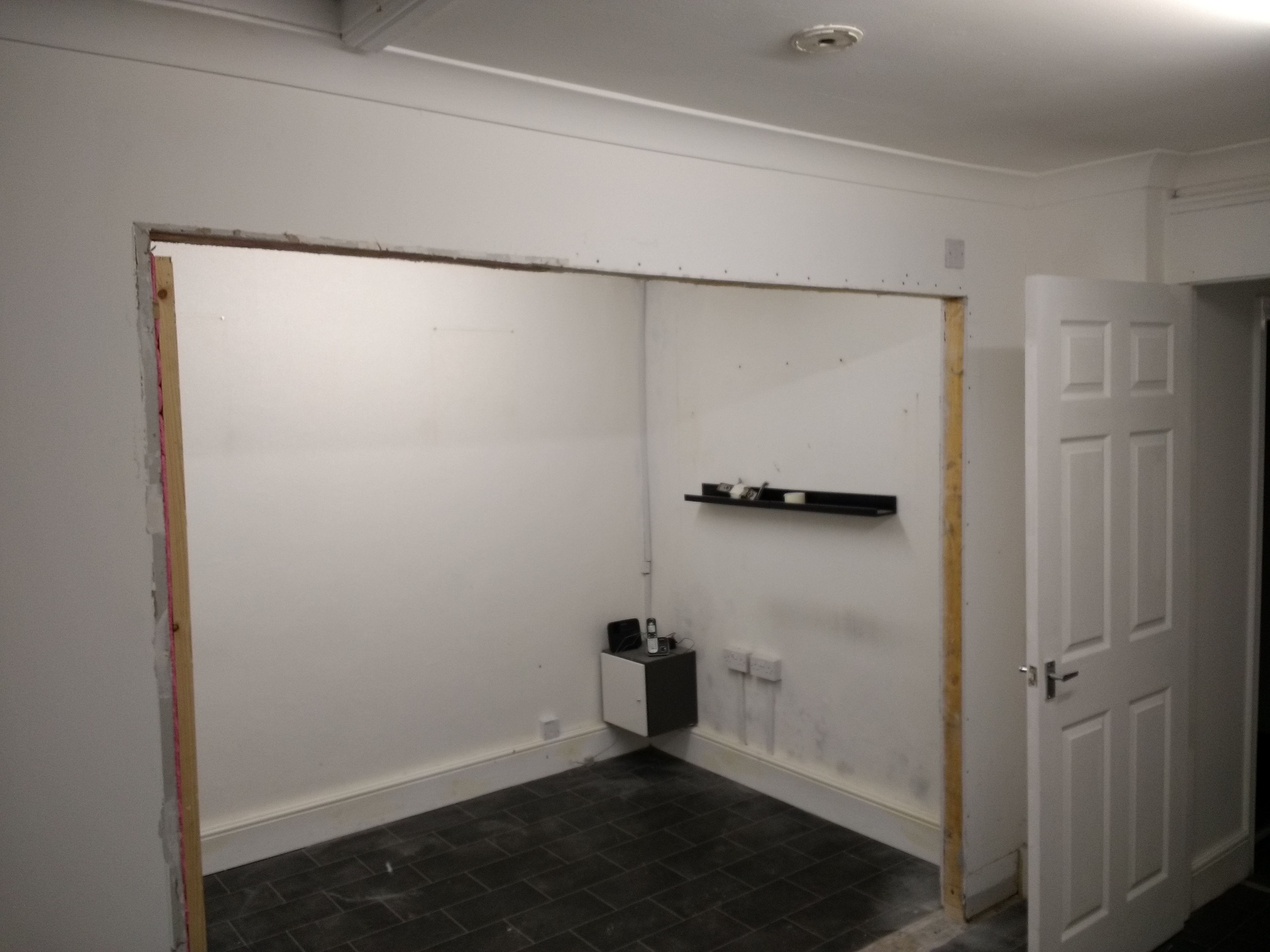

Tennentslager Posted December 4, 2017 Author Posted December 4, 2017 Decided it's beyond the curve for me as Div the super professional dope smoking plumber has a few free days next week ? Instead I knocked out a stud wall And decided (no windows) to put some mural wallpaper on the back wall, like this...60 quid.

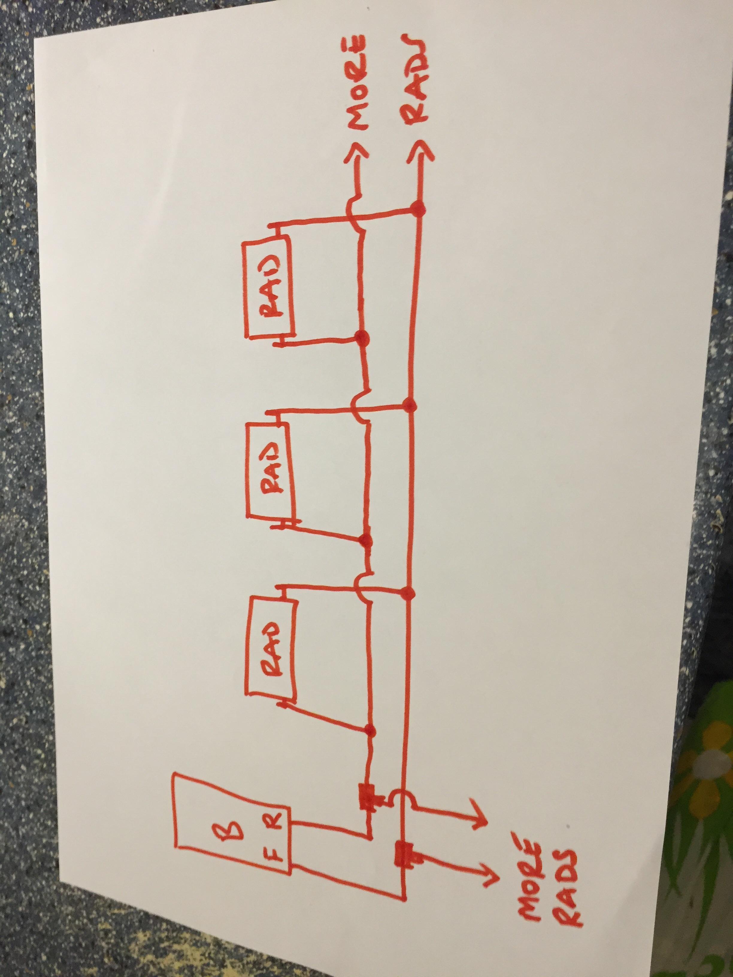

Tennentslager Posted December 23, 2017 Author Posted December 23, 2017 (edited) @Nickfromwales Can you see anything wrong with this? The two new radiators were added to the back shop and system repressurised but only the two rads on the right of the picture are heated? What have I done wrong? Prior to adding the two new rads all four in the front office were hot. Edited December 23, 2017 by Tennentslager
Nickfromwales Posted December 23, 2017 Posted December 23, 2017 Oh dear. . You may want to sit down. Youve piped it wrong my old pal. You'll need to redo it. You've got the rads in series and then you've teed across the series run to branch off. See above for correct parallel flow and return circuit connections. ?
Tennentslager Posted December 23, 2017 Author Posted December 23, 2017 I'll get some pics after the holidays @Nickfromwales I got a plumber ( dope smoking Dave) to do it but he's scratching his head at why it's not working. I think my drawing might be wrong and they are connected in parallel. He found the flow and return pipes in the loft and teed off these to the new radiators but as I say only two now have heat. Could it be anything about balancing or commissioning the system?
Nickfromwales Posted December 23, 2017 Posted December 23, 2017 17 minutes ago, Tennentslager said: I'll get some pics after the holidays @Nickfromwales I got a plumber ( dope smoking Dave) to do it but he's scratching his head at why it's not working. I think my drawing might be wrong and they are connected in parallel. He found the flow and return pipes in the loft and teed off these to the new radiators but as I say only two now have heat. Could it be anything about balancing or commissioning the system? Simple fix will be turn off the ones that work as their probably bypassing and stopping the pump from pushing the air locks out. . If there are no automatic air vents in the attic then there's your problem as air is getting trapped there.
Tennentslager Posted December 23, 2017 Author Posted December 23, 2017 31 minutes ago, Nickfromwales said: automatic air vents in the attic Nope none of them, do you fit on both flow and return at the highest point or only on the flow?
Nickfromwales Posted December 23, 2017 Posted December 23, 2017 1 hour ago, Tennentslager said: Nope none of them, do you fit on both flow and return at the highest point or only on the flow? Both pal. Trouble free motoring then. ? Have a good 400mm of pipe before the AAV to allow air to accumulate. 1
