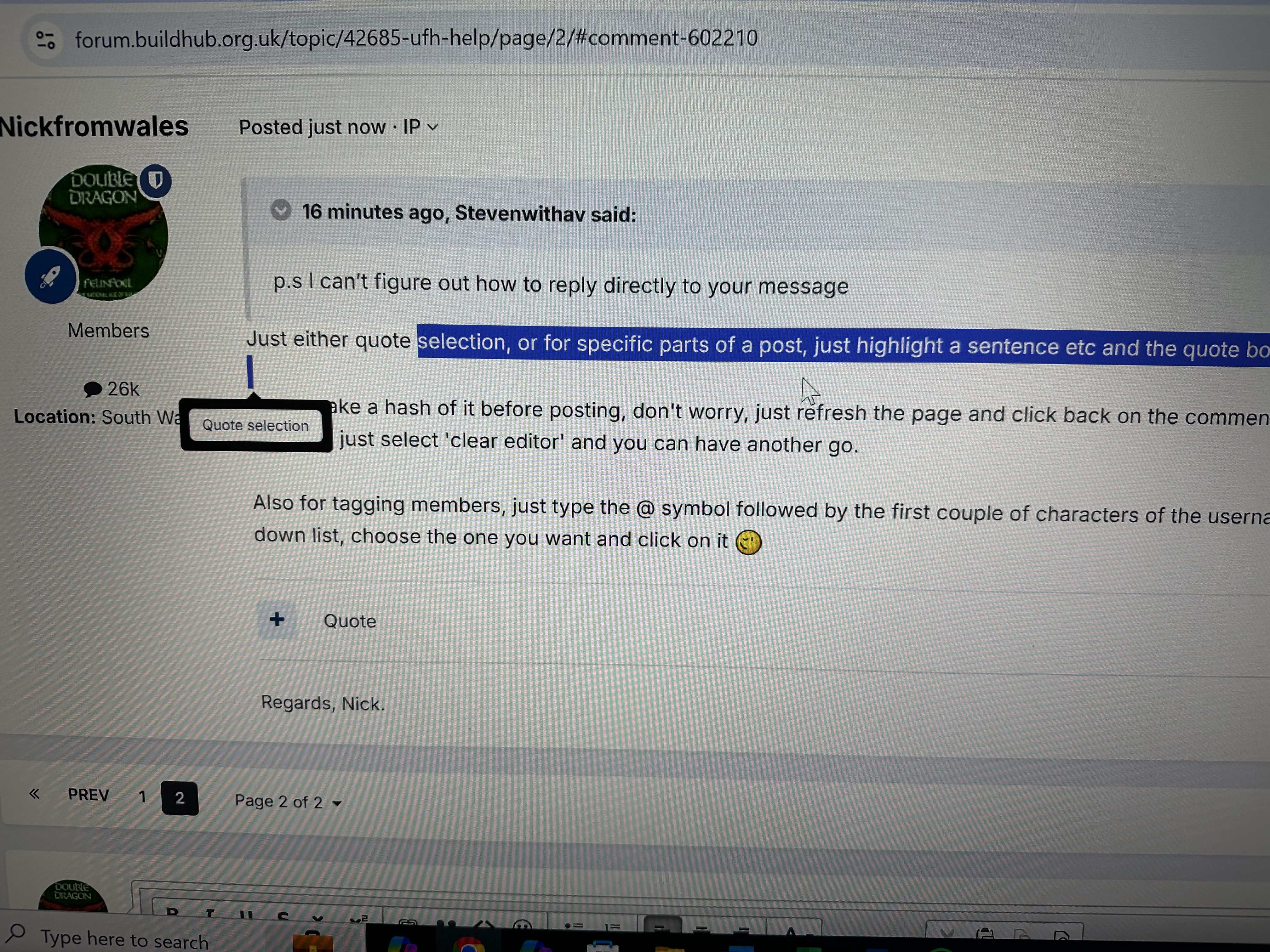

Stevenwithav Posted February 9, 2025 Author Posted February 9, 2025 NICKFROMWALES: Yes if the boiler is already on for the rads or the towel rails and I turn up the UFH thermostat then the hot water will circulate around the UFH, that’s the only way I have been using it, but the problem with that is the rads and towel rails are on timers to come on and off, so if it’s particularly cold and I want to warm the downstairs it just circulates cold water around! So I really need to be able to heat the UFH independently, PRODAVE: if the gray wire is linked to the 2-port valves and I turn up the UFH thermostat should that call for heat? p.s I can’t figure out how to reply directly to your message
Nickfromwales Posted February 9, 2025 Posted February 9, 2025 13 minutes ago, Stevenwithav said: p.s I can’t figure out how to reply directly to your message Just either quote selection, or for specific parts of a post, just highlight a sentence etc and the quote box will pop up, then click on it. If you make a hash of it before posting, don't worry, just refresh the page and click back on the comment box, your hash will reappear, then you just select 'clear editor' and you can have another go. Also for tagging members, just type the @ symbol followed by the first couple of characters of the username and there will be a drop down list, choose the one you want and click on it

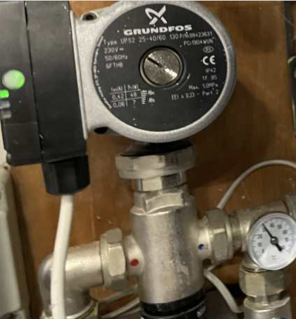

Stevenwithav Posted February 11, 2025 Author Posted February 11, 2025 @ProDaveI have attached the grey to the greys from the 2-port valves, I turned up the UFH thermostat and the pump kicked in and the boiler started up, so that’s working as I wanted, thank a million, but is there any issue that can come from it being like this, like one of the other fellas on this thread mentioned something about “short cycling” and it using a sh*t load of gas! Or is this set up how it should have been? (the grey wires went into this terminal block with the arrow)

Stevenwithav Posted February 11, 2025 Author Posted February 11, 2025 @ProDavealso the temperature on the pump shows 65 degrees, it used to be about 50, is that normal
JohnMo Posted February 11, 2025 Posted February 11, 2025 That temperature is way to high, turn you mixer flow temp down.
ProDave Posted February 11, 2025 Posted February 11, 2025 The knob on the bottom of this will adjust the temperature. Turn it down until the flow temperature gauge reads about 40. You will have to adjust it then wait a while for the water in the system to cool down, then adjust again.

Stevenwithav Posted February 14, 2025 Author Posted February 14, 2025 Good morning all, an update on this issue, it’s now working as I wanted so thank you all for your input, the only issue I now have is when the pump comes on it has that ringing sound (can be heard throughout the downstairs and the bedroom above) I’ve tried adjusting the flow but the only thing that stops it is if I turn the mixer up but that puts the temperature through the manifold to high, any thought on this, cheers
JohnMo Posted February 14, 2025 Posted February 14, 2025 1 minute ago, Stevenwithav said: any thought on this Back to my original post? Flow needed for UFH on its own is small with a mixer. In flow terms your trying to push an elephant through your front door. You are likely going to need to flow radiators and UFH at the same time. Or put your UFH on a secondary loop via a close coupled tee.
