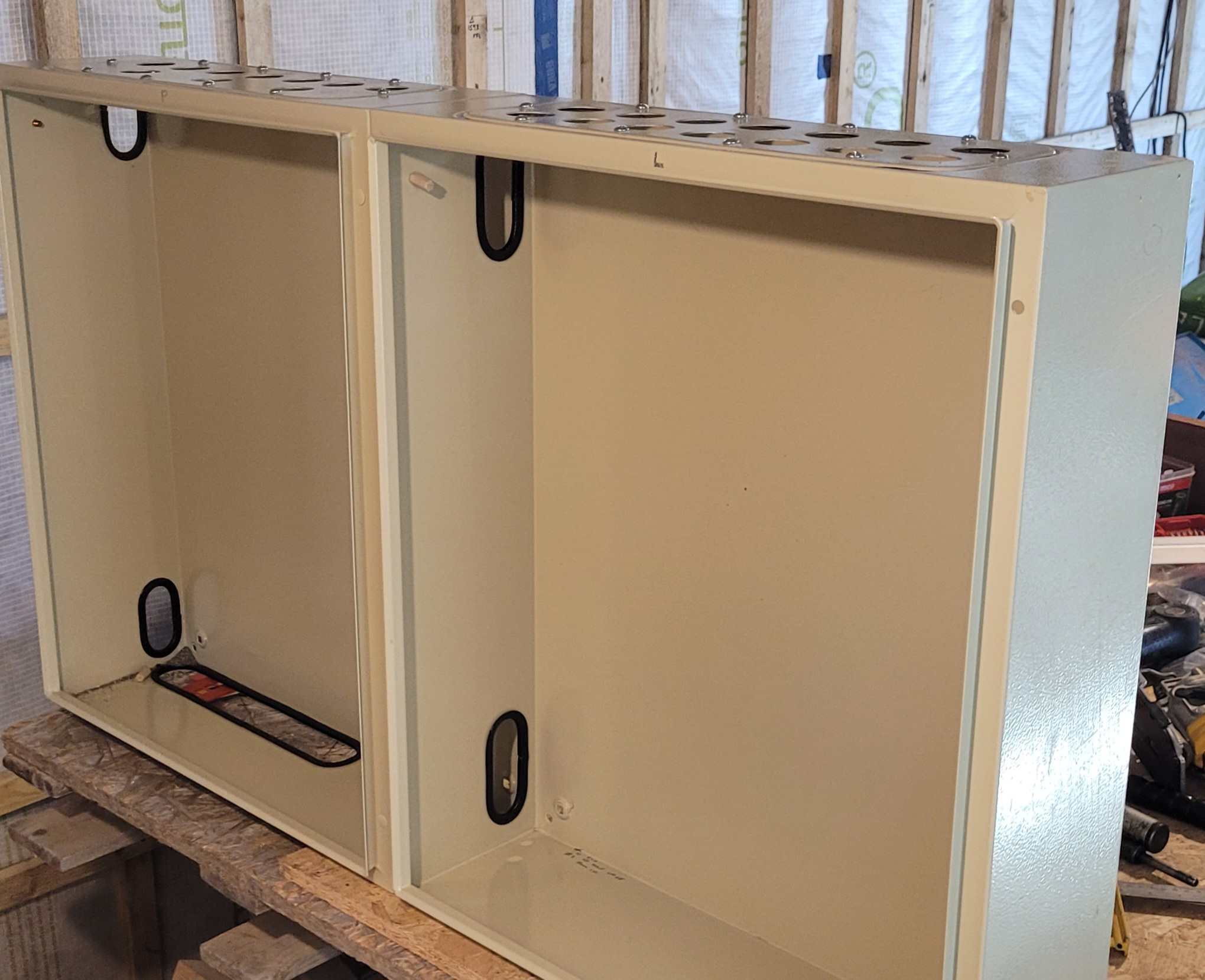

MikeSharp01 Posted February 6, 2025 Author Posted February 6, 2025 49 minutes ago, Thorfun said: i'm capable of doing what you are but wanted a system that had professional support if required in case i wasn't around. i also needed it to work without me tinkering with it so it's family and visitor friendly. hence the Loxone route. Makes perfect sense. I think provided I make it properly, no corners cut, use common building blocks, document it to within an inch of its life and don't demand any cloud connectivity I hope to be OK. I will also take our kids through it so they can help their mum if needs be. There should be room in the panels (2×600×700) to go proprietary if needed. 1
