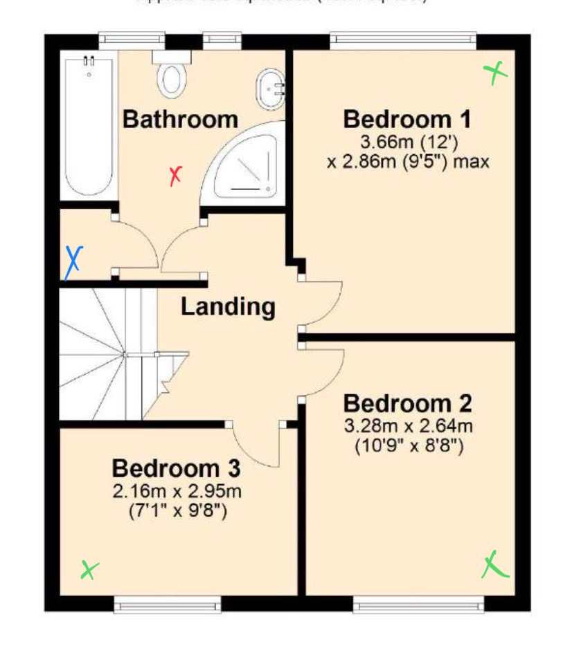

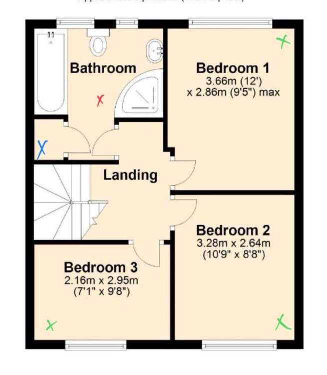

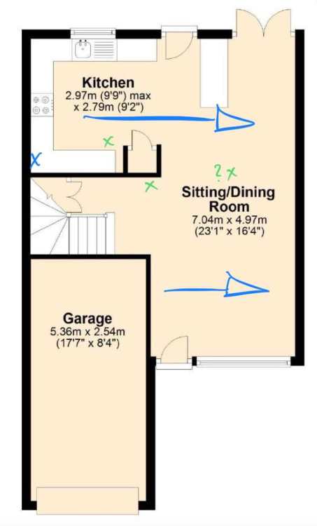

Can anyone help with a design for MVHR in my home?
I've attached a floor plan of both floors with 'x' where ducting could be fed to. Size of ducting for the first floor, can be what's suited as not restriction to size in the loft space, however on the ground floor I'm restricted to a max height of 75-100mm due to UFH already being installed between the first floor joists.
Location of the main unit could go in the loft against an external wall for venting in/out through there instead of the roof.
Thanks

What's the significance, if any, of the different coloured crosses?

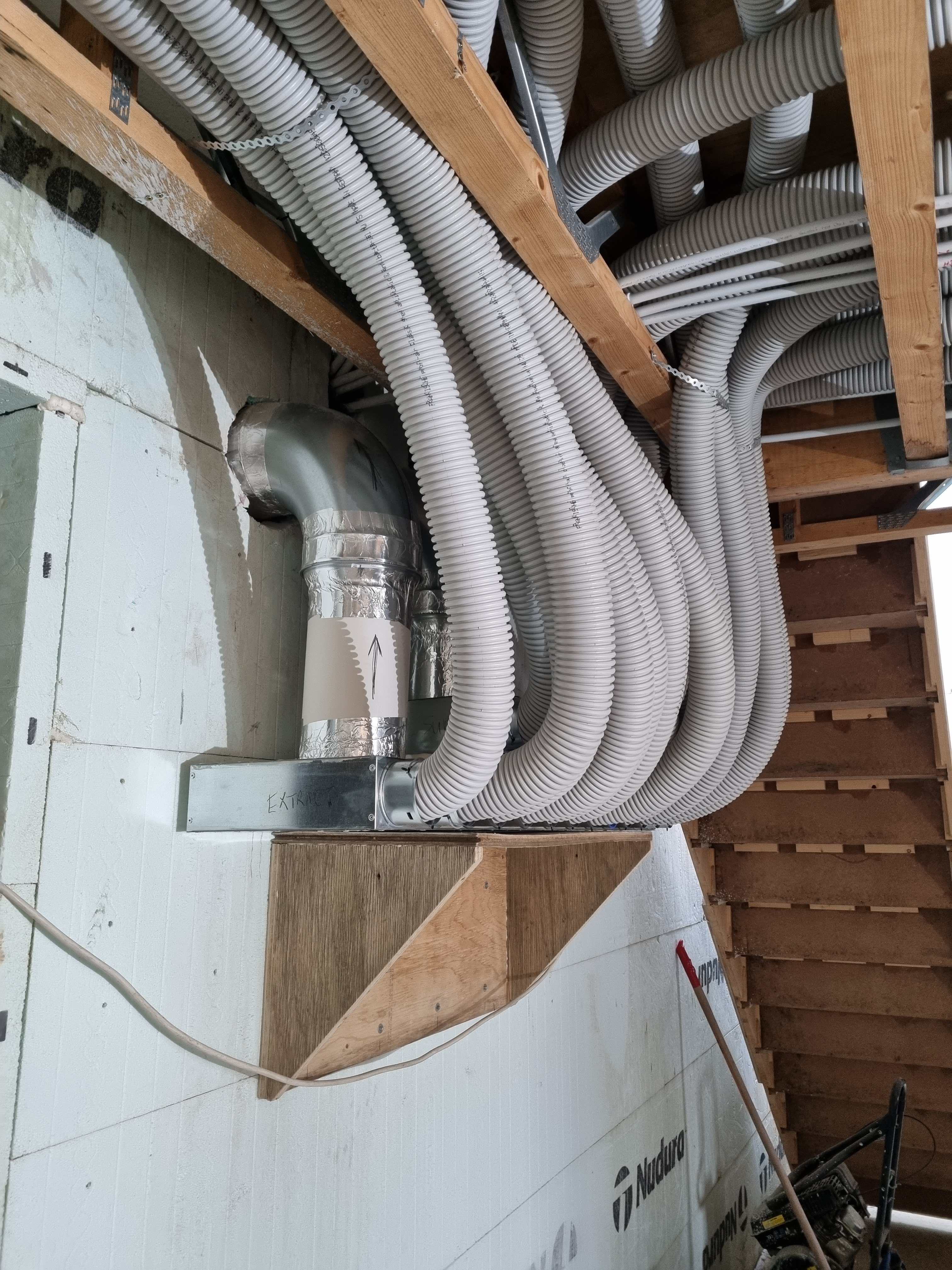

You could consider rigid ducting (125-200mm as required) from the loft to manifolds from which you run flexible ducts at 75mm diameter to the various vents. Obviously different manifolds for exhaust and supply.

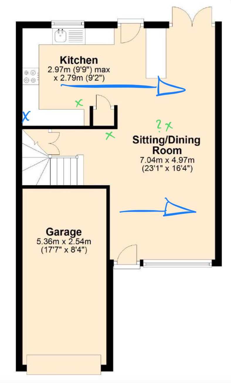

Apologies I should have been clearer.
in ground floor, floor plan;
blue ‘x’ is a small opening from ground floor through to the loft. It’s open at present as it’s where my flow and return for first floor UFH go up, along with h/w.
blue arrows are direction of joists.
green ‘x’ is location where a grille could definitely go.
green ‘x?’ is a possibility.
on first floor plan;
blue ‘x’ is the location of the gap from loft to ground floor.
red ‘x’ is where the bathroom grille would have to go. This is due to bathroom ceiling is solid surface and grooves for extractor already routered in.
green ‘x’ is where definite grilles could go, with no restrictions on duct size as that would be in loft.

house is 1970’s semi detached. Has 55-60mm cavities which have recently been filled with eps beads. Loft has 250–300mm insulation. New aluminium windows and doors, all installed with me508 membrane, air seal foam, compriband.
ufh is at 135mm centres and sits on 100mm PIR and covered with 25-30mm dry screed. On top of this is t&g boards and aside from the bathroom this is topped with thermal stream underlay and a low tog carpet (total tog 1.8). In the bathroom 6mm hardie is on top of the t&g boards, then ditra mat, then tiles.
What type of joists do you have? Solid, i-joist, web joist (asin picture above)?
Do you have open  access to the joists still or will you have to remove plasterboard etc. to fit the ducting? The former we all hope
Joists are solid.
i will have access from the ground floor as existing plasterboard all coming down.
so currently due to the floor build up for the first floor UFH I have approx 75mm space left, however I could increase this to 100mm with some baton.
I would do a simple cascade system, with supply ducts to bedrooms only. No need to supply to dining lounge, as air would overflow from bedrooms to stairs and down to kitchen.  Extract will be kitchen and bathroom only.
Supply rates
bed 1 and 2 say 35m³h and bed 3 25m³h. So total supply is 95m³h. If you need more flow up the flow rates slightly.
Extract rates
Kitchen would extract 50 and bathroom 45m³h.
45m³h of the supplied air would be taken by bathroom, the rest would go down the stairs wash through the living room and out of the kitchen extract.
Whole house would be be fully ventilated. Only one easy run duct is needed. Do the ducts in 90mm and run 2 to the kitchen to a 2x90mm x 125mm plenum.

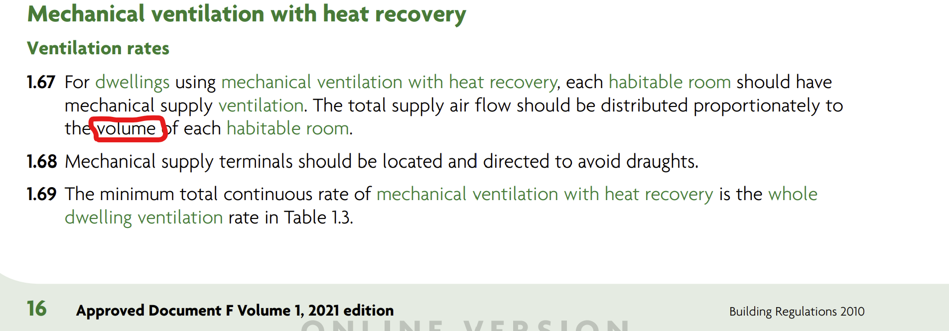

Out of interest, how would this pass building regs, if replacing all windows and for new without trickle vents, and generally improving airtightness?

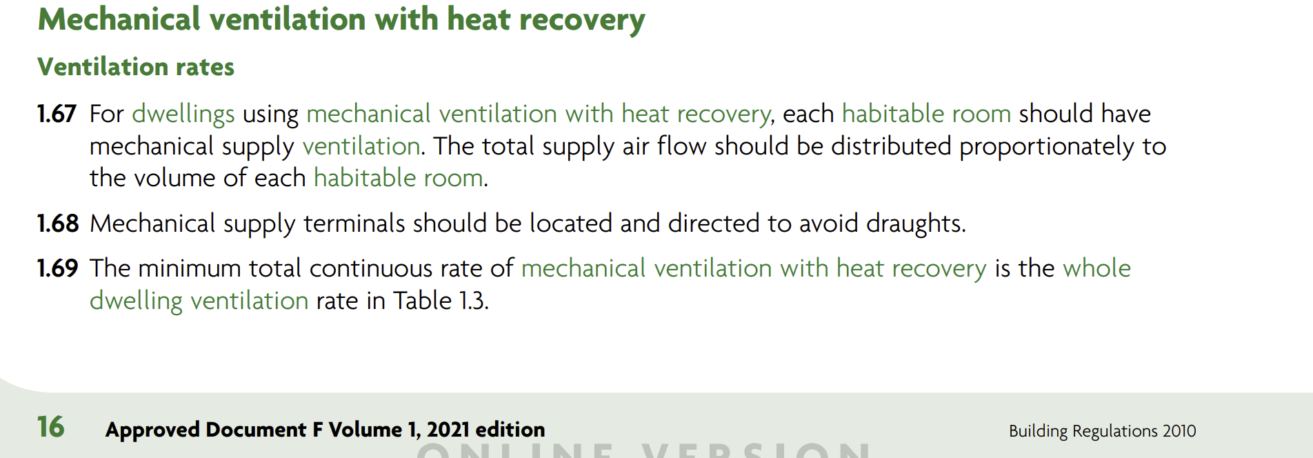

My reading of part F is, in this scenario (a "cat B" retrofit with MVHR) every habitable room needs to demonstrate it has sufficient supply ventilation distributed proportionally to the volume of said room. To me, without putting a supply vent in the living room and balancing it, that's a very tricky requirement to demonstrate compliance with. (of course, it's unlikely any BI will care, but that's a very different conversation)
38 minutes ago, JohnMo said:
English regs are based on floor area,
Again my reading of part F is it cares about volumes not floor area for MVHR:
Have you attached the correct document, nothing mentioned volume.
You can demonstrate via "through flow". The alternative is to under ventilation of bedrooms. You can demonstrate exactly the same way as PIV system.

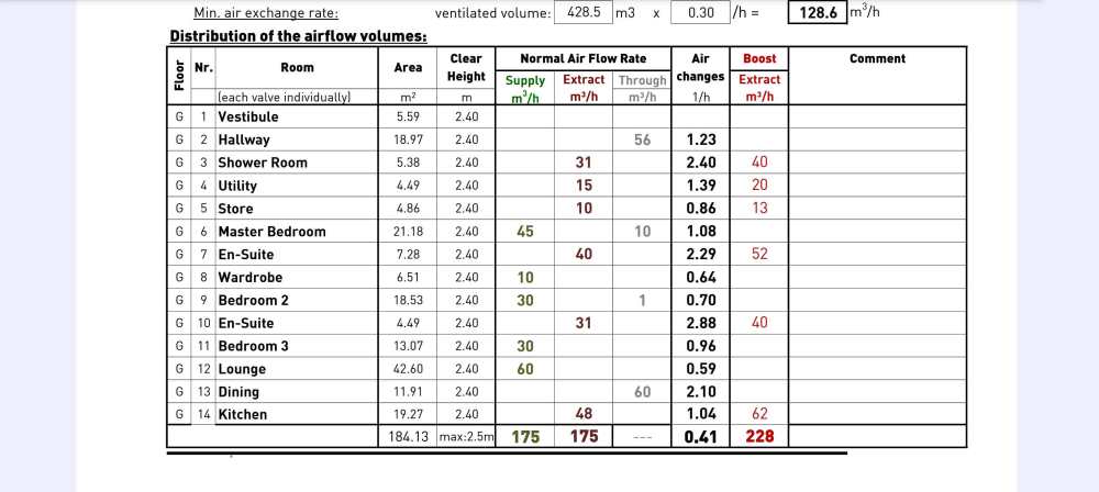

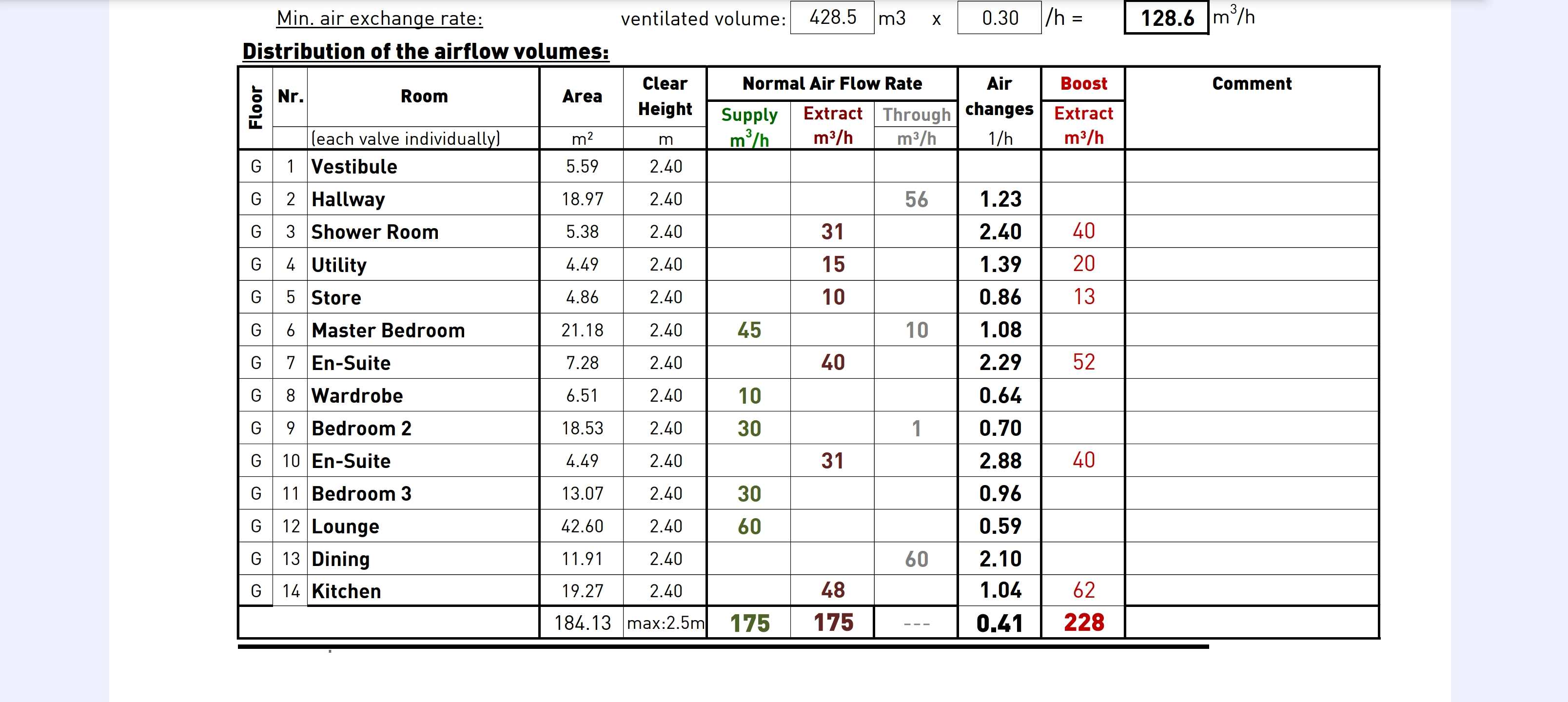

This is a design done for my  house per building regs, by Paul Heat Recovery.
Notice the volume Though m³/h column.

42 minutes ago, JohnMo said:
Same document, with the word Volume highlighted
Thank you - that makes sense. Turn the "common sense" argument into a balance of flows on a spreadsheet. Makes a lot of sense for open plan areas especially.
But only say distributing the flow proportionally by volume. The volume flow is generally 0.3l/s per m² or how many people wet rooms etc which ever the greatest.

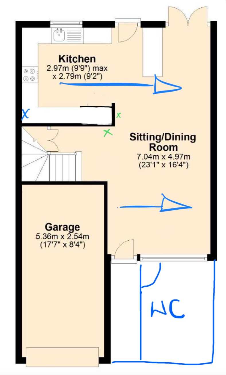

If the supply vents could come out of the wall I could run a duct beneath the ceiling (above the wall units), from the blue x on the ground floor and in the direction of the joists. Attached an image to make it clearer. Green x would be the supply vents.
As for an extract vent by the sink (reply by @Marko), I possibly could get a vent beneath ceiling and above the wall units/extractor, then come up into the ceiling and over to the sink, but would depend on the height needed within the ceiling void for the extract vent.
Don't think I'll be able to get a extract vent to the WC on the GF so maybe just go for a standalone unit in there.
