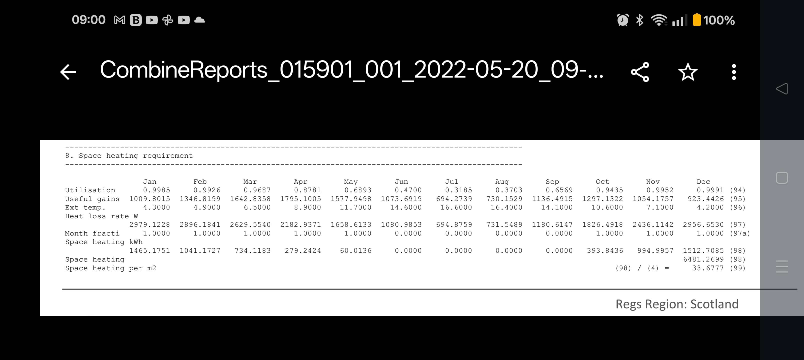

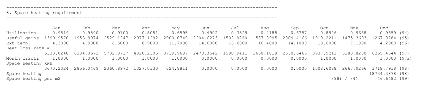

JohnMo Posted February 3, 2025 Posted February 3, 2025 54 minutes ago, deuce22 said: I have had a quick look at my SAP report. Where would I find the info I need? I'll pass some of your advice on to the HE. Thanks. Look at as built or as designed space heat required section. Depending on how accurate your sap is, depends how good the figure is. 4th line down - heat loss rate W. Look for the most onerous month. So that is your ball park heat loss rate.
deuce22 Posted February 3, 2025 Author Posted February 3, 2025 12 minutes ago, JohnMo said: Look at as built or as designed space heat required section. Depending on how accurate your sap is, depends how good the figure is. 4th line down - heat loss rate W. Look for the most onerous month. So that is your ball park heat loss rate. This is what I've got. I've just contacted them, but they don't know how to calculated the boiler size from the figures shown.
JohnMo Posted February 3, 2025 Posted February 3, 2025 So you just need a dinky gas boiler. 7 minutes ago, deuce22 said: I've just contacted them, but they don't know how to calculated the boiler size from the figures shown. Find a new plumber. They are just sticking a finger in air and having guess. The difference in a good install and poor one is using twice the gas.
deuce22 Posted February 3, 2025 Author Posted February 3, 2025 Sorry, I didn't mean I contacted the plumber, I contacted the company that did the SAP calculations. Is there not a way for me to work out what boiler size I need from these monthly/yearly heat loss figures. I just want to know that the correct boiler is being installed. I know I should trust the HE, but I feel like I need to keep on top of every trade, with the eperience I've had since starting this project.
JohnMo Posted February 3, 2025 Posted February 3, 2025 Heat loss rate W is the heat loss. You need a boiler that can provide that to heat the house, worst case. Allow some time for DHW heating you are still only needing less than 7kW. But realistically you will be in the 11 to 20kW range of boilers. It's just important that you get one with a good modulation, if it can go down to about 3kW you will have a good stable operation all year, running a simple WC curve. So you just need the following Boiler (that does PDHW and weather compensation) Get a heat pump cylinder with 3m² heating coil Diverter valve. Ideally size radiators for the same temperature as the UFH (you can then run the whole system from the system boiler circulation pump all at the same temperature. (no UFH mixer or pump needed) A controller from the boiler manufacturer. Run all as a single zone, with trvs on the bedroom radiators only. Your system is then heat pump ready also. But will make the most out of the gas boiler.
