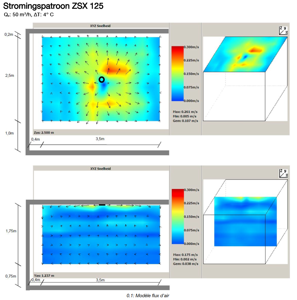

11 hours ago, Nickfromwales said:
The projectile effect, a benefit from the Coanda ethos is a bit OTT here, usually reserved for long throw instances like commercial and public open spaces with vents on the vertical facades vs a small ish residential dwelling ;)
Wall-mounted Coanda effect vents are indeed very useful to protect supply air across large spaces.
However domestic ceiling mounted Coanda-effect vents have the opposite effect and a different benefit. They're intended to mix the supply air (which will be a few °C colder than the room temperature in winter), with the room air, while the airspeed drops, the two effects combining together to avoid cool drafts. Here's an example in a domestic-sized room using the Zehnder ZSX 125 Coanda-effect diffuser; the colours show airspeed, but if you mentally swap them round (so blue = warmer & yellow = cooler) that would be more-or-less the temperature distribution.
In a small room, especially a bedroom, where you can't avoid having a vent near a bed, that can be pretty useful.

Is this actually going to happen with trickle rates? Reasonable to think this would be more relevant when boosting, eg perhaps a good consideration for instances where running the fan speeds up during summer helps attain Part O compliance.

As you turn down the airflow on a Coanda-effect diffusers the mixing-distance will certainly decrease; no doubt there's a formula out there for that. If you turn down the airflow on a regular diffuser the air will increasingly tend to fall vertically (if it wasn't already being pointing straight down) as cooler air is denser, and you wouldn't want that over (or close-to) a bedhead, for example.
