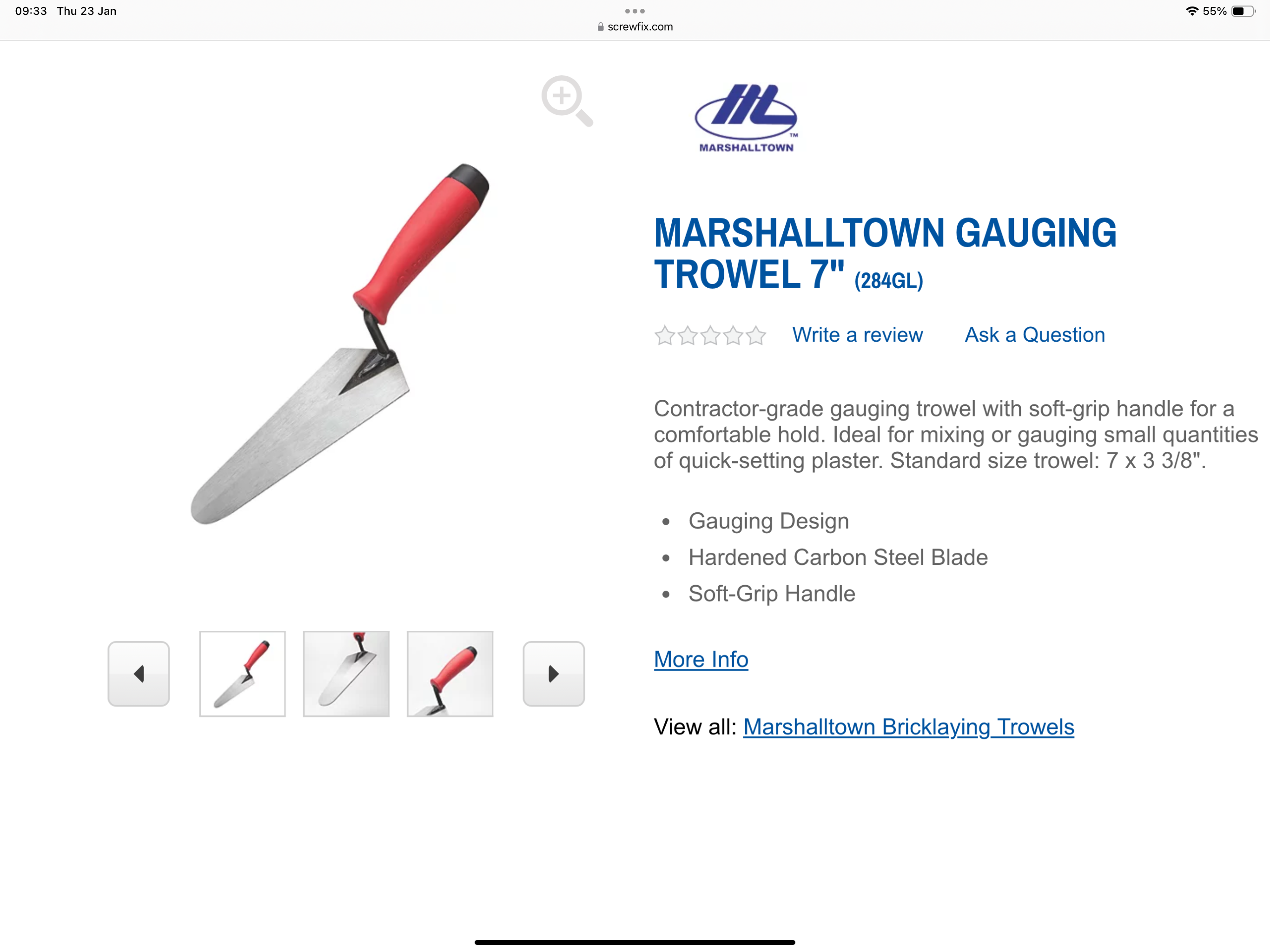

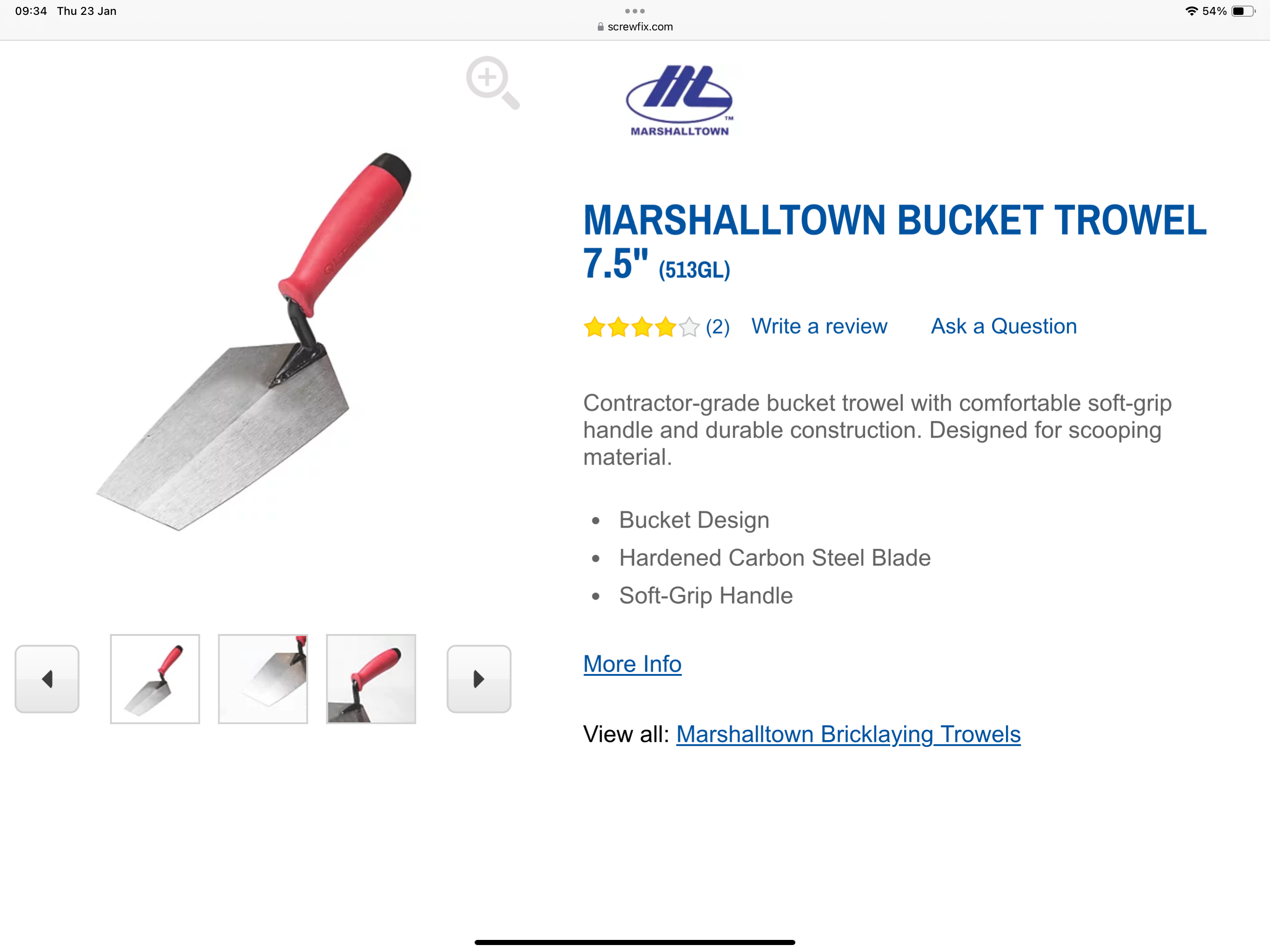

crispy_wafer Posted yesterday at 09:29 Share Posted yesterday at 09:29 Simple really, what's the best/easiest trowel to use to get the muck from the bucket onto the wall? Had a go with a plasterers/finishing trowel and hawk which is all I have and while I managed to get adhesive on the wall I struggled with consistency in size of the dabs... I mean the finished result was fine, just felt a harder job than it ought to be. Could be this apprentices cack handed technique too! Many Thanks Marek Link to comment Share on other sites More sharing options...
Nickfromwales Posted yesterday at 09:35 Share Posted yesterday at 09:35 A bucket trowel is my weapon of choice, plus also a gauger for smaller areas that require a bit of control. 1 Link to comment Share on other sites More sharing options...
