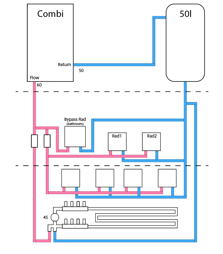

Super_Paulie Posted January 15, 2025 Author Posted January 15, 2025 (edited) really appreciate all this help guys, its helping me understand this all a bit better. The numbers give me brain struggles so its very much appreciated. I have re-drawn my system to maybe show a bit more of the reality. Looking at it as you say, 60 (65) down to 50 once the UFH is away is a big old drop for what should just be a bypass. I do get some, what i thought was, reverse circulation in the rads marked Rad1 and Rad2 in the attached image. Would that combined with the bypass rad in the bathroom account for the loss? To test this should i lock off the 2 rads and see if the return temperature increases? As it is my boiler burner is essentially "never off", and is only off when it flames out at the temp +5 for the anticycling time of 3minutes. I kinda expected the return to get so high that the boiler stops the flame but then continues to pump while being fed from the buffer for however long it takes, not just being off for a pre-determined flame off due to anti-cycle. Probably totally miss-read the situation there. Edited January 15, 2025 by Super_Paulie
marshian Posted January 15, 2025 Posted January 15, 2025 Oh that's odd - I would have expected the volumiser to be on the hot side of the boiler not the cold side but I guess it doesn't matter

Super_Paulie Posted January 15, 2025 Author Posted January 15, 2025 (edited) I've likely misunderstood what I've been trying to achieve here. In fact, I'm not even sure what that is at this stage. I guess my tank just creates volume and not a lot else. So tonight I ran a few tests. I locked off both upstairs rads which get a slight reverse circulation I think as they warm slightly when the UF is running. Ive been using a probe on the return under the boiler to read that but instead I'm going off what it shows on screen when it's not firing and that is surely the return temp. I went with: Boiler 60, mixer 45. Bypass rad (tiny thing, shown above) 3/4 open. So it now fires for 9 minutes as it creeps 60+5. Flames out with a 3 minute anti cycle and the return temp drops to 52 at the tank but shows 56 on screen. It then fires back up and repeat, which I guess is a cycle time of 12 minutes. So guys, ultimately what is my goal here, I'm not entirely sure anymore. Keep the boiler firing for as long as possible until it reaches overtemp and flames out? For what it's worth, it's toasty warm in here at 22/23° and it's cost me £2.50. Edited January 15, 2025 by Super_Paulie

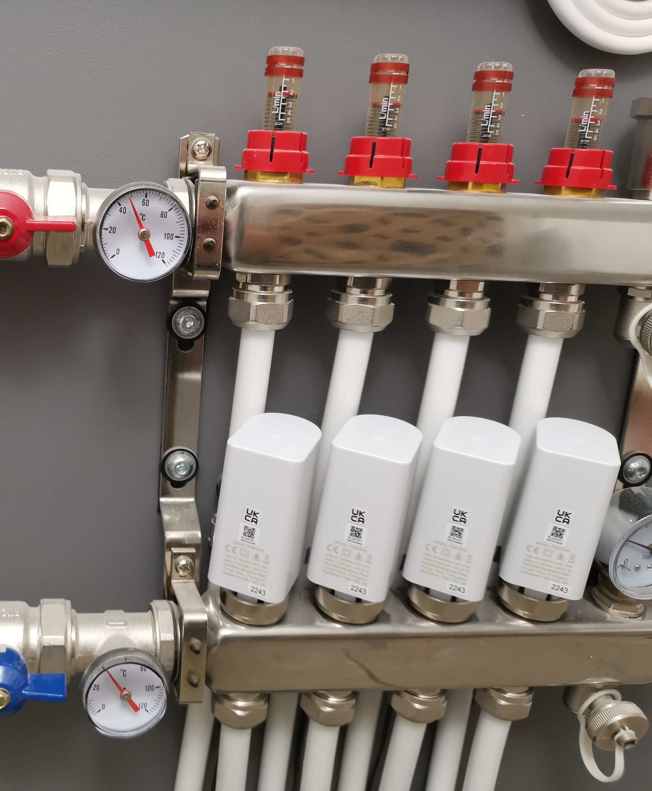

Super_Paulie Posted January 15, 2025 Author Posted January 15, 2025 14 minutes ago, marshian said: But you said you set it to 60 flow and at 56 return it fired up? Ah, gotcha. Ok so maybe my probe is a better indication rather than what is on screen. 10 minutes ago, John Carroll said: Can you go to the UFH manifold and read off the flowrates from each loop as accurately as possible from the flow meters ("glass tubes") and also the manifold flow & return temperatures when the boiler has been firing for say 5/7 minutes, also note the boiler flow & return temperatures. I'll have to do that tomorrow as the missus is back in, boiler in loft, manifold ground floor. I've sat looking at the manifold the last 10 minutes and to be honest the needles barely move at all, maybe a degree or do. All flow rates are 2.5, ish, balanced with Salus. Yeah the smart meter was £2.50 so it's not going to be much higher by the time it goes to it's set back at 11, and 30p of that is the standing charge. It'll stay 20+ in here all evening no doubt.

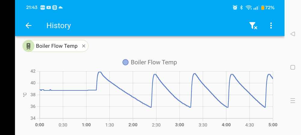

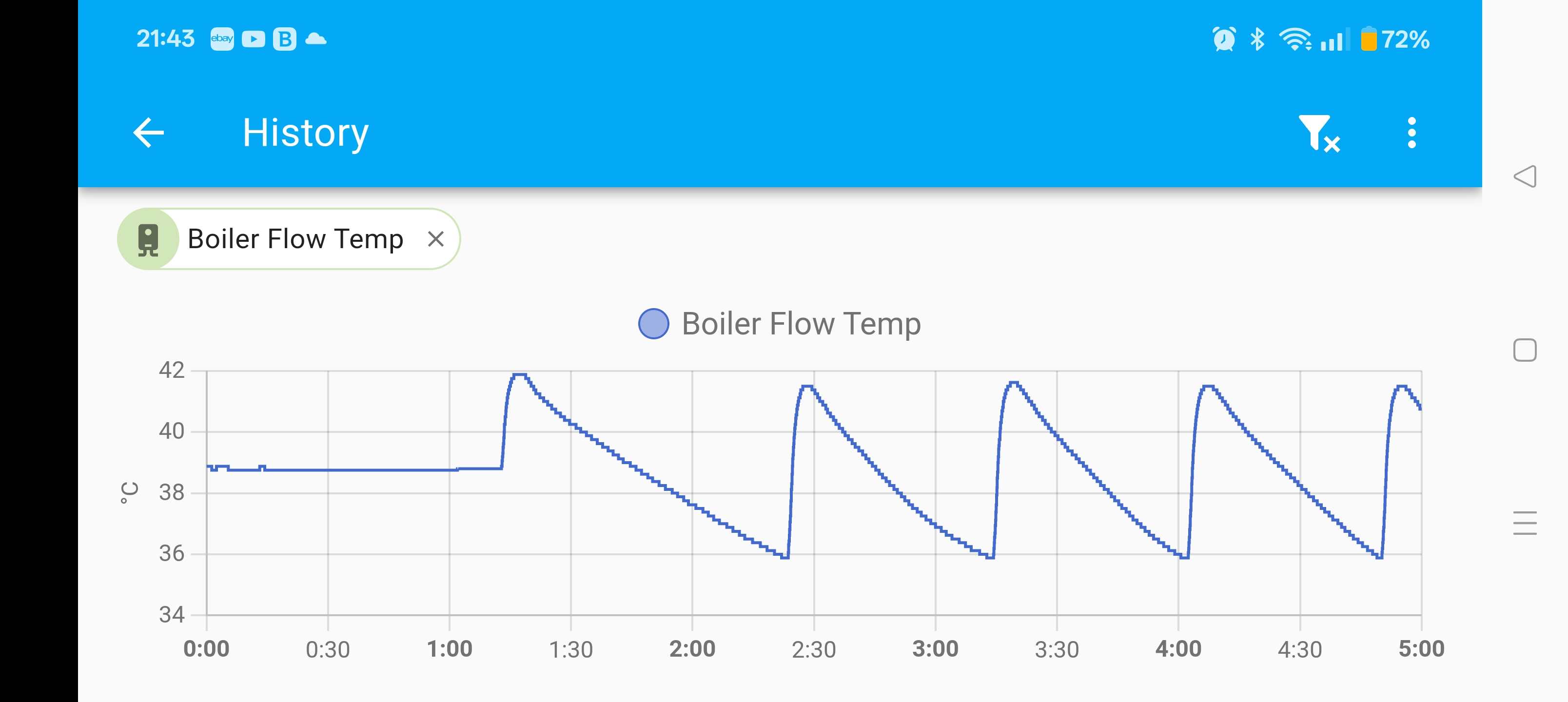

JohnMo Posted January 15, 2025 Posted January 15, 2025 A couple of images. The first is the boiler firing in a small loop and not getting to the heating system. When in normal running the flow temp is 38.5. at about 1.15 a pump stopped, flow temp increases 5 degs, then refires at 30. No setting changes but normal running, against a full open heating system. Second image a few hours previous to above. Restart is 26 degs. So I suspect your engaged heating system is just to small to move the heat away. The mixer is just pushing most of the water straight back into the boiler.
marshian Posted January 15, 2025 Posted January 15, 2025 2 minutes ago, Super_Paulie said: Ah, gotcha. Ok so maybe my probe is a better indication rather than what is on screen. Yeah it may well be but the boiler is reacting to the temperature it gets from the internal sensor.........
Super_Paulie Posted January 15, 2025 Author Posted January 15, 2025 8 minutes ago, JohnMo said: A couple of images. The first is the boiler firing in a small loop and not getting to the heating system. When in normal running the flow temp is 38.5. at about 1.15 a pump stopped, flow temp increases 5 degs, then refires at 30. No setting changes but normal running, against a full open heating system. Second image a few hours previous to above. Restart is 26 degs. So I suspect your engaged heating system is just to small to move the heat away. The mixer is just pushing most of the water straight back into the boiler. That's interesting, thanks for that. So volume is the thing, I could probably increase that with an additional rad say in the hall plumbed in before the 2 ports. But what advantage would I gain from this increased volume, longer cycle time?
John Carroll Posted January 15, 2025 Posted January 15, 2025 25 minutes ago, Super_Paulie said: Ah, gotcha. Ok so maybe my probe is a better indication rather than what is on screen. I'll have to do that tomorrow as the missus is back in, boiler in loft, manifold ground floor. I've sat looking at the manifold the last 10 minutes and to be honest the needles barely move at all, maybe a degree or do. All flow rates are 2.5, ish, balanced with Salus. Yeah the smart meter was £2.50 so it's not going to be much higher by the time it goes to it's set back at 11, and 30p of that is the standing charge. It'll stay 20+ in here all evening no doubt. Cant see the bottom (return) gauge properly but if its the same as the top one (scale wise) then maybe reading 40/42C ish? so ~ 7C dT, fairly normal, so UFH output 2.5*4*60*(48-41)/860, 4.88kw?, or there abouts.
Super_Paulie Posted January 15, 2025 Author Posted January 15, 2025 15 minutes ago, John Carroll said: Cant see the bottom (return) gauge properly but if its the same as the top one (scale wise) then maybe reading 40/42C ish? so ~ 7C dT, fairly normal, so UFH output 2.5*4*60*(48-41)/860, 4.88kw?, or there abouts. Yeah it's dead on 7 lower, the actuators see to that and seemingly work a treat.
