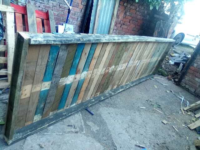

lord mud of the flyes Posted January 13 Posted January 13 Hell there Would like to make a bar like this so it looks as neat and cheap as possible Thinking of using old pallets for the side of the bar. But not sure how to get the nails out of the pallets so it dose not split the timber, and what paint I should use? What kind of wood and paint do you think I should use for the work top? And same question again for the skirting boards? I all ready have some old fence post wood that I am considering using for the frame. But I am unsure of how to attach all of the above to the frame as nails and screws would look so tack? Any advice please? Thanks
Redbeard Posted January 13 Posted January 13 (edited) @Onoff, excellent. Seems to me, OP, that you'll only maybe need 1 row of 'visible' fixings in the middle of the height of the pallet-wood, since the top and bottom 'skirtings' can trap the rest. I would use oval nails, punch below the surface of the wood and use coloured filler to hide the punch-marks. The likely 'mottling' of the pallet-wood will probably help to hide them too. Edit: Make sure to 'acclimatise' the pallet-wood to its intended environment before you commit to any fixings. Edited January 13 by Redbeard
ToughButterCup Posted January 13 Posted January 13 (edited) 2 hours ago, lord mud of the flyes said: ... What kind of wood and paint do you think I should use for the work top? [...] the skirting boards? I all ready have some old fence post wood that I am considering using for the frame. But I am unsure of how to attach all of the above to the frame as nails and screws would look so tack? ... What you have the same theres your answer to the two points above who (other than you) is going to notice them when they are in the wood? Edited January 13 by ToughButterCup

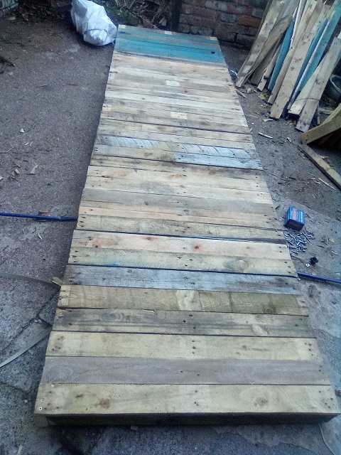

lord mud of the flyes Posted April 7 Author Posted April 7 So I finally found some pallets and put them together What do you think of it so far?
Onoff Posted April 7 Posted April 7 2 minutes ago, lord mud of the flyes said: So I finally found some pallets and put them together What do you think of it so far? Yes, it looks like pallets stuck together. Looks like you've achieved your aim of as cheap as possible. Cheaper still would have been to have reused the salvaged nails from dismantling. & You said the pictures I posted up looked tacky! 😂 1 1
Nickfromwales Posted April 7 Posted April 7 I am desperately trying to think of something good to say about it...... Bear with..... Nope, I'm all out soz. 1 1
Onoff Posted April 7 Posted April 7 19 minutes ago, Nickfromwales said: I am desperately trying to think of something good to say about it...... Bear with..... Nope, I'm all out soz. Beer with might help... 1
lord mud of the flyes Posted April 8 Author Posted April 8 After I have sanded them down, I am wondering what to paint them with to make them look like the bar for sale at the top of the page And what kind of skirting board and counter top I can buy to make it look the same? Thanks
Nickfromwales Posted April 8 Posted April 8 Probably a stain of some sort. I’d avoid any sheen, so a Matt or satin would probably resonate with the ‘vibe’ you’re trying to create with raw materials, methinks. Clear (varnish) would likely be a bit too honest, so sample a couple of shades on off cuts and see what appeals to you. 👍
Onoff Posted April 9 Posted April 9 The skirting and bar top will just be more pallet wood suitably sanded and stained / varnished.
