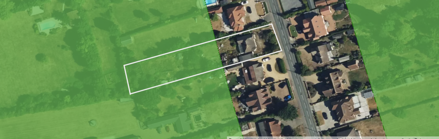

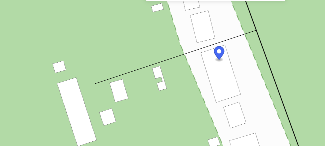

DevilDamo Posted January 12 Posted January 12 Can you upload a plan which shows the relationship of the GB boundary to your property and site?
Jack757 Posted January 12 Author Posted January 12 This gives you a bit of an idea from the property just along the road...

DevilDamo Posted January 12 Posted January 12 @Jack757 So your “site” is within the Green Belt and any development within the site will be assessed against its impact on the Green Belt. Back to your original question and as I have already mentioned, it’s always advisable to implement PD works first. And also as mentioned, that “could” go against you for the Full application. Unless your Architect is competent in doing so, speak to and seek advice from a Planning Consultant. They can also prepare a Supporting Statement to accompany the Full application. And btw, the LPA would need very good reasons to withdraw all PD rights, even those that relate to Class E. Especially if like you say the replacement dwelling is similar to the existing. Unless you did mean the new footprint will be similar but there will be increased bulk and volume?
