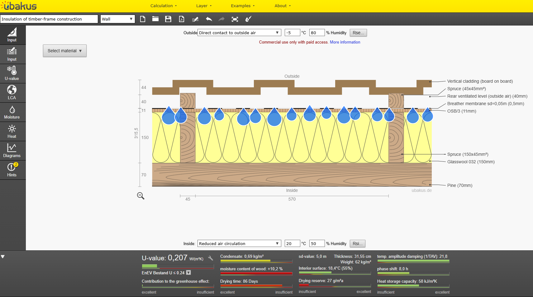

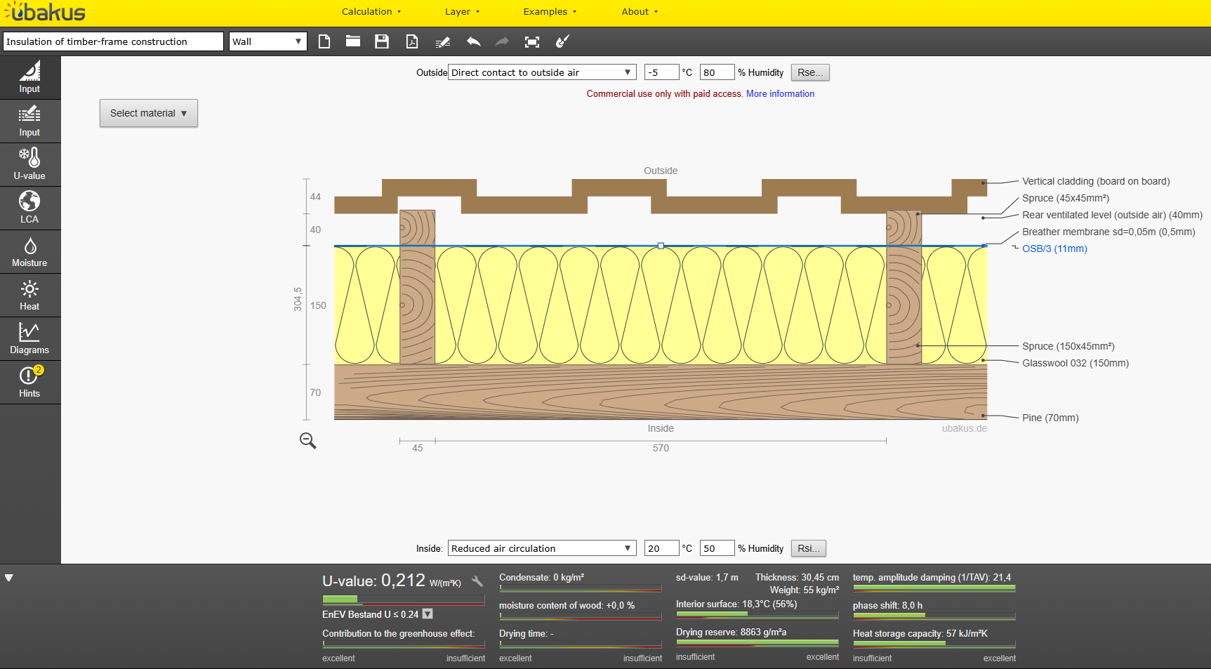

Been looking at how best to go about cladding and insulating externally with current thinking as follows, Build a new 6x2m frame filled with 140mm thick roll of Frametherm 32. Counterbatten the frame and clad with vertical board on board cladding. I popped this all into Ubakus (which I clearly don't understand) and all looked fine until the OSB layer was added. TBH I'm not 100% if this is needed but if it is, Can anyone explain what I'm seeing with the Moisture issue?
From what I've read the OSB sheathing gives the frame its strength, That said my frame will not be supporting a floor or roof, Just the insulation and cladding. Would I need this?
Thanks
So many builds i look at use OSB so I've either done something wrong with my Ubakus selections (likely) or the analysis is wonky. I tried a few of their other OSB options as well as ply and MDF. The only option that removes the moisture issue is MDF 500kg/m3
