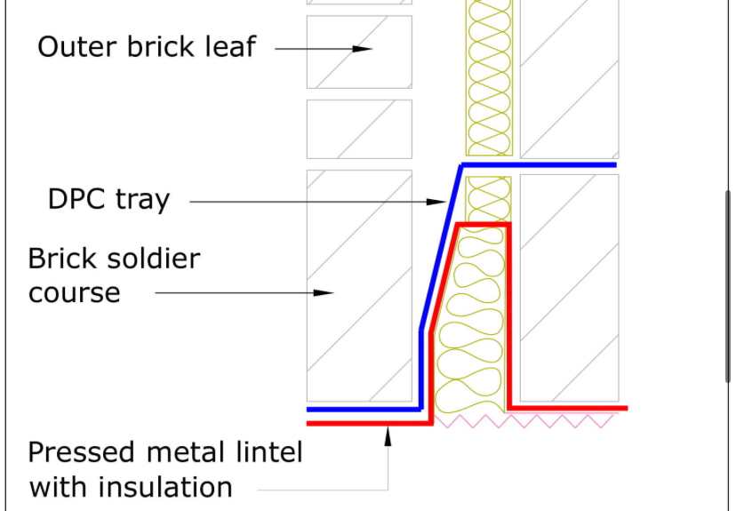

Detached house build - I'm wanting to check, how wind driven rain will leave the cavity once it comes in through the facing bricks if outside finished ground level is 300mm higher than the bottom of the cavity. If the cavity fills by 75mm, it will breach the DPC under the beams. Ground is all clay soil and poor drainage until land drains are completed. Render doesn't let water in but bricks can be quite a lot.
I have my beam and block floor in and next stage is to complete the partial fill cavity walls up to DPC level. It's ready for outer leaf block & 3 course of Staffordshire blues, then I can get the outside to finished ground level, some drains in, stoned up clean ready for builder and scaffold.
My plans were very generic for the DPC area, a few versions had been sent and none were suitable for B&B. I've attached a sketch of the buildup I decided to go with.

A stepped DPC in the cavity directing any water back out through weep vents won't work because it would divide the PIR insulation.
I'm aware that angled cavity trays need positioned over the telescopic vents. Would it be advisable to fit Type E horizontal cavity trays at outside DPC level right around except under window openings, some like the image? I calculate 40 required at 900mm, £280. Might seem like over thinking but where else can the water go. It doesn't move on site summer or winter.
A cavity tray isn’t really installed as per the drawing-it would come out across the top of a PIR sheet & then down to the outer leaf. Some people chamfer that sheet below to ensure a fall away from the inner leaf,which isn’t great thermally but probably preferable to any moisture finding itself trapped on a minute rise in the DPC tray.

When you say come out across the top of a PIR sheet, do you mean a DPC roll as a Z shape so it's bedded into the inner and outer cavity walls and spans as far as you roll it out?
I agree, trying to split PIR at obscure angles would be terrible. I'm also using T&G PIR and taping joints so thought the plastic Type E or type G might be a way to divert any rain water back out if they have a profile thats the width of a facing brick then the back lip can angle up and rest on the outer face of the PIR.

Ignore the lintol shown-typical installation is more like this.
A cavity tray is usually installed around the perimeter at around 150mm above ground level,this is a pretty standard detail now.

@Brickie So it is recommended that I include this stepped DPC around the house perimeter from the outer leaf DPC level (on top of telescopic vent) which is 150mm above ground level, to 225mm above inside finished floor level?
The same as figure 26 NHBC image I attached on an earlier post? But rather than slice through the PIR at an angle, just pass it between the PIR joint.
This would produce a steeper angle on the DPC roll than splicing through the PIR, but still direct wind driven rain back out through the weeps and prevent pooling in the bottom of the cavity?
@ruggers yes fig 26 is your friend in this case. Due to the gap between the PIR and the brickwork any water would run down the inside face and find its way out of your weep vents providing they are kept clear ( good luck with that) I see no need to form a slope.

Thinking back to this. How tight is the tongue and groove fit, is it too snug to pass DPC roll between the joint to bed onto the inner skin and then step down to outside DPC level?
Cutting the tongue off flush effectively making one side a square edged board to allow DPC to pass between may be an option.
Quite a few bricklayers would just stuff the insulation in any way round.  Any cut required would be made with a trowel.  I have specified the rigid insulation because on paper you get a decent u value for the wall thickness, but I would go with wider cavity with poly beads or dritherm 32 slabs in future because the rigid stuff is such a pain to get right.
