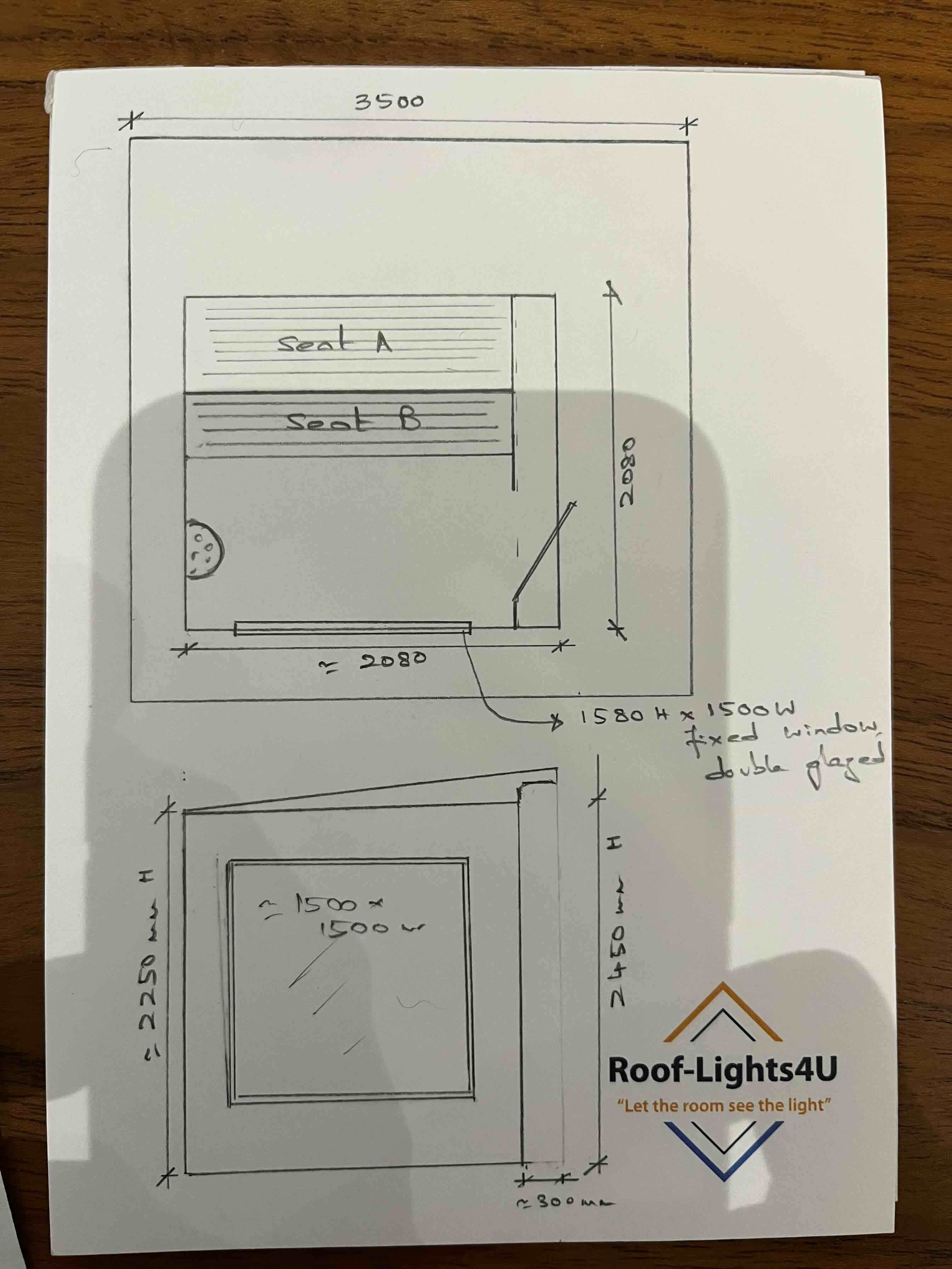

Hello - we want to install an electric outdoor sauna on a 3.5m x 3.5m level composite decking platform.

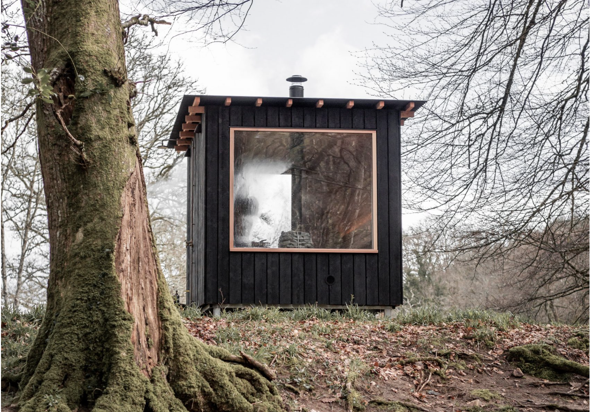

The sauna will be 2m x 2m with a timber door and a single large (1500x1500mm) plate glass window. Please see attached hand-sketch and the finished look we'd like. Research on the net suggests a wide range of prices, but mostly £5K+. Our budget is closer to £3K.
Would anyone know of an experienced local builder (near Langton Green/Tunbridge Wells/Kent) who might be able to build an outdoor sauna for us? We'll have equipped the sauna platform with single phase electricity and water source (for a cold, outdoor rustic shower). Any and all pointers will be most useful. Many thanks!

I used to make saunas, you are going to struggle at the price you are thinking of.
Thanks for your prompt reply @SteamyTea. I should have mentioned the budget of £3K was without installation and the cost of utility connections.... What would be a reasonable budget for a 2x2m sauna? And, can you recommend an installer near TN3 (if we were to buy a modular/flat-packed one)?
I can't recommend anyone these days.  We used to make out own log saunas because of the high price of getting them imported.
You can look at getting a log shed, and then modifying it.  Probably your best bet.

Does this small shed  not lend itself to 'stick build'?
Any decent builder or diy'er could do it and it would be customised and probably sturdier.
From my recent enquiries about building a sauna at home the internal material costs alone for a 2100 x 2100 are £2600.00 from here :
https://www.saunashop.co.uk/product-range/details/2100-x-2100/377/
That price excludes all timber framing for walls , floor, roof, double glazing and any labour.
I would expect a sauna in the above image to cost between 7.5 - 10K.
