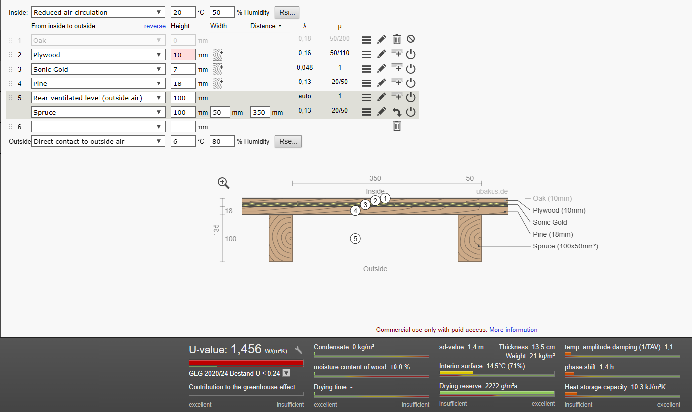

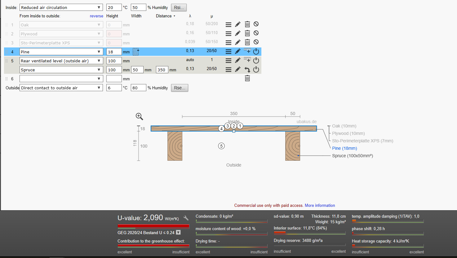

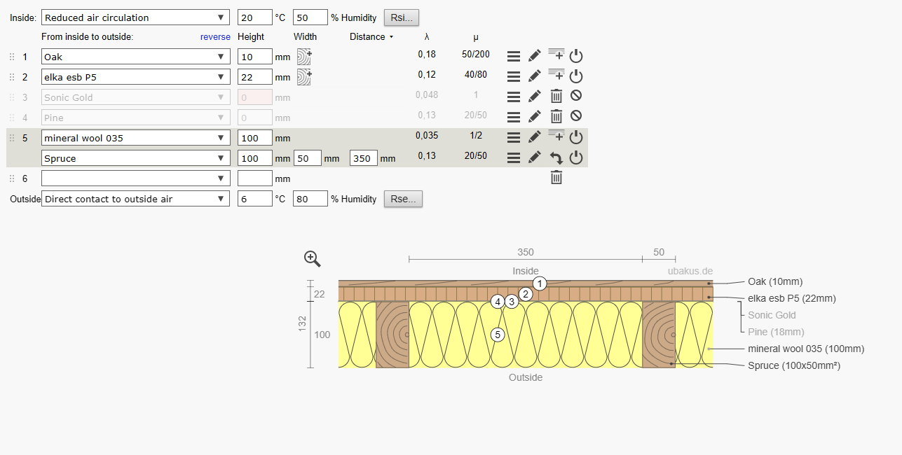

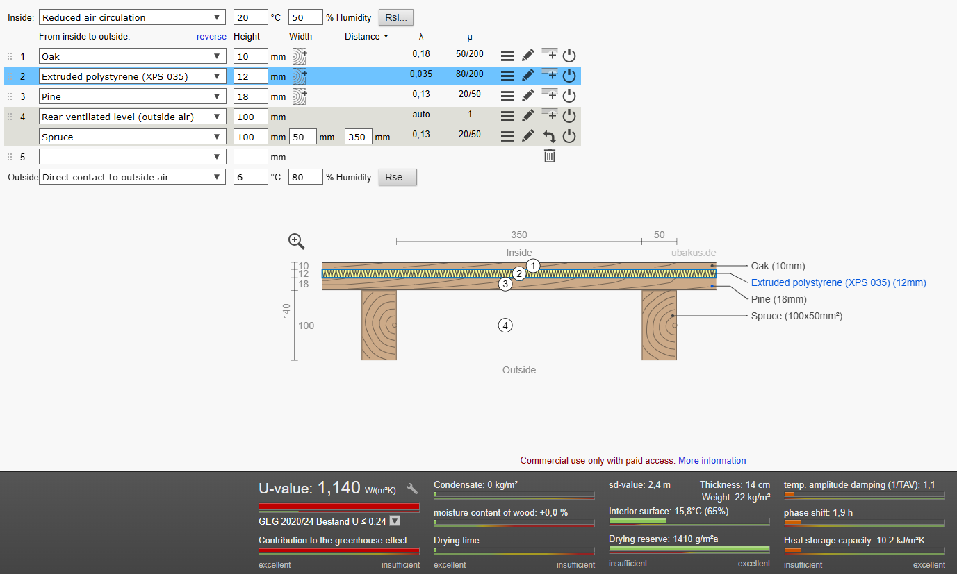

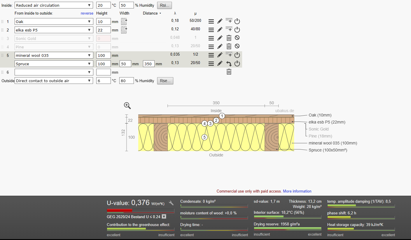

Thermally you're not going to achieve much here in terms of reducing conductive heat losses. The build up is just too thin.
This is what you have currently.
This is what you are proposing. Sonic gold isn't magic. It'll perform much the same as any thin layer of insulation but it's K value isn't great at 0.048W/m2k.
Ideally you would lift the existing floorboards and insulate between the joists, lay something like Egger p5 chip board on top and then your floor.
A Best Practice Approach To Insulating Suspended Timber Floors | Ecological  Building Systems
However if you've ruled this out then I would really concentrate on air sealing all the drafts from the floor. This really is the biggest win thermally and in terms of comfort. I wouldn't bother with the Sonic gold. Its mostly marketing guff.

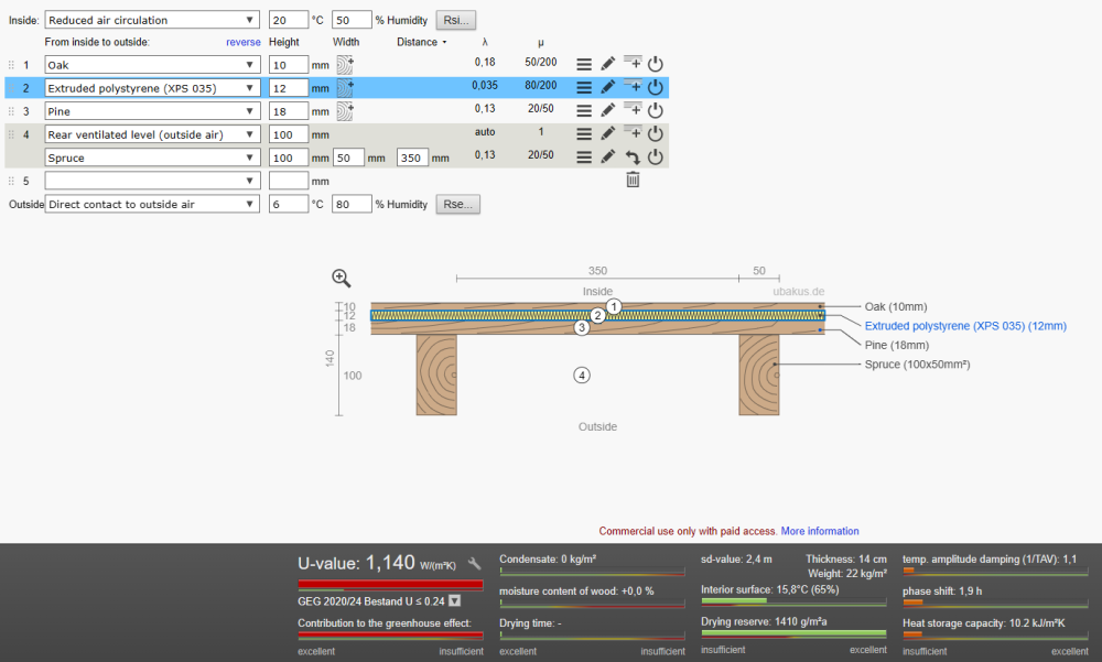

Like mentioned above you could glue the wood floor directly to a tile backing board like Jackoboard which has a K value of 0.034 W/m2K. Lay the boards and seal all joints fastidiously with sealant or tape. Seal them to all perimeter walls similarly to completely eliminate all drafts. This will be your biggest win. The elimination for the need for a layer of ply or OSB will buy you some more insulation depth too.
Here's 12mm.
And here's 20mm if you can fit it.
Both are better than the sonic gold in terms of heat loss but like I said before. The really really big gain is to be had in airtightness and the elimination of drafts.
