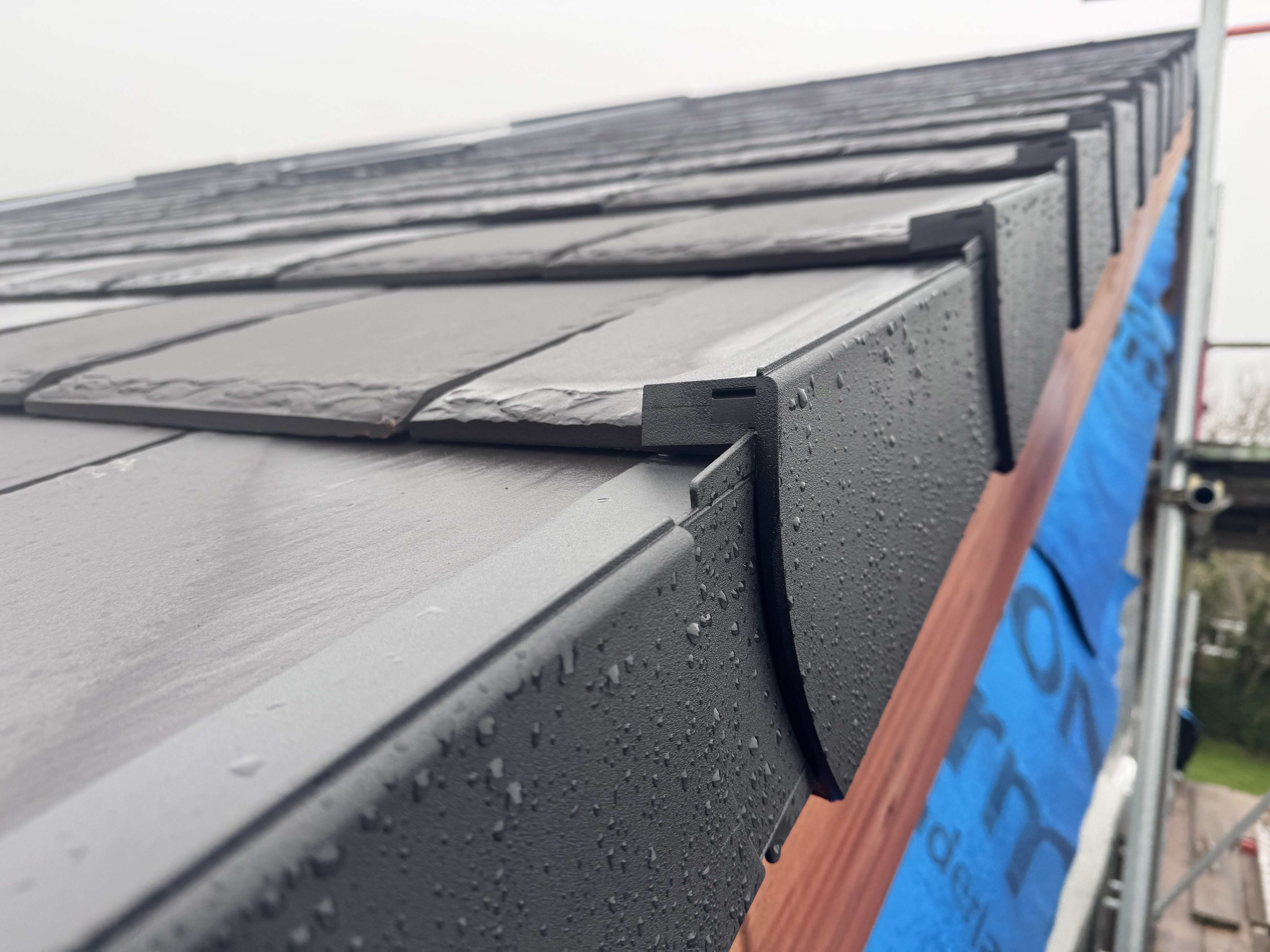

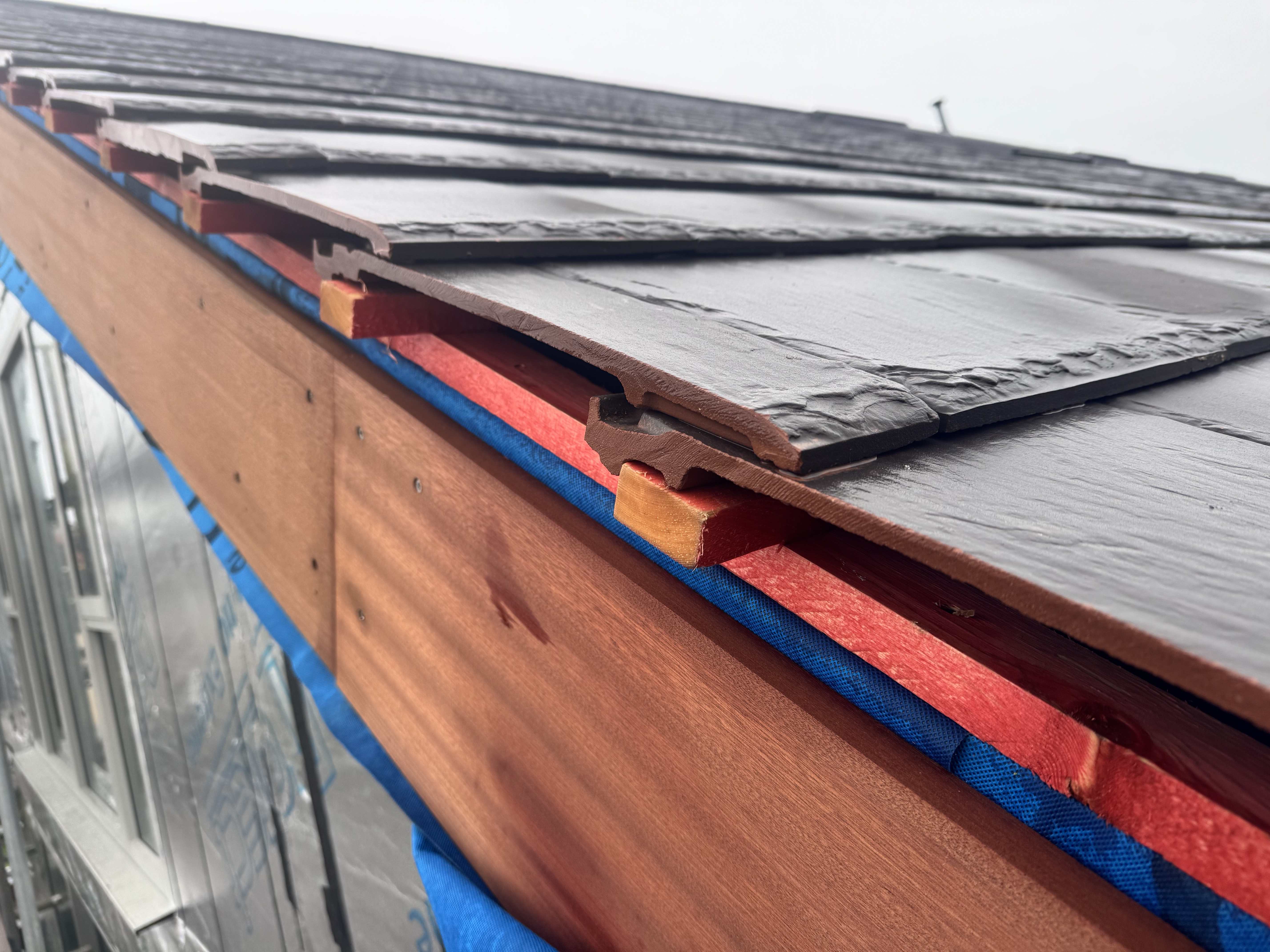

I’ve got a clay tiled roof with plastic click together dry verge similar to this: https://mybuildingsupplies.ie/shop/building-supplies/roofing-building-supplies/roof-ventilation/dry-verge-system/
I’m wondering if it’s possible to redo this with lead for a more rustic finish that suits the house better. Struggling to find much info online so probably barring up the wrong tree here?

Thanks… that’s good to know… do you think I’d get away with one strip or need to do lots of short sections like the plastic one?… advantage of short ones is that they could be slid beneath the tile which will help hold in place but would require much more lead.  The presumably would also need a side fixing to the barge board or batten… struggling to find information online about doing this.
Edited by junglejim
Look up the Calder lead guide.
as a general rule no single piece of lead should be longer than 1.5m.
have you thought of a folded aluminium one, or powder coated steel.
