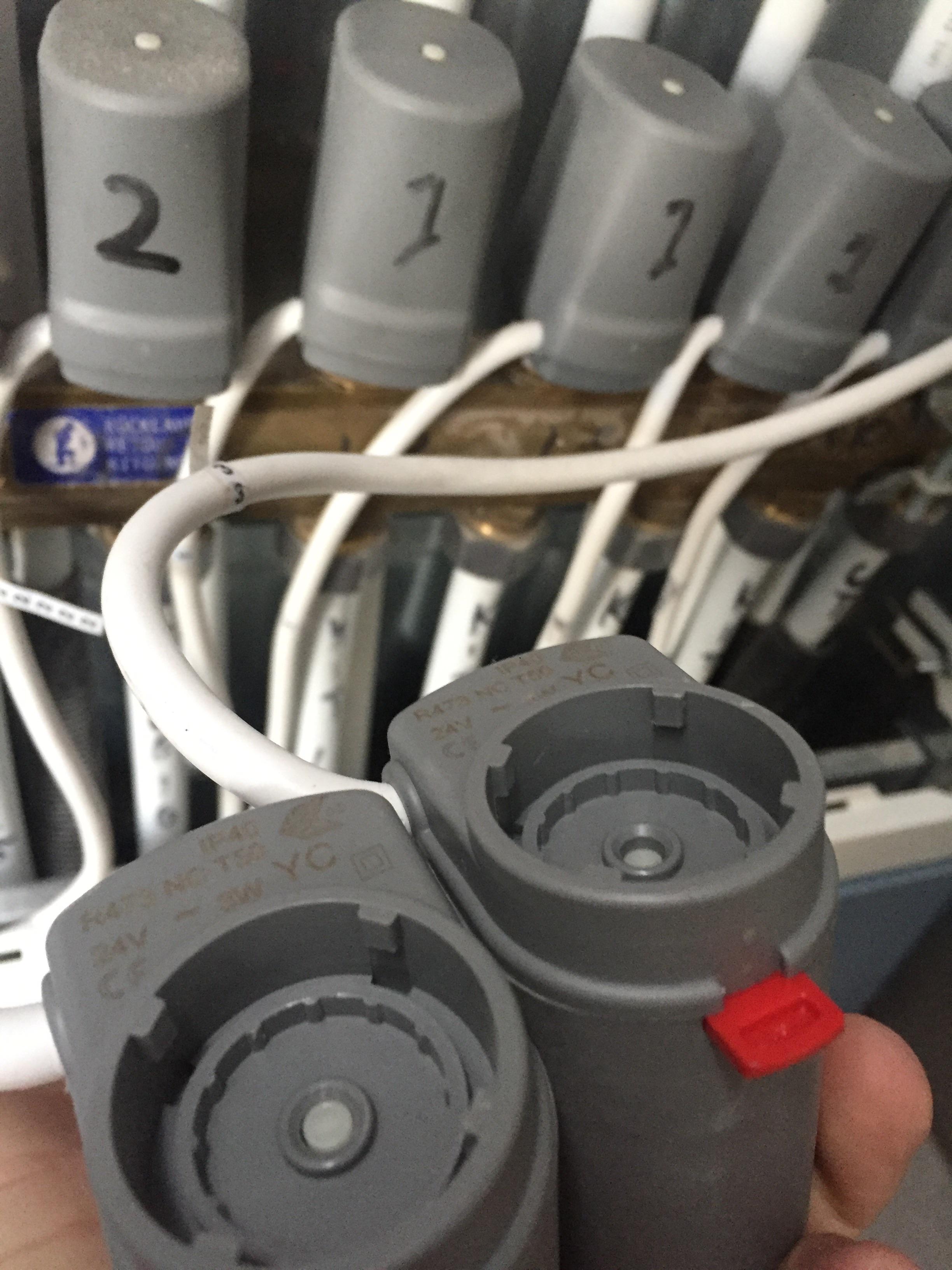

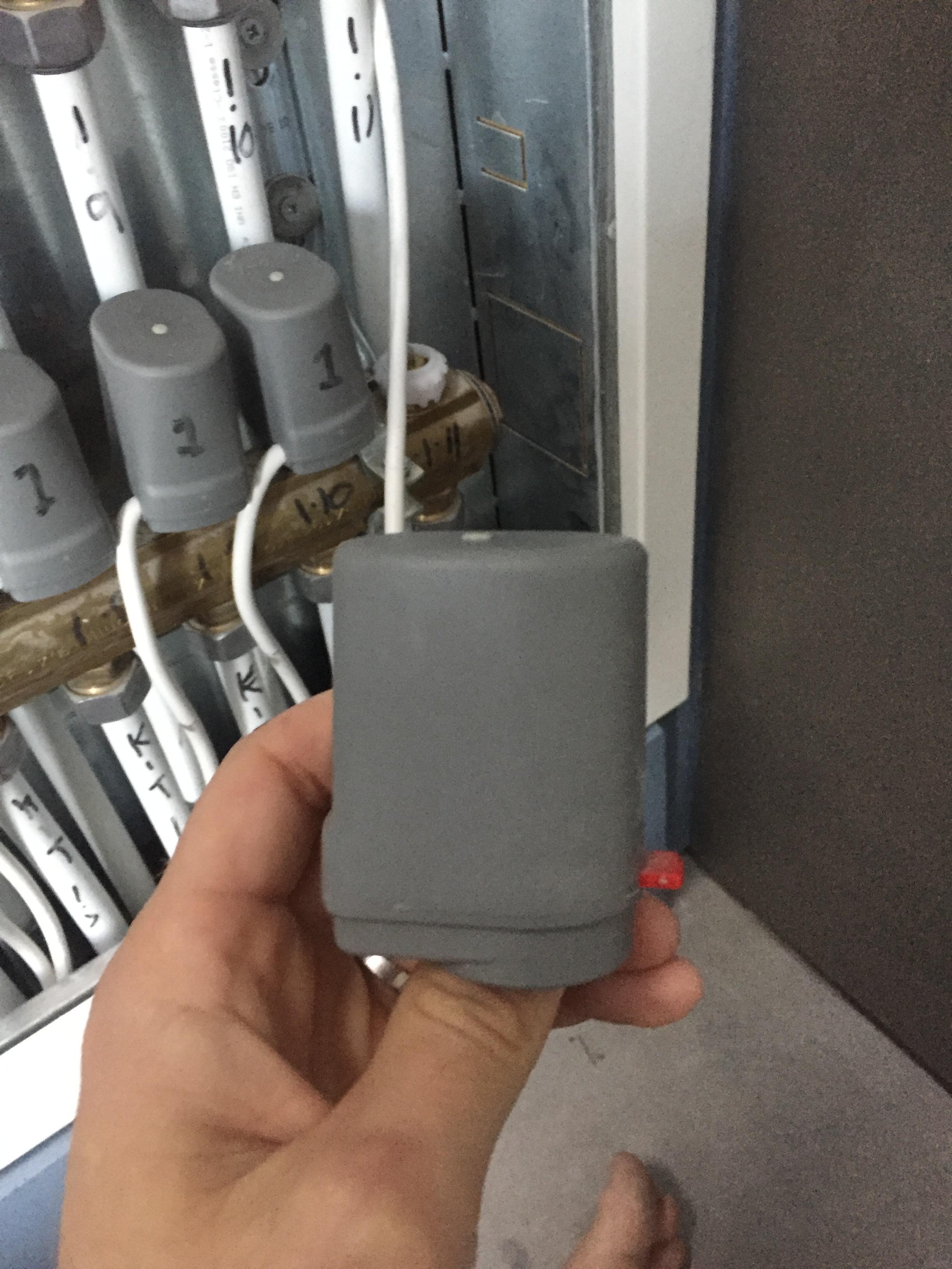

Trw144 Posted November 26, 2017 Author Posted November 26, 2017 (edited) @Nickfromwales Nick, what does this button do on the back on the actuator - i don't think it's a swap between normally open and close but the ones with it pressed on look like the pin is slightly further protruding? Its pushed in on one or two (not corresponding to circuits with problem though) Edited November 26, 2017 by Trw144
Trw144 Posted November 26, 2017 Author Posted November 26, 2017 (edited) Is this what could be letting the trickle past? Edited November 26, 2017 by Trw144
Nickfromwales Posted November 26, 2017 Posted November 26, 2017 Haven't ever seen that before TBH. Is it part of the locking mechanism or is it deffo altering the position of the pin ? If the latter, changed them all to the fully recessed position and try again. Can you post a link / Google the manufacturers blurb?
Trw144 Posted November 26, 2017 Author Posted November 26, 2017 @Nickfromwales it's one of these ..... https://uk.giacomini.com/sites/giacomini.uk/files/Giacomini R473 Actuators_Data Sheet.pdf
dpmiller Posted November 26, 2017 Posted November 26, 2017 so the red button locks the actuator Open.
Trw144 Posted November 26, 2017 Author Posted November 26, 2017 @Nickfromwales So, been out all day at a kids party, just got back and had a chance to take a closer look. Have adjusted all the actuators so they all have the button pressed in - basically it's like a bleed valve for bypassing. Explains why the kitchen floor was always warm. Moving onto the rooms without heat - I think it may be flow rate as I ve managed to adjust the valve so I am showing a flow, so presumably it can't be an air blockage. The manifolds I have have two elements to the balancing - I ve done the adjustment I can but did nt want to risk attacking it with an adjustable spanner on a Sunday evening - will see if it has helped and will get plumber to run through the balancing when he is here in the morning.
