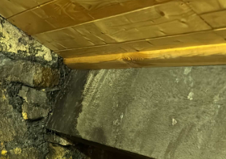

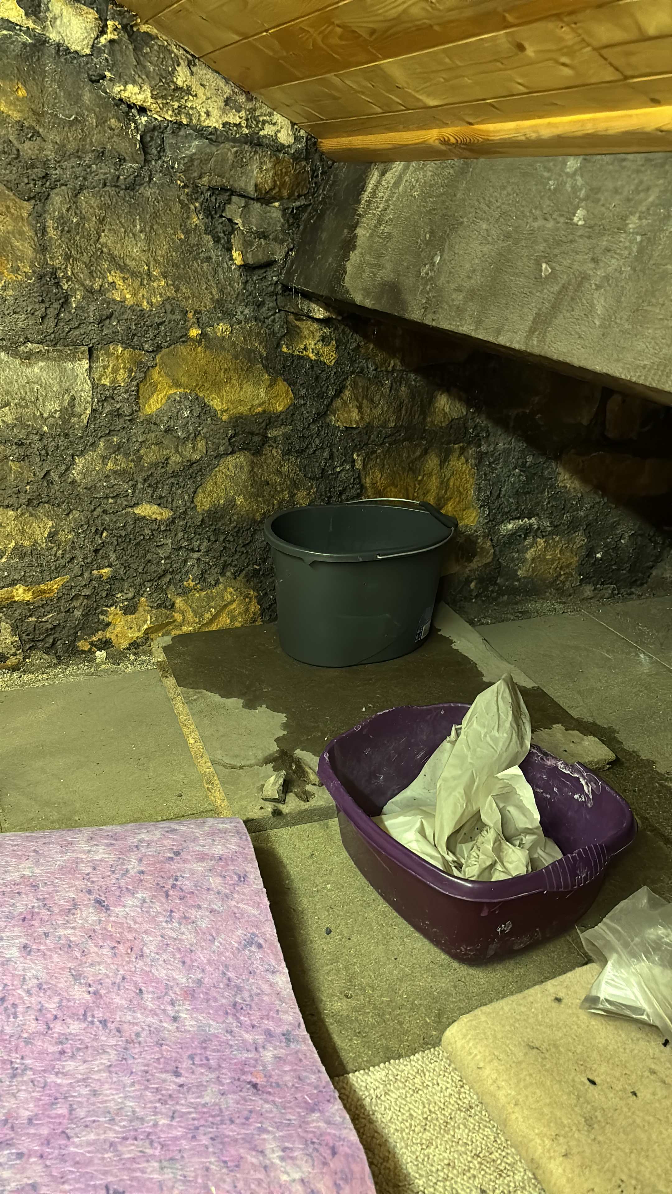

So I've a stone terrace, c1900. Roof has been updated as it has a breathable membrane. I've had the chimney stack re-pointed and new lead flashing/soakers done. Im still getting water leaking into the loft down the wall where the chimney stack is, it drips heavily from the sockets of both purlins. Only happens when I get heavy rain. It's dripping not just soaking through via osmosis. Flaunchings have been redone and all chimneys have been capped.
Any ideas?

Is the stack within the thickness of the party wall? I can't see a 'chimney breast'. Can we have external pics? How does the purlin socket line up with the edge of the stack, for example? Can we assume it is about on the bottom side of the stack? If so, in the absence of any other 'hypotheses' so far, can I throw in porous stone effectively 'by-passing' the flashings and soakers?

the purlin sockets do seem to line up with the edge of the stack. the chimney breasts is within the thickness of the party wall.

I did notice, since the flashing and leadwork, the leak appeared worse than before. it was a trickle before, now it's more like a steady stream.

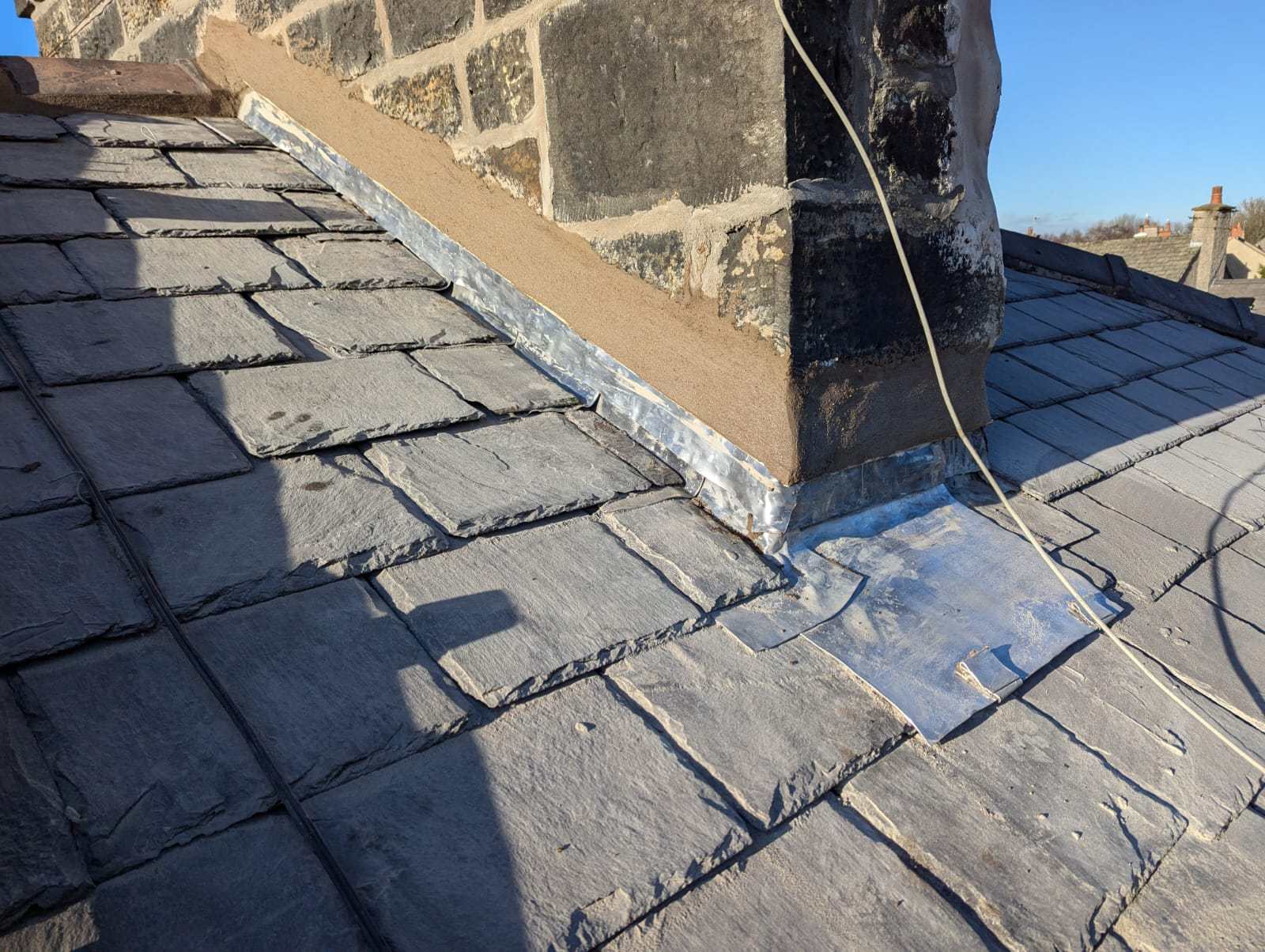

Thanks for the pictures. It helps for us to guess what is going on.😂

How about water leak detection tablets - dye the water in one area ( in this case  a limited area on the side of your chimney) and wait .....
I've used my  Thermal imaging camera to discover leaks before now - the water lowers the temperature locally
I'd be tempted to take this short plank out and have a little look-see.....

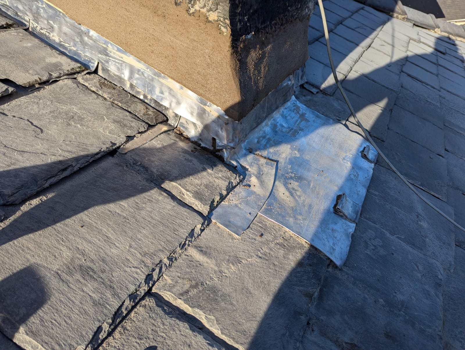

I’m no expert but if mine I would like to know how much overlap the lead soakers have. There are little gaps where wind driven rain could get in but the overlap should cope.
Also the section right at the top where there is no lead over the ridge tile looks a weak point to me. I appreciate that your leak seems to be further down but maybe it is tracking down from higher up. You might be able to test this by sending a hose right where the ridge tile meets the stack and see if any is getting inside.
Why is the lead under the tiles?  It should be dressed over the tiles (unless I am missing something!)
Any rain will run under the tiles and eventually find its way inside!
The lead under the tiles is (are) the soakers, AFAICS, laid as you'd expect as per the slates (I think). There is then a sort of 'mini-skirt' flashing over the upturned soakers, again, as far as I can see. Although the abutment is different that's how the soakers work on my extension abutting the main house wall with ridge at 90 degrees to the main house wall. My 'cloaking' (over the soaker upstand) is different in that it's a thinned-out layer of EWI, and comes down further, but the principle is the same. The practice is different in that mine does not leak...
Looking at it again we used to allow a 150 upstand for soakers and stepped flashings and bottom and top 'aprons'. Do we think rain could be 'bouncing' over the lead-line, soaking into the sand/cement 'fillet' and running down? (Not certain I buy that even though it's my suggestion, but 'discuss'!).
