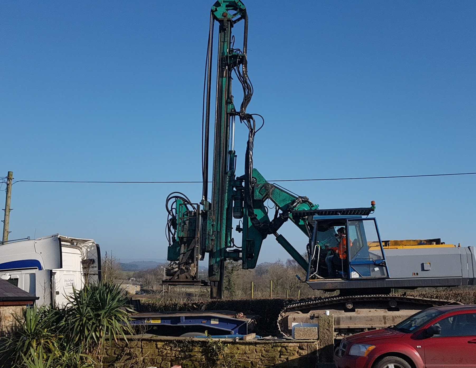

ToughButterCup Posted December 30, 2024 Posted December 30, 2024 On 29/12/2024 at 22:26, Russell griffiths said: ... I would do an assessment of your access and send it out to a few companies and see what sort of rig they have to fit your site. ... Expand Good advice. BUT When we did a similar exercise (narrow single lane track) , the rig driver could not have cared less about the documentation we offered him (via his company office). He arrived with the rig, looked at the couple of really tight corners, - sniffed - spat - and muttered about him having forgotten his stone saw. "Why do you need one ?" I (stupidly) asked "That road sign's gonna have to come down" I ran and fetched ours. Didn't need it. Heres' the rig. Made in Germany by Zeppelin - yes, thats right, you couldn't make it up...... airships and piling rigs 1 1
