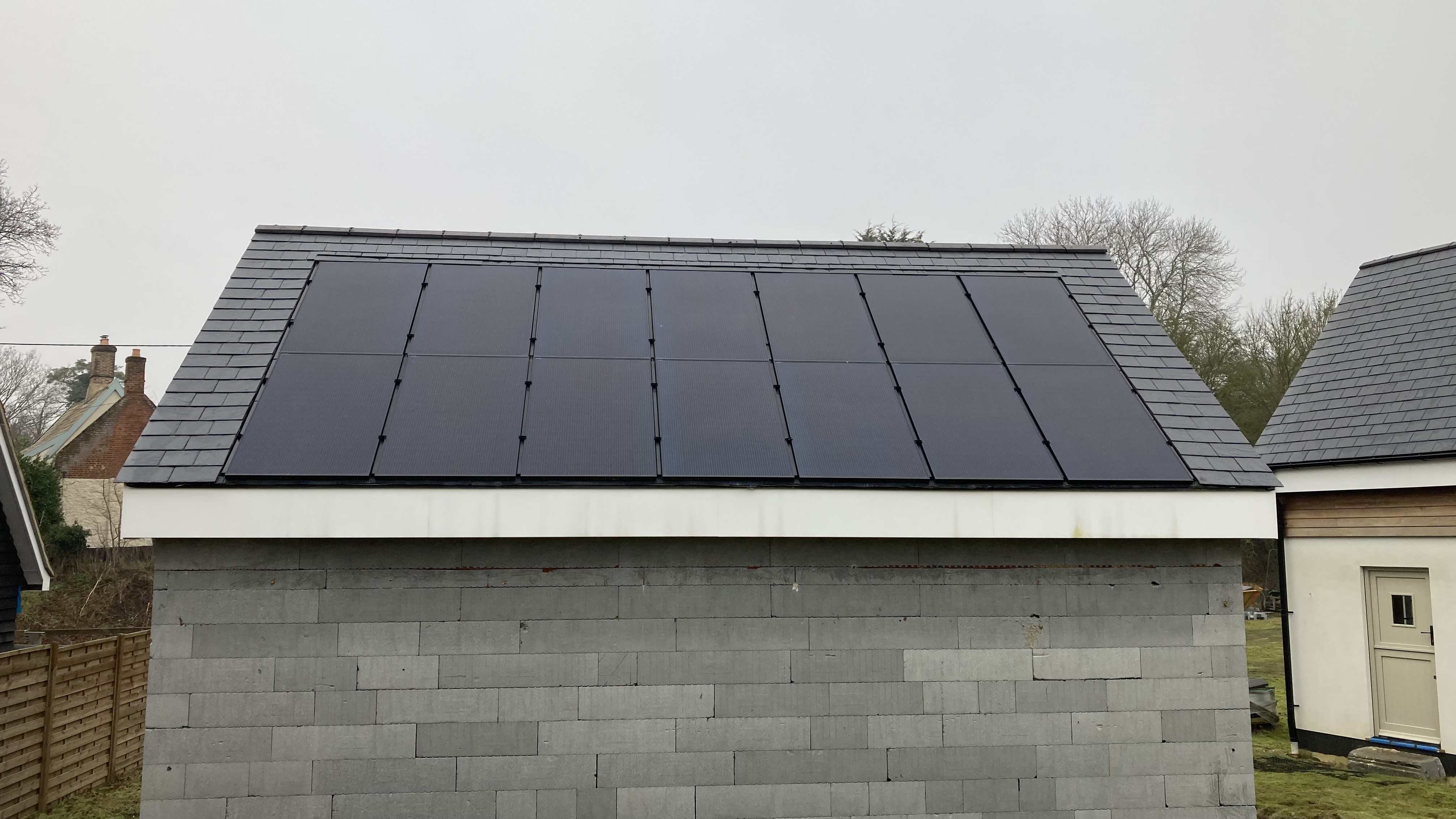

Nickfromwales Posted February 11, 2025 Posted February 11, 2025 1 hour ago, Alan Ambrose said: Ah, picture paints 10,000 words. Thanks. Is it a PITA to get your battens spaced so they suit both the tiles and the trays? I've looked at the GSE docs and they make it look v hard. Nope. A doddle, as we just programmed the roofer and let him crack on lol. Very simple to do tbh, just time and labour / materials, nothing overly technical or complicated to it.

Nick Laslett Posted February 11, 2025 Posted February 11, 2025 11 minutes ago, Alan Ambrose said: Wow, looks v neat. Thank you. I can’t take much credit the lads that did the roofing were excellent. It is worth remembering if you have gable ladders your roof might be as much as 30cm larger on either side. I just popped outside and took another photo. The fascias need a bit of a clean. I will get the gutters up one day. The ICF wall still needs cladding. 2 1

marshian Posted February 12, 2025 Posted February 12, 2025 23 hours ago, Nick Laslett said: I just popped outside and took another photo. The fascias need a bit of a clean. I will get the gutters up one day. The ICF wall still needs cladding. That looks excellent - thanks for sharing an updated picture
SteamyTea Posted February 12, 2025 Posted February 12, 2025 On 11/02/2025 at 10:43, Nickfromwales said: That looks like a roof that is not going to be affected by shading, though I cannot see it all. Is there a real reason to fit optimisers on it, rather than just allow the built in bypass diodes to do the work of disconnecting shaded parts.
Nickfromwales Posted February 12, 2025 Posted February 12, 2025 43 minutes ago, SteamyTea said: That looks like a roof that is not going to be affected by shading, though I cannot see it all. Is there a real reason to fit optimisers on it, rather than just allow the built in bypass diodes to do the work of disconnecting shaded parts. Yea, the roof was H shaped and the hip out to the left had PV on the other side (west facing), the panels you see are south facing, and then the same out of shot (to the right of the image) for east. Just small enough to put on a single string so inverters allowed us to have the 3 way split array. 👍
G and J Posted February 12, 2025 Posted February 12, 2025 8 hours ago, SteamyTea said: That looks like a roof that is not going to be affected by shading, though I cannot see it all. Is there a real reason to fit optimisers on it, rather than just allow the built in bypass diodes to do the work of disconnecting shaded parts. I’m thinking of optimisers to extend working beyond single panel failure, not to mitigate the effect of shading. But if the panels are that reliable and that easy to pop off and replace, and given that the optimisers are a significant proportion of the cost of a panel, maybe I should consider omitting the optimisers (at this stage) and accepting the potential future cost of professional panel replacement (I’m not as young as I used to be, even though I still happily dangle from ropes when I get the chance).
Dillsue Posted February 12, 2025 Posted February 12, 2025 11 minutes ago, G and J said: I’m thinking of optimisers to extend working beyond single panel failure, not to mitigate the effect of shading. But if the panels are that reliable and that easy to pop off and replace, and given that the optimisers are a significant proportion of the cost of a panel, maybe I should consider omitting the optimisers (at this stage) and accepting the potential future cost of professional panel replacement (I’m not as young as I used to be, even though I still happily dangle from ropes when I get the chance). I think panels are very reliable but if you do get a faulty one how do you know which one is faulty without monitored optimisers? Remember that panel shading can be bird s**t, algae growth, passing clouds, neighbours trees growing, future telephone pole etc etc. Optimisers allow easy expansion using panels of differing wattage. They also allow panels on the same string to face differing directions without reducing collective production. If you're using SolarEdge optimisers, batches come up on ebay at a fraction of retail price so don't have to be painfully expensive 1
