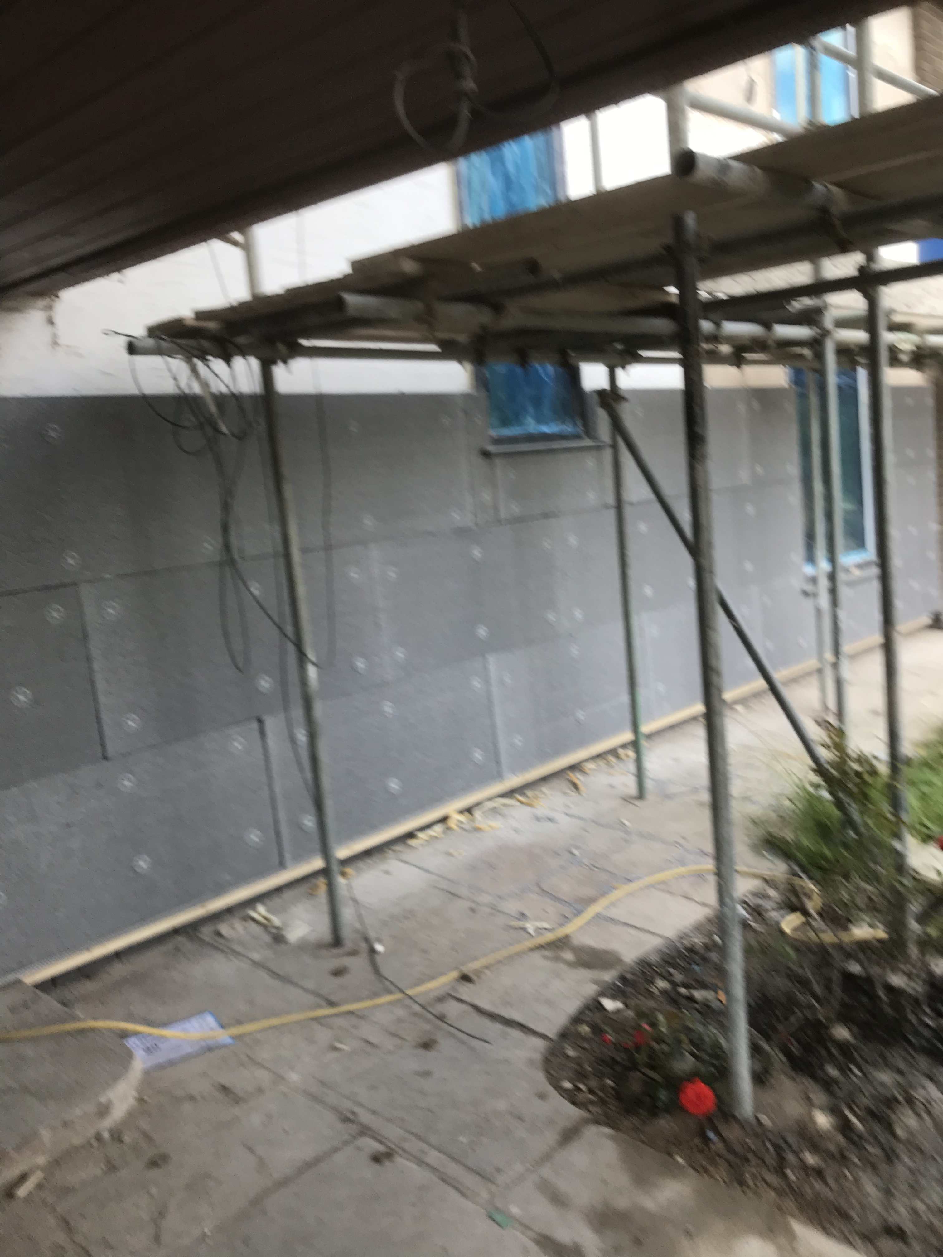

allthatpebbledash Posted January 7 Author Share Posted January 7 On 27/12/2024 at 18:54, nod said: No need to remove render Simply go straight over the top Then add render or dash Any airtightness needs to be done from the inside Most probably what I’ll do. Can you show and explain more of the image? Was this something you’re doing or have completed? On 27/12/2024 at 22:16, Redbeard said: Mineral wool: Worse lambda value - completely non-combustible. EPS: Better lambda value - combustible but protected by render layer. If you don't like using plastics go for RW. Note that you would not use RW down within the splash-up zone. That would be High Density EPS or XPS. I have never seen PIR suggested as a 'below DPC' plinth layer, and certainly would not choose it myself. PIR is not generally used for EWI, to my knowledge. Thanks. On 28/12/2024 at 01:18, Iceverge said: The whole thing is still bananas. Get the bulldozer. LOL Come on, I can’t knock it down. It’s gonna be a headache I can imagine, but it’s too much money to bulldoze now. Especially if the VAT is 5% for me too. Link to comment Share on other sites More sharing options...

nod Posted January 7 Share Posted January 7 1 hour ago, allthatpebbledash said: Most probably what I’ll do. Can you show and explain more of the image? Was this something you’re doing or have completed? Thanks. LOL Come on, I can’t knock it down. It’s gonna be a headache I can imagine, but it’s too much money to bulldoze now. Especially if the VAT is 5% for me too. It was just one of many jobs that I had on my phone 1970s detached Doubled in size 70-100 mil EWI depending on steps etc Covering brick and render Link to comment Share on other sites More sharing options...
