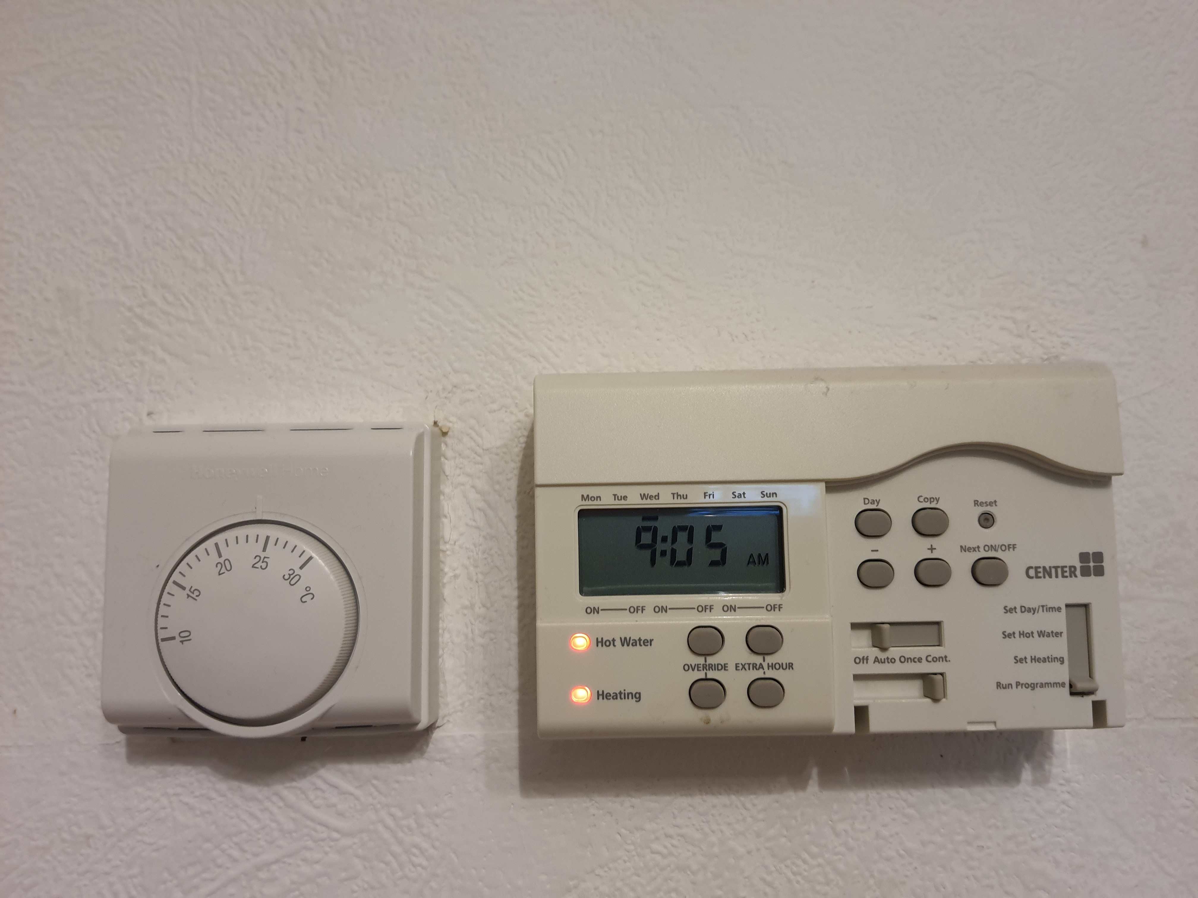

Gone West Posted December 21, 2024 Posted December 21, 2024 My central heating decided to stop working last Tuesday. I thought I found the problem when blowing through the thermostat seemed to clear the problem. It packed up again and I replaced the thermostat and it was ok for a couple of days. Switching the main CH power switch off and on clears the problem for anything from a couple of hours to a couple of days. When I switch the power back on there is a clunk from, I think, the controller/programmer. Any ideas what the problem could be. I have the heating running 24/7 and the DHW on twice a day.
ProDave Posted December 21, 2024 Posted December 21, 2024 Nobody can diagnose that remotely. What trips? MCB? RCD? RCBO? or post a picture of what trips if you don't know. Next time it trips, switch the two slide switched to OFF before resetting it. then try with just heating on for a few hours, then try just DHW for a few hours and see if you can narrow it down a bit. The clunk from the controller is a relay energising and quite normal.
Gone West Posted December 21, 2024 Author Posted December 21, 2024 On 21/12/2024 at 09:58, ProDave said: What trips? Expand Nothing trips, it just stops working. The only way to get it working again is to turn the CH power switch off and on again.
ProDave Posted December 21, 2024 Posted December 21, 2024 On 21/12/2024 at 10:16, Gone West said: Nothing trips, it just stops working. The only way to get it working again is to turn the CH power switch off and on again. Expand What stops working? CH, DHW or both? Are the Hot Water and Heating lights on the programmer still on when it stops? Can you get it working again by turning the heating or hot water off and back on again?
Gone West Posted December 21, 2024 Author Posted December 21, 2024 On 21/12/2024 at 10:19, ProDave said: What stops working? CH, DHW or both? Expand Both. On 21/12/2024 at 10:19, ProDave said: Are the Hot Water and Heating lights on the programmer still on when it stops? Expand Yes On 21/12/2024 at 10:19, ProDave said: Can you get it working again by turning the heating or hot water off and back on again? Expand Not by turning the CH or DHW off and on, on the programmer.
ProDave Posted December 21, 2024 Posted December 21, 2024 When it has stopped working and you try turning heating and hot water on and off with the slide switches, do you hear the relays in the programmer go click?
Gone West Posted December 21, 2024 Author Posted December 21, 2024 (edited) On 21/12/2024 at 10:29, ProDave said: When it has stopped working and you try turning heating and hot water on and off with the slide switches, do you hear the relays in the programmer go click? Expand No. There is only a clunk from the programmer when the main CH/DHW power switch is turned off and on again. Edited December 21, 2024 by Gone West
ProDave Posted December 21, 2024 Posted December 21, 2024 I don't think a remote diagnosis can go much further. do you have any electrical test gear like a multimeter? Are you confident taking live readings? If not you probably need an electrician. But if you don't want to do that, one thing to try is a new programmer, but that is not guaranteed to work. they are easy to swap and in 95% of cases the new one will just fit onto the old back plate without alterations.
Gone West Posted December 21, 2024 Author Posted December 21, 2024 On 21/12/2024 at 10:46, ProDave said: I don't think a remote diagnosis can go much further. do you have any electrical test gear like a multimeter? Are you confident taking live readings? If not you probably need an electrician. But if you don't want to do that, one thing to try is a new programmer, but that is not guaranteed to work. they are easy to swap and in 95% of cases the new one will just fit onto the old back plate without alterations. Expand OK, thanks for your time. I do have a multimeter and I have taken live readings before but I might just try a new programmer. It's just the wrong time of year. Have a good Christmas.
ProDave Posted December 21, 2024 Posted December 21, 2024 That is indeed the simplest thing to try, just one tip when looking for a replacement programmer, avoid any that make mention of a "Service Interval" timer, often with SI in the part number. Sometimes depending how it is wired, it can be very difficult getting a test probe onto what you want to measure to determine which bit is working or not. 1
Gone West Posted December 21, 2024 Author Posted December 21, 2024 On 21/12/2024 at 11:07, ProDave said: That is indeed the simplest thing to try Expand Having seen the price of a replacement, and bearing in mind I will be replacing the whole CH and DHW systems next year, if I disconnect just the programmer from the wiring box, am I right in thinking the system will still work. Am I correct in thinking it will be controlled solely by the CH thermostat and the DHW thermostat without any timing control, but will be safe. As we currently have the CH on 24/7 it wouldn't be a great loss, with just the DHW being on a bit longer than at present.

Gone West Posted December 28, 2024 Author Posted December 28, 2024 As a follow up, I couldn't get the cheapest programmer but got the cheapest from Screwfix last Sunday and it fitted ok. We were away over Christmas for a few days and when we came back yesterday the house and was nice and warm. 2
