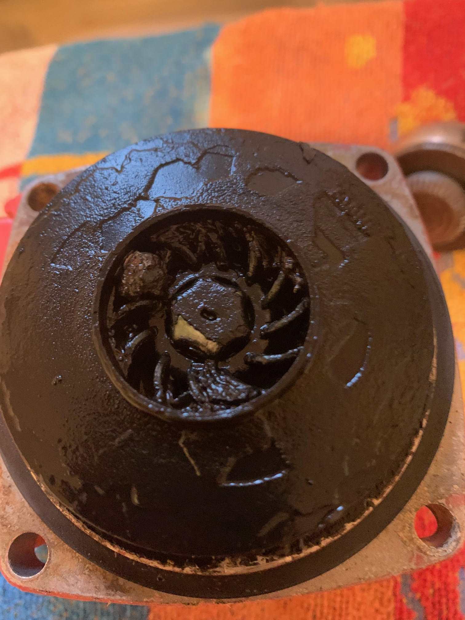

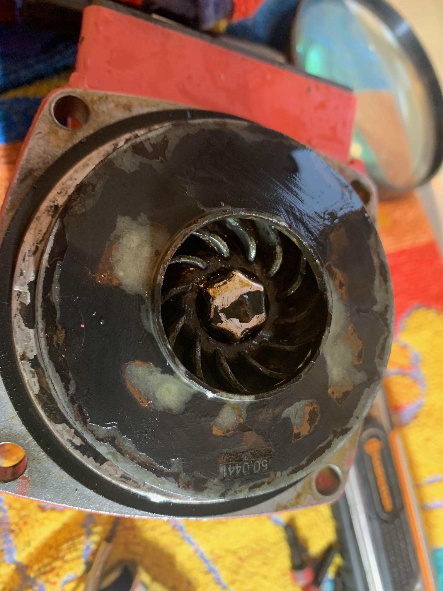

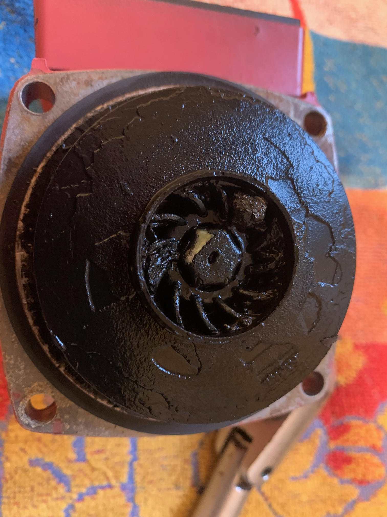

marshian Posted January 12, 2025 Posted January 12, 2025 @John Carroll would probably be able to tell you what that circulation pump flows but on Pump Speed 3 it should be more than enough to cope with a big circuit of 19 rads TL:DR - might be worth checking / cleaning pump internals?? Long Version I've just had a thought (based on my experience a couple of years back) My CH circuit always ran on PS 1 (Pump Speed setting one) ie the slowest setting on the pump - gave best DT's at the rads - the house warmed up quickly and all was good in the world (I didn't have WC but ran a fixed Flow temp of 55 Deg C because below that the HW tank wouldn't heat up in the time slot) Only when it was really cold did I bump the pump speed to 2 rather than turn up the flow temp. I didn't like PS 2 because it circuit was noisier and Mrs Marshian is a stupidly light sleeper and circuit noise wakes her up. Then one winter the house wouldn't heat up as well and I had to turn the pump speed up to 2 when it wasn't really that cold outside. I really struggled to understand what was happening but eventually put it down to an aging pump (20 years old) Then when it got really cold I needed PS3 - something was really wrong. So I isolated the pump, removed it and split it This is what the impeller looked like Yeah that's really not going to help move water I have a magnaclean in circuit it never pulls much out of the system - this is typical after 6 months However there was one thing I missed - the magnaclean is after the pump not before it so protecting the boiler but not the pump So I cleaned all the vanes out on the impeller Yes I know it doesn't look like new but the magnatite I scraped out was a good half an egg cup worth. Pump back together and guess what - Pump Speed 1 was absolutely fine again - no system noise, warm house, happy wife = happy life. Next time I did some work to the CH circuit I swapped pump and magnaclean unit so it now protects the pump as well as the boiler. 1
