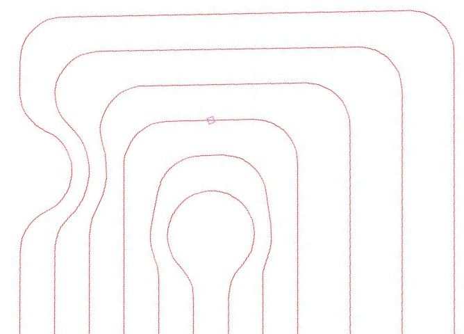

ringi Posted December 11, 2024 Share Posted December 11, 2024 The bending radius for 16mm pipes seems to be normally made 150mm, but I understand it can be 5*16=80mm. So the required 180degree bend in the center of the spiral is at least 160mm wide. How is such a bend fitted in when using 100mm (or below) pipe spacing? These details seem to be "brushed over" in the fitting instructions and the example plans often don't keep to the minimal bending radius for the pipes. Or am I missing something..... Link to comment Share on other sites More sharing options...
JohnMo Posted December 11, 2024 Share Posted December 11, 2024 10 minutes ago, ringi said: How is such a bend fitted in when using 100mm (or below) pipe spacing? Do a spiral - not a zigzag. Or you do an oversized bend and bring the pipes in. Why do you need such tight pipe spacing? Link to comment Share on other sites More sharing options...
Mike Posted December 11, 2024 Share Posted December 11, 2024 Here's one way: 1 Link to comment Share on other sites More sharing options...

JohnMo Posted December 12, 2024 Share Posted December 12, 2024 Are putting any heat loss calculation into this design? What is your W/m² output target? Are you investing in suitable insulation below the pipes, i.e. 150mm+ of PIR or 50% more in EPS? Is screed or something else going above the pipes? A quick look at 100mm centres and a realistic heat pump flow temp of no more than 40 degs, you are looking at 62W/m². 50mm centres closer to 70W/m² 150mm centres is about 57W/m². 1 Link to comment Share on other sites More sharing options...
