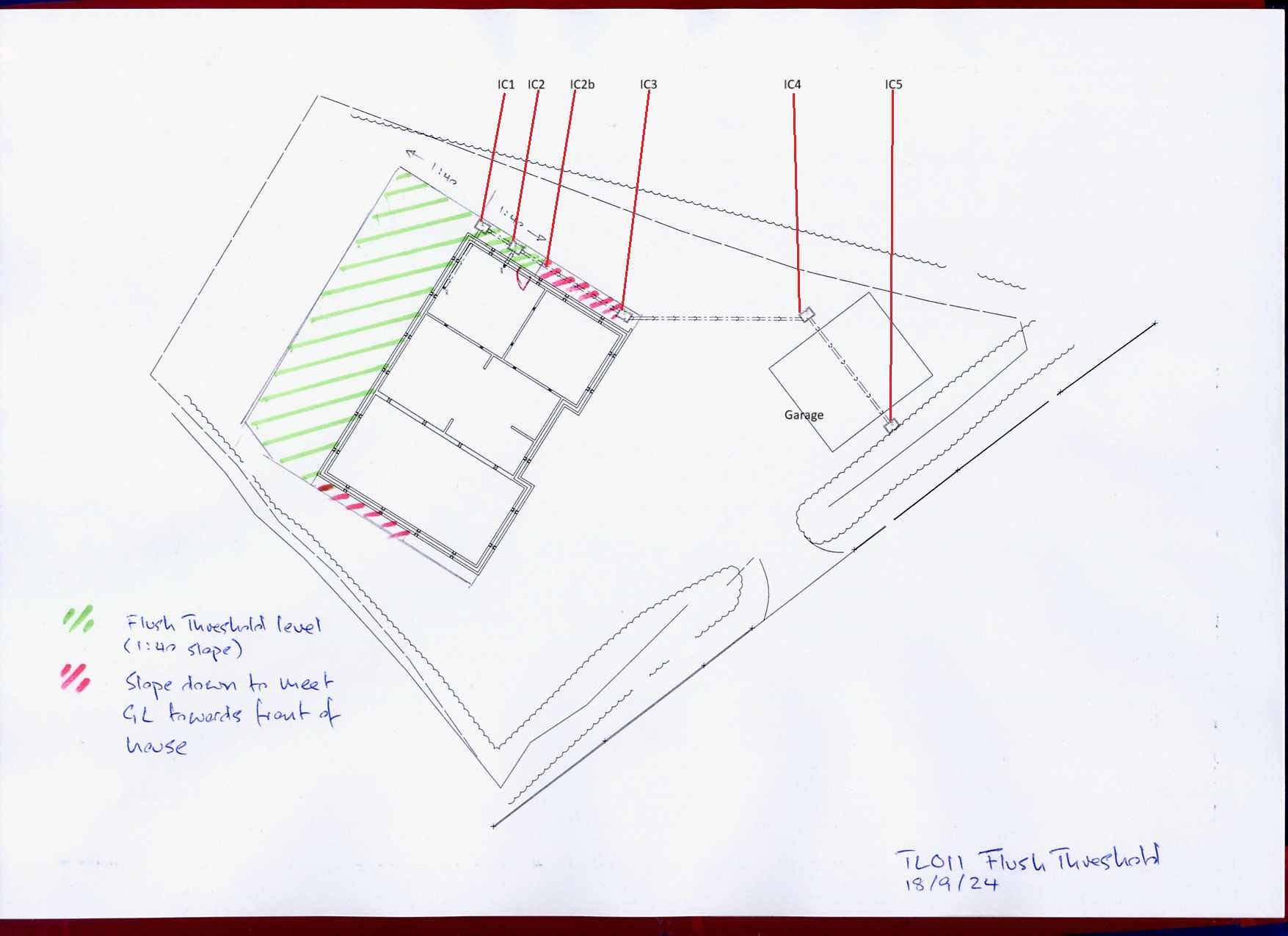

My drain plan is shown in picture 1.

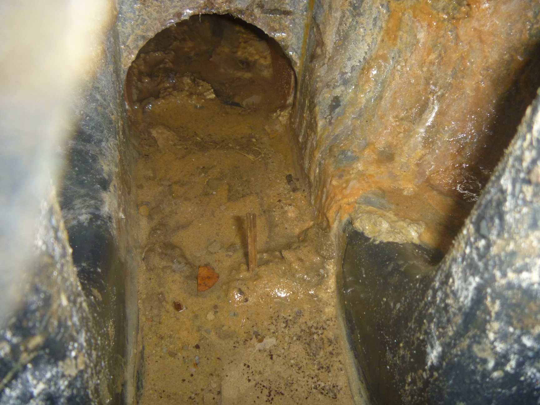

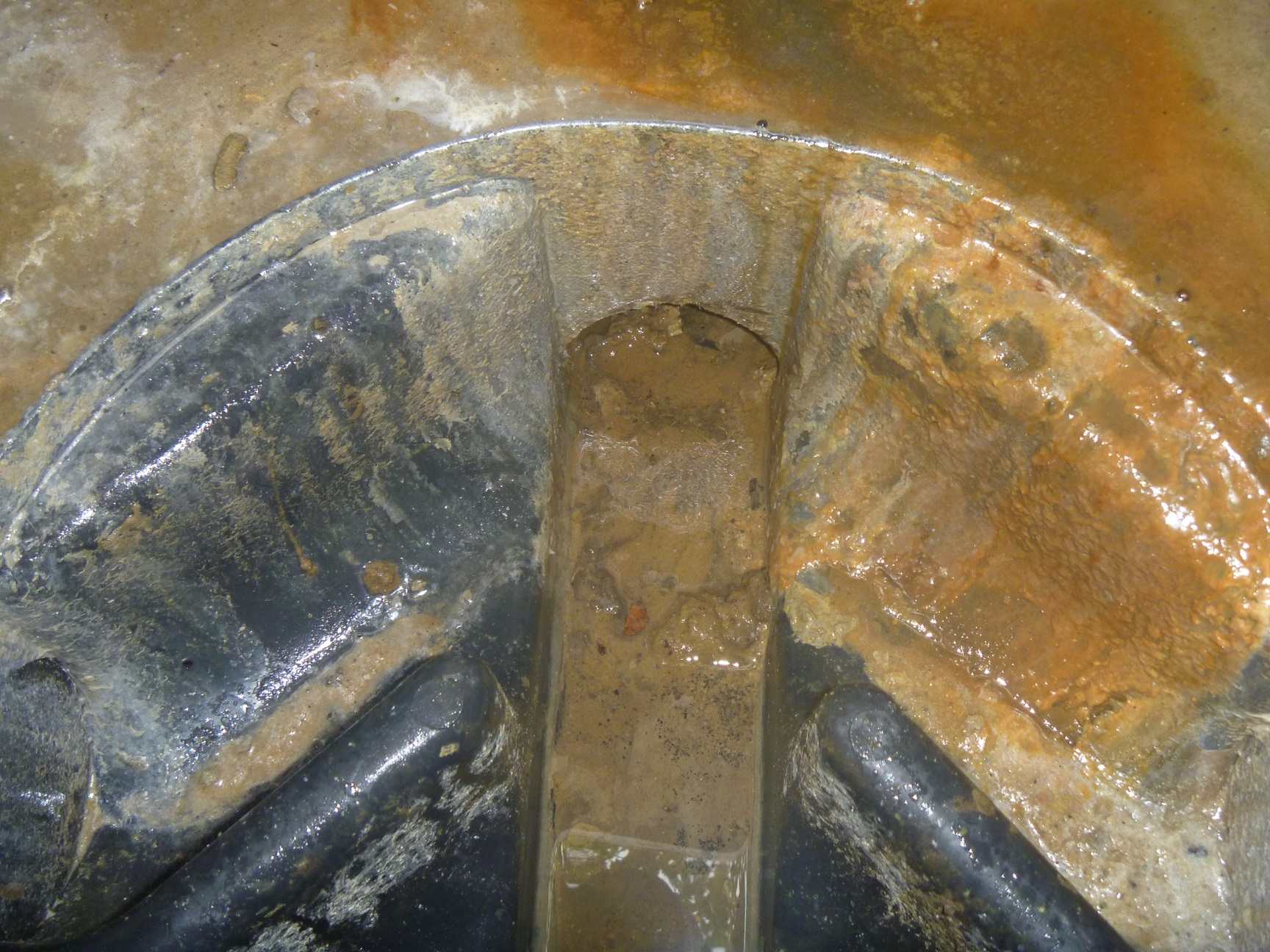

I looked in IC4 (between house & garage). I saw sand & soil in the bottom of the drain; there was water on top of this & it was flowing very slowly.  There are no taps, etc connected.  This must just be water from the ground (storm Daragh over the weekend).  There’s a high water table at the site, so the bottom of IC4 would normally be below this in the winter, even without a recent storm.  In the video you can see water coming in where the risers join.  Also, it’s coming in through one of the redundant inlets (it’s supposed to be capped off).  Water looked like it was coming in from up stream, into the main channel, as well.

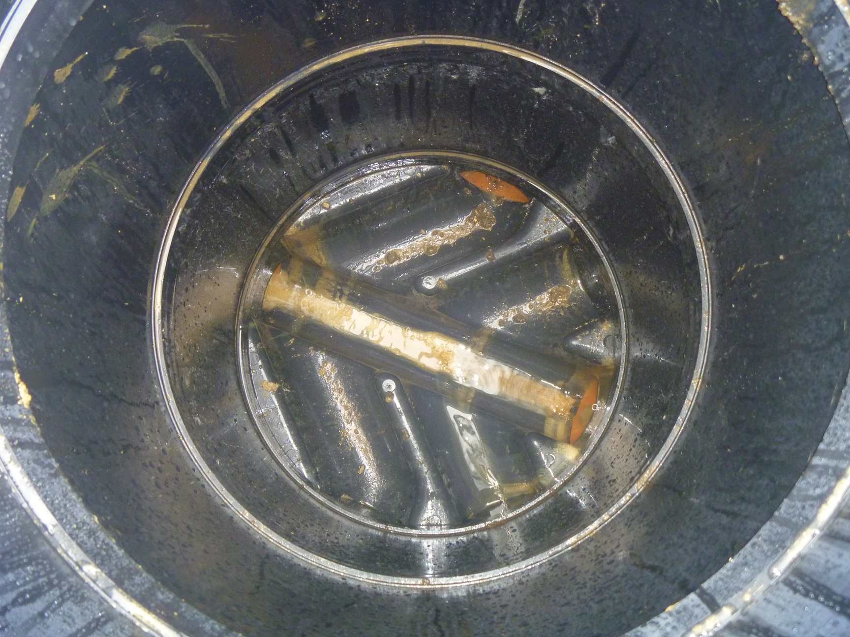

I removed the cover from the final IC, IC5.  This one is > 1.5m deep (I think – I should have measured).  In here things look even worse.  There’s a build up of at least 20mm of sand & soil across the bottom of the main channel.  There’s about another 20mm of water on top of this & it didn’t look like it was flowing, although it probably is flowing – just too slowly to see.  I could see water coming in at the base, where the concrete floor meets the cylindrical wall.  There’s a video that shows a buble right in the first second.  It was bubbling away, then as soon as I started recording the video clip it stopped – perhaps because of my weight on the concrete base. In this video you can see water flowing quickly, but that’s because I put a hose into the upstream IC4, to see what happened.  There are some pictures here showing a close up of what’s in the bottom.  It looks horrible, as mucky drains always do, but it’s just sand & soil – it isn’t backwash from the sewer.  I put that little, vertical stick in there, to measure the depth of the soil & sand.
I think the bottom of this last chamber is probably set too high in the ground & is flat, rather than with the required fall.

Picture 1
IC4.  Picture 2
IC4.  Picture 3 (a video)
Ah, I'm not allowed to upload the videos.  They're too big.  Don't waste your time telling me how to do a link, please: I'll feel bad if I'm too busy to follow your instructions.

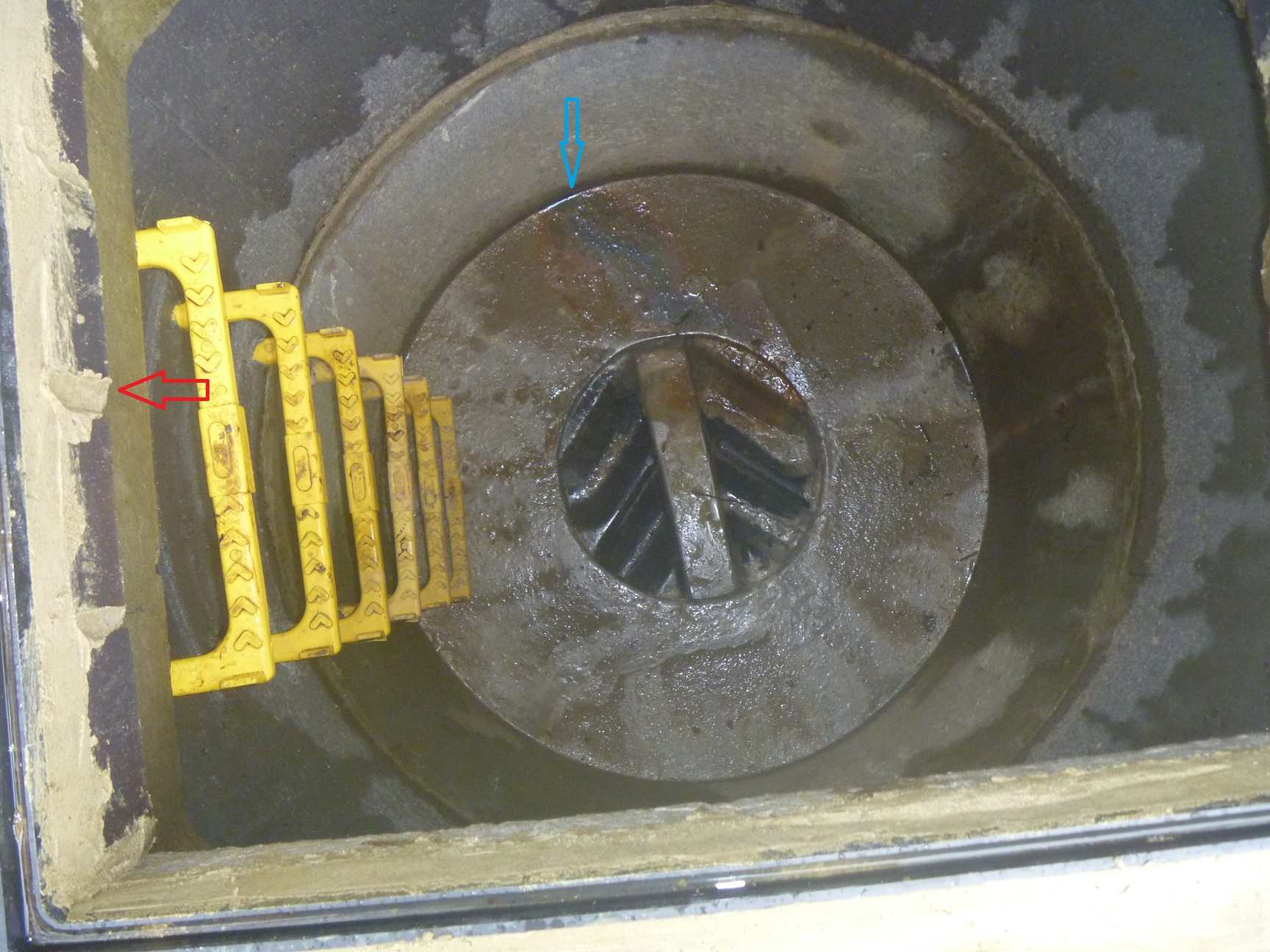

IC5 Picture 6
Is it OK to have these untidy nodules of mortar at the top (red arrow)?  They could freeze & thaw a load of times then break off & end up in the channel at the bottom

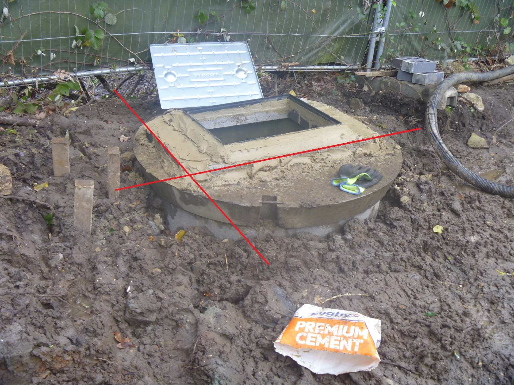

IC5 Picture 7
This shows the top cover of IC5.  I've drawn the red lines on to show where I'm imagining ground level will be once everything's tidied up.  It may lower.  I'm thinking the mortar should be a lot tidier than this.  I've never seen a IC cover poking out of the ground with anything but neat smooth mortar around the sides.  This is poo, isn't it?

Seems like your being over critical
Choose your words when speaking to your builder
Quite common for IC and pipes to fill with crud during the build phase, avoidable but common.
Usually always cleaned out, they have used concrete risers and caps, so imagine pipes been installed with a laser level.
Jetting and vac out of drains isn't as expensive as you would think.
A small amount of water ingress where you have a high water table is standard.  Some of the plastic chambers have rubber seals that can be fitted between the risers, but they can be pain to fit.
Regarding heights, it may have been best to have proper drawings based on a topo survey, with heights and inverts marked, but you would probably be up for an extra £1.5k in fees.  Since the IC is between the back of the garage and a hedge I don't think it will matter.  Also, better higher, so it does not become buried in the undergrowth should you need to access it.

Pics 4& 5 is that actually mud, or have you teed him off enough that he's washed out the mixer into it?
Thanks, @Mr Punter. Sorry, I wasn't clear: I'm not too bothered about the top of the big IC being too high.  I'm concerned the channel at the bottom may be too high - ie not enough fall on the run from IC4.  I'm thinking, if the bottom of this big IC (IC5) was at the right height, almost all the water would drain out of it, but there's a lot in there.
