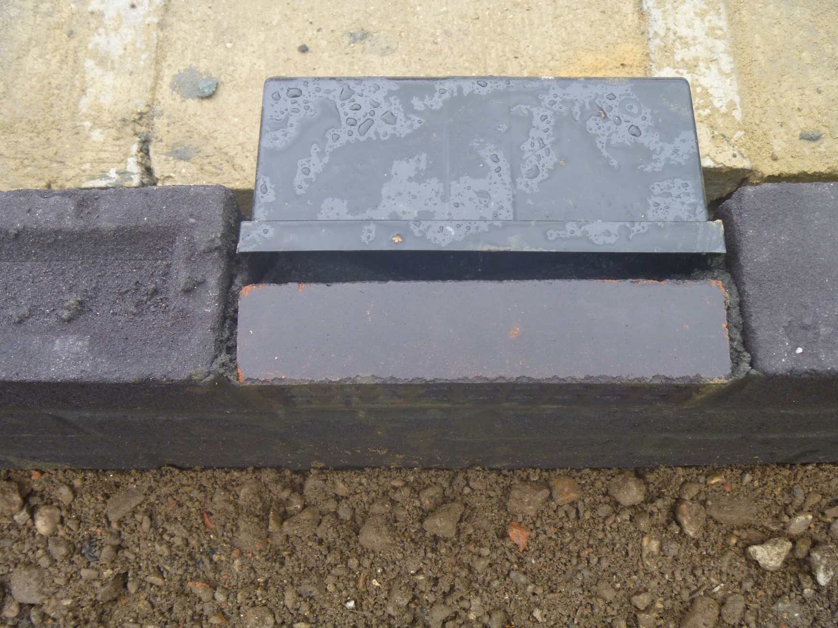

Tony L Posted December 8, 2024 Share Posted December 8, 2024 My builder tells me he's finished (up to DPC). All my ABs look like this. Is this OK? I envisaged the flange on the periscope would fit around the brick & there'd be mortar in the perps to hold everything in place. The periscope can't be pushed any further towards the air brick because there's mortar in the way. Link to comment Share on other sites More sharing options...

Russell griffiths Posted December 8, 2024 Share Posted December 8, 2024 Nope that’s proper shite. Link to comment Share on other sites More sharing options...
Tony L Posted December 8, 2024 Author Share Posted December 8, 2024 Thought so. Thanks @Russell griffiths, & if anybody else would like to agree (or disagree), it would be good to be able to tell my builder (former builder), "I've shown this to 3 people who know about this and..." Sorry: I posted this picture in my other thread from this evening. It should have gone here, really. Will it be OK to build the inner leaf up off this block that's been bedded down at an angle on the edge of the B&B? & is it OK to have these two blocks on top of the periscope like this? I'm guessing the builder is supposed to have put an air brick under here, to take the weight, but I'm wondering whether I should smash one of these blocks off to check that these blocks are not just resting on the periscope. There's a very heavy wall going on top of this. Even if there is an air brick in there, is that enough? I'd have thought air bricks might need a lintel over them on the inner leaf. Link to comment Share on other sites More sharing options...
nod Posted December 9, 2024 Share Posted December 9, 2024 Just clean around the brick before the next skin goes in The periscopic vents arnt anywhere near airtight and often rely on the insulation to hold them in place Link to comment Share on other sites More sharing options...
DannyT Posted December 10, 2024 Share Posted December 10, 2024 You have clay air bricks and plastic telescopes. They just don’t go together. I mortar all around the telescope and the top gap gets covered with 4 inch damp or cavity tray before next courses are laid. telescope should have been a course lower under the floor and a concrete lintel laid over the top then floor block onto that. I’ve just looked at some of your other pictures and although it’s a bit sloppy in places, you will see none of it when it’s done. Yes it could have been rubbed up on the back better, perps could have been better but you probably only see top 2 course after you have landscaped. It’s a few mm up and down too but as long as the building is the right measurement and square. I wouldn’t be happy if I had done this for someone but I would move on from it. Link to comment Share on other sites More sharing options...
