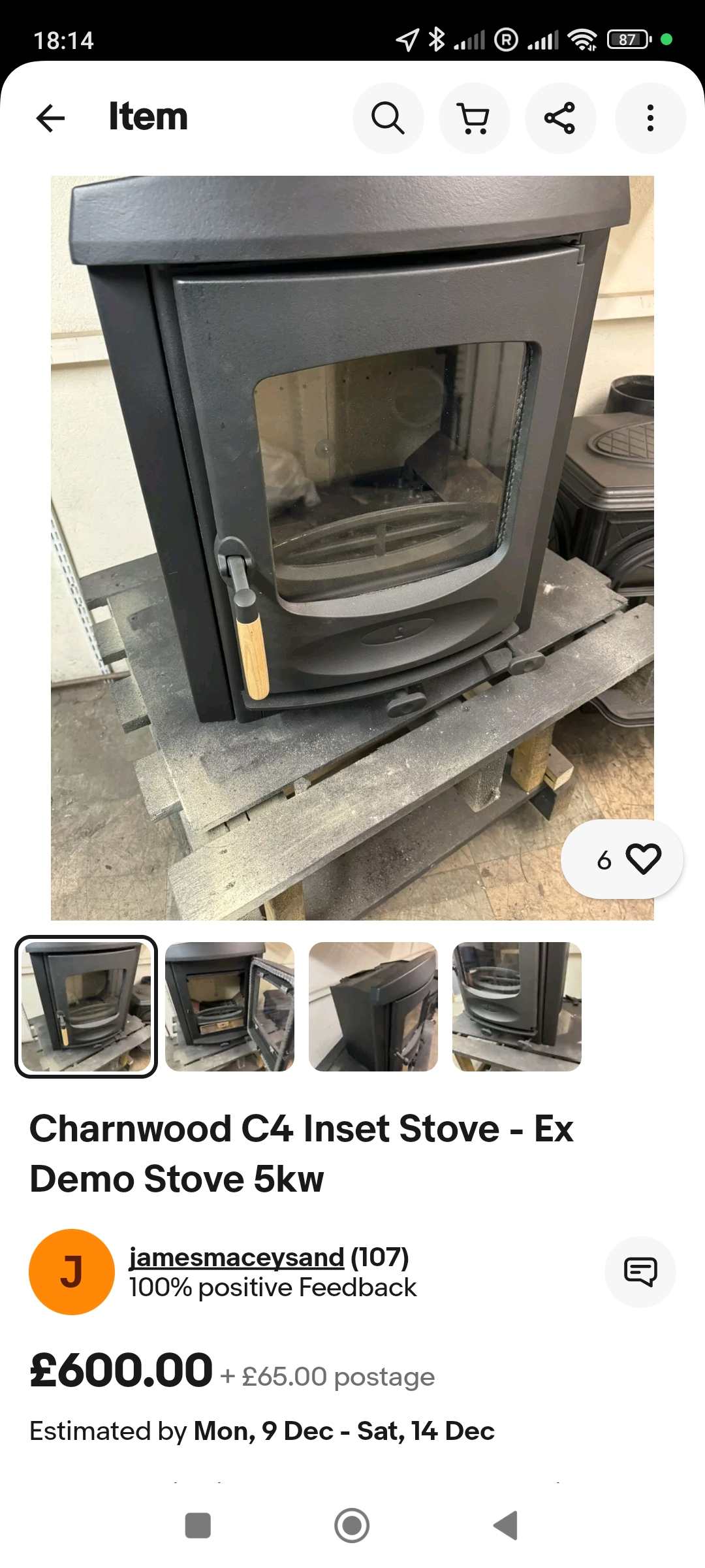

Sam odell Posted December 6, 2024 Author Posted December 6, 2024 Does this look good?? better than the ones above??
G and J Posted December 6, 2024 Posted December 6, 2024 We have always had Clearview, but their designs are more suited to traditional, so we are planning a Charnwood in our new place, not this stove but the build quality of Charnwood is good........ Chk on the photos that new rope has been fitted behind the door and inside looks good (ideally new fire bricks) Last thing is your fitter happy to fit a stove he's not supplying?

Iceverge Posted December 6, 2024 Posted December 6, 2024 On 06/12/2024 at 09:13, Sam odell said: Does this look good?? better than the ones above?? Expand Go and poke at it in person. Check the condition of the seals bricks etc. Roughly in what corner of the country are you and I might have a scan of eBay in a while for something suitable.
