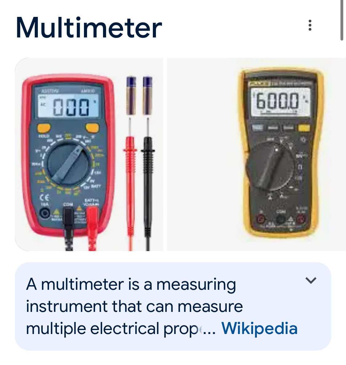

JohnMo Posted December 8, 2024 Share Posted December 8, 2024 12 minutes ago, Omnibuswoman said: How do I check this? Multi meter? Link to comment Share on other sites More sharing options...
Omnibuswoman Posted December 8, 2024 Author Share Posted December 8, 2024 (edited) 34 minutes ago, JohnMo said: Multi meter? where do I place the probes?? Edited December 8, 2024 by Omnibuswoman Link to comment Share on other sites More sharing options...
G and J Posted December 8, 2024 Share Posted December 8, 2024 https://www.amazon.co.uk/ULTRICSÂ-Digital-Multimeter-Voltmeter-Ammeter/dp/B00TM0W8ZY/ref=sr_1_8?crid=2UE6HDXZIW6UV&dib=eyJ2IjoiMSJ9.GMoWxDsdxB9y2TrsYb5yPLNSR4dxqPPmAUDWFYk6KUQhFXkMt0BWaSL6Dk6hgLuGhfBly3GQQM1O7z3VqjYIlQ2CTDiDJ8PJvwjIhMM4roAqEEV7mYxFFFeg5mlgqtW40EsyiwATzNrFbj3Zc6fArKiqmp5fT77T5xmooA00yOEHi-tTE_UWBPVViRgI8xjO6fr-UbGt_TIXqJhiNIOaRtlkMA4Jqm45p8THswYH66YjBaqKw053BSWg0aBUKNeFYPUazagXmAMfTF7DVdVNnlPkDXPhnz9VM4JMSKQOyI0.d_GY3pwfwwqEi0bQQY4LpzXiFHqhWFsaRStjEGBXgvE&dib_tag=se&keywords=Multimeter&qid=1733659034&sprefix=multimter%2Caps%2C141&sr=8-8 would be an example. The picture even shows it set to the setting you will need. But please be careful. Or, [good idea alert!] having identified that your inverter is not operating correctly you can get the company in to honour their warranty (but a meter is a useful thing to have around). 1 Link to comment Share on other sites More sharing options...

Dillsue Posted December 8, 2024 Share Posted December 8, 2024 3 hours ago, Omnibuswoman said: How do I check this? Get someone who's familiar with doing this to show you where to measure, where to put the probes and which range to select. There's a fair chance of exposed bus bars behind the cover with 400vac on them that have got the potential to kill you and/or spoil your xmas. Link to comment Share on other sites More sharing options...
