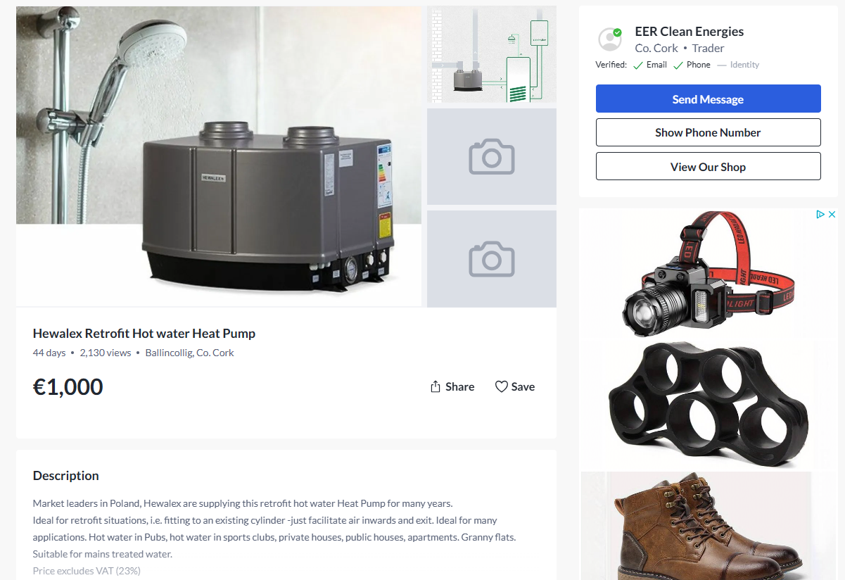

You can get a stand alone heat pump just for DHW too. I've been pondering this. to see if it will reduce our €400/year DHW bill for about 3500kWh at a TOU tariff of 12c.
For a capital cost of €1,230 plus bits and pieces and fittings, say €1500 DIY cost. At a COP of 2.5 it would reduce the kWh usage to 1400kWh. However due to the lower storage temperatues I reckon half the heat imput would need to be done at the more expensive daytime rate of 26c/kWh.
So 700kWh@12c + 700 kWh@26c = €266 per year. A saving of €134 per year.
A payback of about 11 years assuming it doesn't break.
I think I'll keep my money in my pocket.
