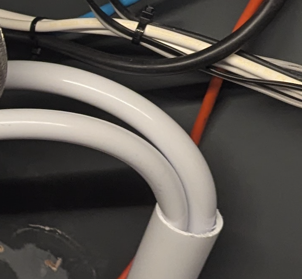

puntloos Posted November 27 Share Posted November 27 The softener I picked (somewhat arbitrarily I admit) is the Monarch Midi HE - https://www.bathquest.co.uk/Monarch-Midi-HE (manual) In the manual it says: "Under no circumstances should the softener drain and overflow share the same pipe. This could lead to foul smells entering the salt cabinet from the main drain via the overflow. Also if the common drain ever gets blocked, the regen water can re-enter the softener via the overflow pipe." And, in my house this is how the plumber has done it: So.. yeah. My questions: 1/ How can 'smells' can really come in, let alone affect the water? And importantly, can we not install eg a one-way valve on this drain to avoid such smells? 2/ It doesn't sound _great_ that regen water comes into the softened water, but presumably that's just brine water, so while uh, drinking super salt water in that eventuality is not ideal it sounds like a one off... 3/ The drain they installed, ok it is one pipe, but even if you would make two pipes, surely at some point those have to come together into the same drain? Or are they expecting me to route the two pipes to different drains somehow? Doesn't sound realistic.. Basically, I don't want to be too difficult to my plumber, but just want to figure out how to handle this. Link to comment Share on other sites More sharing options...
Kelvin Posted November 27 Share Posted November 27 (edited) My overflow wasn’t even connected. Ask me how I know. It doesn’t mean two separate drains it just means two separate connections (like your dishwasher and washing machine) My softener and nitrite treatment overflows via a pipe into the dog bath. Edited November 27 by Kelvin Link to comment Share on other sites More sharing options...

puntloos Posted November 27 Author Share Posted November 27 7 hours ago, Kelvin said: My overflow wasn’t even connected. Ask me how I know. Ah that sounds like a fun story.. but ok, won't ask. 7 hours ago, Kelvin said: It doesn’t mean two separate drains it just means two separate connections (like your dishwasher and washing machine) My softener and nitrite treatment overflows via a pipe into the dog bath. OK so the picture I showed is "too common", but having two pipes that at some point down the line join is better somehow? Sorry I'm not a plumber so I don't exactly know when there is 'sufficient separation'? Does that mean, for example, that the lines have to run at least - some distance (2m? 3?) by themselves, or the lines have to have a drop of something? (5cm? 10?) by themselves? Link to comment Share on other sites More sharing options...

sharpener Posted November 27 Share Posted November 27 (edited) AIUI the regen flow to waste might be able to withstand some back pressure. There is a washing machine waste standpipe fitting which is designed as a clamp-on tee connection to an existing 50mm kitchen waste, and incorporates a non-return valve. That might work for the regen waste. Otherwise used a U-bend trap or take it to a trapped drain then there will be no smell. The overflow by the sound of it will not tolerate any back pressure so should go out through the wall to a safe but visible overflow location e.g. above a porous surface or a surface water drain. IME the "Hotun" combined tundish and waterless trap is NBG, it requires quite some flow to open the valve (even though the spring is so light it does not shut the valve reliably) and overflows onto the floor at only slightly more flow. Hep2O type of waterless bladder trap not much better, a lot of back pressure is required to open the bladder, to the extent it backs up to my UVC tundish. Edited November 27 by sharpener Link to comment Share on other sites More sharing options...

joth Posted Friday at 12:12 Share Posted Friday at 12:12 21 hours ago, puntloos said: One thing I was thinking of is asking to install a one-way valve on these outputs? Would that solve some/most of this issue? You can't use a double check valve or similar as there's not guaranteed to be enough pressure in an overflow situation to open it. Drains normal stop back flow using gravity, that's essentially what the standpipe is for in your setup, and in a washing machine outlet, and the tundish mentioned above is essential the same idea. The problem is water softeners don't have much vertical drop hence the very crammed standpipe and risk of it filling up and syphoning back. Our softener is installed on a meter high pedestal to give more drop Link to comment Share on other sites More sharing options...
