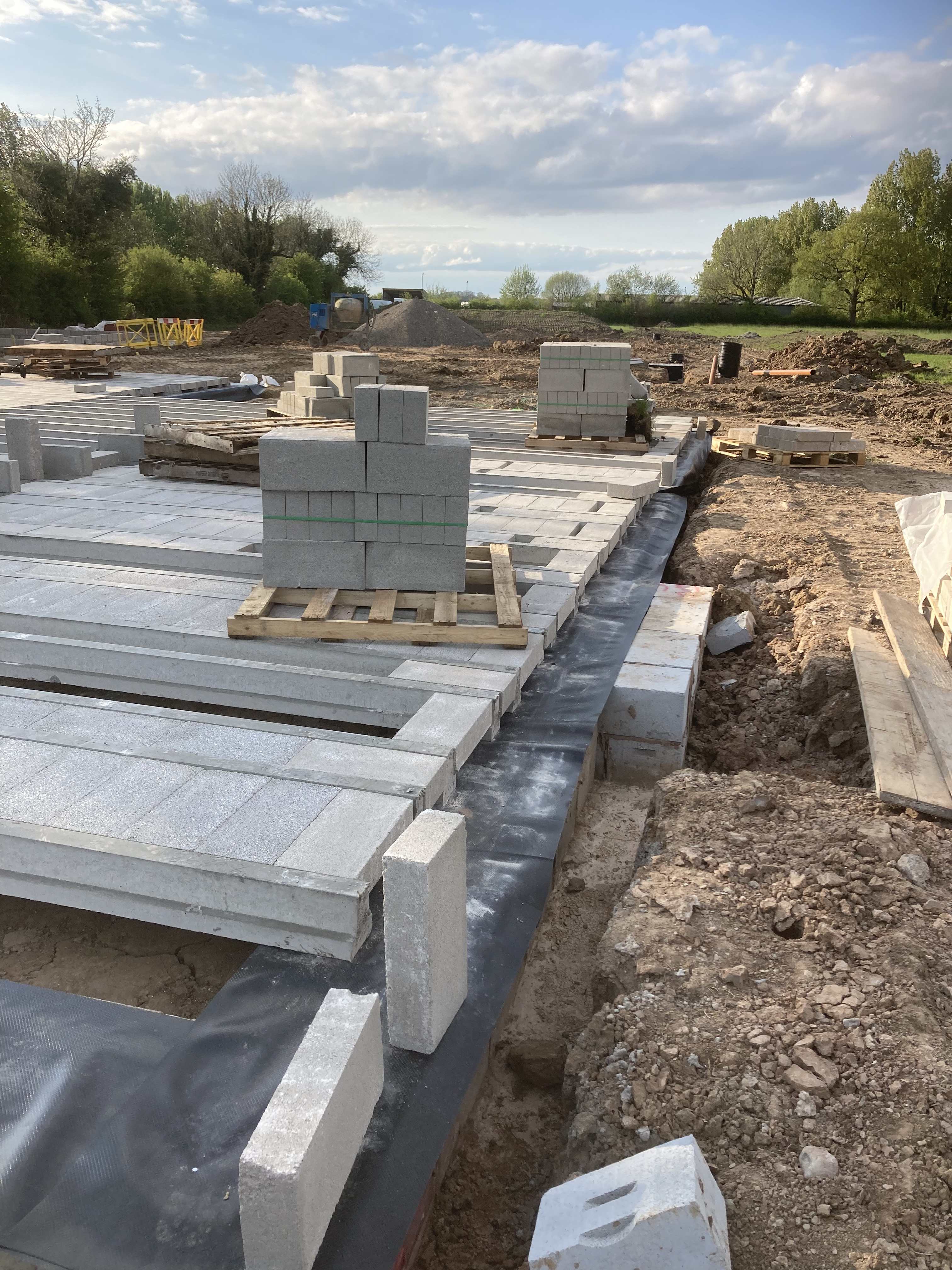

Tony L Posted November 22, 2024 Share Posted November 22, 2024 Does this look OK? I don't understand how it's going to work. Link to comment Share on other sites More sharing options...

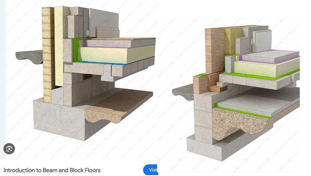

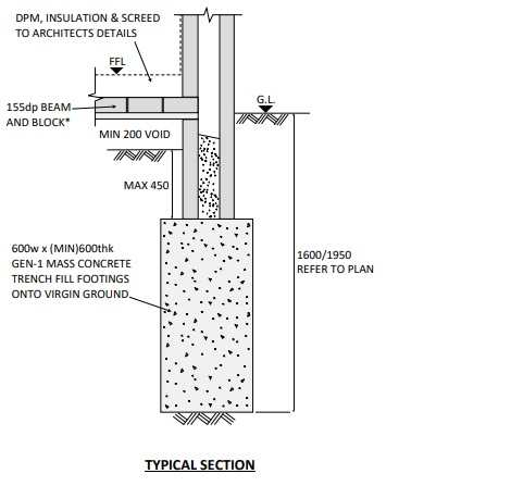

Tony L Posted November 22, 2024 Author Share Posted November 22, 2024 What's built doesn't match the drawings the builder is working from (which I did understand). See below Link to comment Share on other sites More sharing options...
Tony L Posted November 22, 2024 Author Share Posted November 22, 2024 & what’s been built doesn’t match any of the diagrams I see on the internet, which mostly have a gap beneath the insulation to help any water in the cavity drop down onto a slope that directs it to the outer leaf. The drawings the builder is working from show beams sitting on DPC on the inner leaf of a cavity wall. I can see this makes sense, because any water inside the cavity wall will drop down beyond the beams. With the arrangement that’s been built, any water in the cavity could pool right next to the beam & as soon as it’s 2mm deep it will be over the top of the DPM & onto the beam. He told me he was going to put a tray in, but it seems to me this tray will not be in the best possible position. & if there’s a tray sloping to the outside wall, doesn’t that mean there will be no insulation against the B&B floor? Air bricks: All the diagrams I see have the inner vent of the periscope lower than the beams – it doesn’t look like that’s what my builder is planning to do. The outer skin of the house will be rendered blocks. The builder knows we want standard size black bricks, beneath the render, going into the ground. Presumably, he’s intending to lay 2+ courses of black bricks on top of the edge of the trench blocks then build up the ground so we can’t see where the black bricks meet the blocks beneath ground level. I think there will be damp coming through from the ground & into the trench blocks the beams are sitting on. Does this matter? This (below) is much closer to what I was expecting: Link to comment Share on other sites More sharing options...
nod Posted November 22, 2024 Share Posted November 22, 2024 Looks fine Link to comment Share on other sites More sharing options...
Russell griffiths Posted November 22, 2024 Share Posted November 22, 2024 (edited) I think because your build method has changed you need to stop work for a couple of days and get a few drawings done, they only need to be sketches, but it will give the builder the chance to explain what he proposes, it will give you chance to come on here and show us, and it will give you chance to understand how it will all tie together. those two pictures you put up. the second one with the green damp proof membrane is exactly what you have. he’s not put the dolly blocks in the gaps below the blocks to cap the ends off yet and the end row of blocks are not in, but that’s pretty much what you have. your trench blocks will be underground and will always be wet, that’s pretty standard. Edited November 22, 2024 by Russell griffiths Link to comment Share on other sites More sharing options...

Oz07 Posted November 23, 2024 Share Posted November 23, 2024 Ive had them sit like this before. I used a wider dpc though, then folded it up the ends of the blocks and taped it to the dpc ontop of b&b. Then I had a small bit of concrete in the cavity directing water outwards. Im not sure how effective the concrete is, i wanted it more to stop the ground pushing the external leaf inwards. I dont think drainage for water underneath the floor is a standard detail. Maybe only on waterlogged or high water table sites. You don't see it on any of the big sites round here. Obviously you need drains for internal stacks but this could have them coming out external walls? Link to comment Share on other sites More sharing options...
Tony L Posted November 24, 2024 Author Share Posted November 24, 2024 Thanks, @nod, that's reassuring. @Russell griffiths. Thanks for the suggestion. I don't think it's a good idea to tell the builder to stop work for a couple of days & pay his team to do nothing, or if they have another job to go to, they may lose momentum on my job. I don't want him to start thinking I'm being unreasonable, even though he has disappointed me. Drainage is around the other side from where the pictures were taken. It's good to learn the bits that are missing are called "dolly blocks". I will ask him about these. @Oz07. Thanks. I guess wrapping the DPC back over the beams isn't an option for me because my air bricks are going to have to go in between the beams. I was expecting them to be lower, but I don't suppose it matters. I know some beams have exposed steel bars showing at the ends & I'd probably have sprayed bitumen on the ends if this had been the case for mine, but all I see is concrete. Link to comment Share on other sites More sharing options...

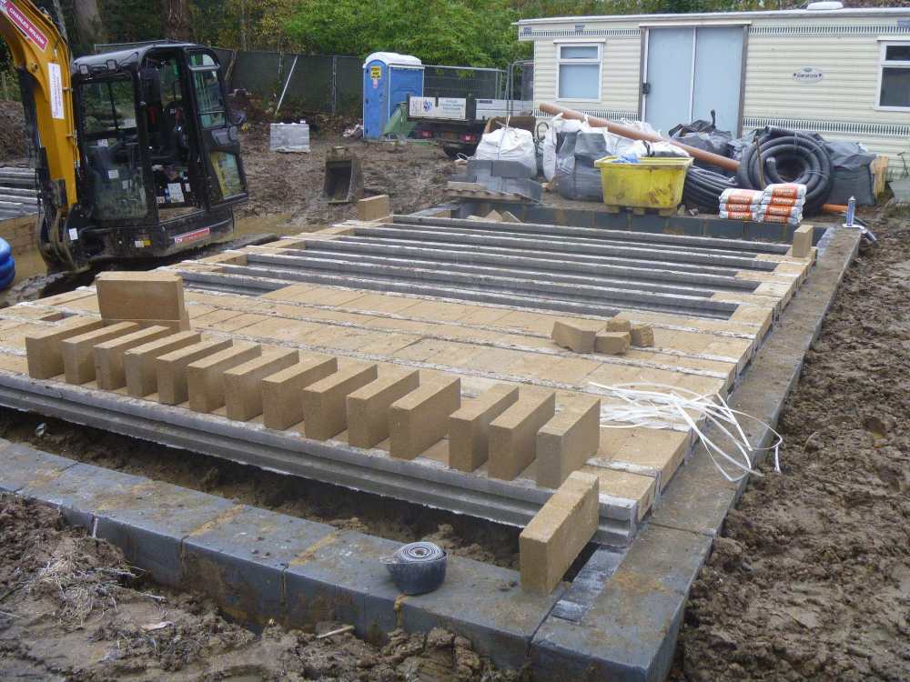

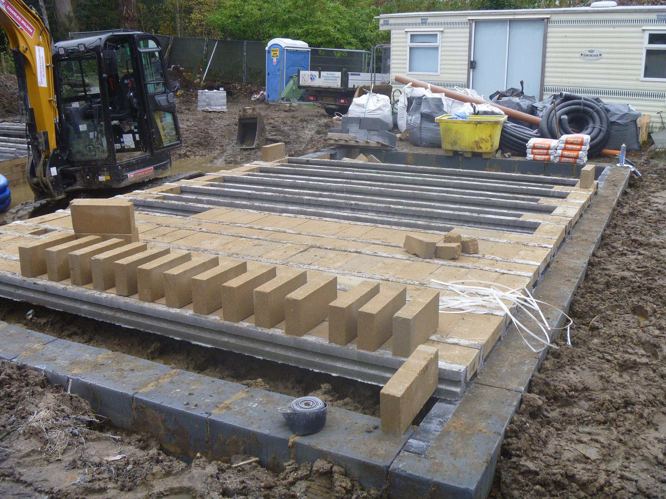

nod Posted November 24, 2024 Share Posted November 24, 2024 This is how I did ours Folded the dpc up over the ends to cover the the The periscopes simply slip down behind and then connect to your air bricks Link to comment Share on other sites More sharing options...
Tony L Posted November 24, 2024 Author Share Posted November 24, 2024 Thanks, @nod. I can see that's a better way of doing it, but as this wasn't specified in the brief he quoted on, I'm not going to be able to tell him to take the blocks out, lift the beam ends & use wider DPC, unless I want to pay for it, or do it myself - which I'd probably enjoy doing, if I didn't have a business to run. He told me, he'd told the BCO this is what he was going to do, & the BCO was OK with it. Link to comment Share on other sites More sharing options...
