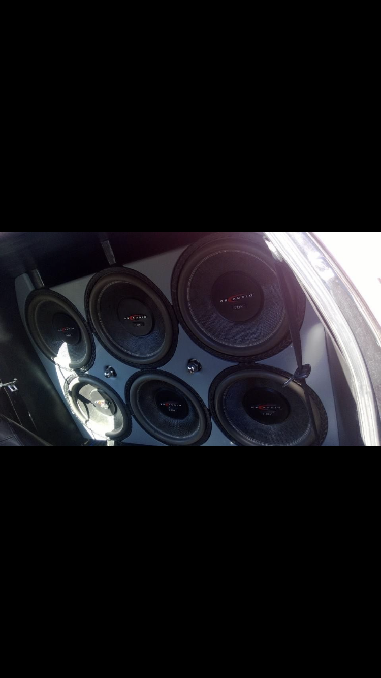

nod Posted November 20, 2024 Posted November 20, 2024 (edited) On 20/11/2024 at 13:08, nod said: If you like your music You won’t get the low pitch mono without a sub Unless your stuck for space Id alway add at least one sub Expand One of my sons builds (car install) 6x15” Edited November 20, 2024 by nod
