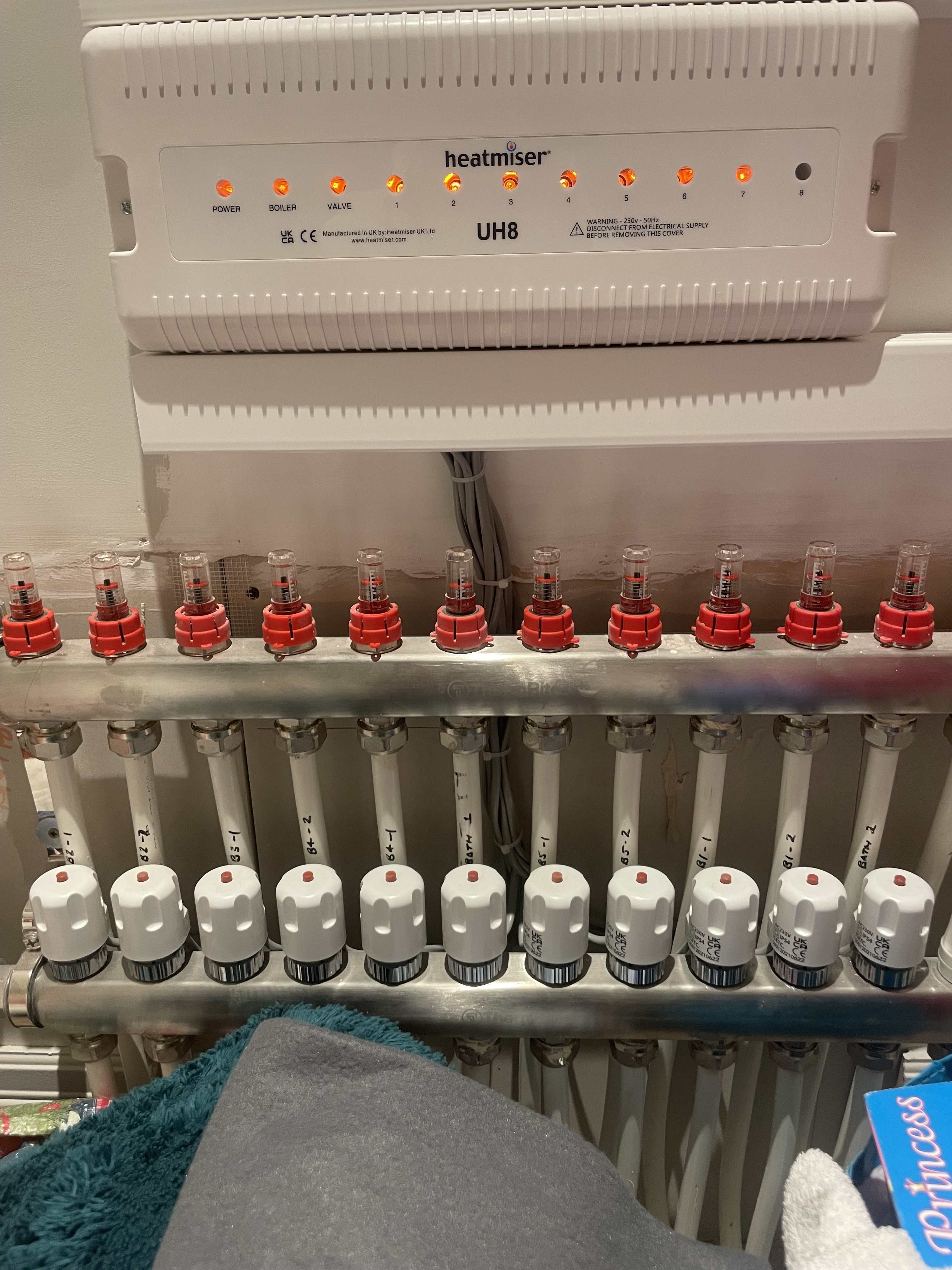

richo106 Posted November 20, 2024 Share Posted November 20, 2024 Hi All I have jumped on a previous thread but thought I would start a seperate one as I need some help/advice on an issue I think I have I have UFH upstairs and downstairs, downstairs in a concrete slab and upstairs in aluminium spreader plates below 22mm T&G floorboards. I have an ASHP with 100L buffer (set at 35deg). I have been running the ASHP hot water and heating in line with the octopus cosy tariff and has worked well like this, I know it wouldn't run like this when we hit cold snaps like now so my plan was to just leave it on and ticking over. The GF seems to be working well and the floor warms up nicely and all the rooms easily reach the temperature but the upstairs rooms are struggling a bit to get to there set point I was looking at the GF manifold and the water temp in was 30 deg and return temp was 23 deg However the first floor manifold was slightly different as the flow and return temperature was same (both 26 deg at 9pm, both 30 deg at 11pm) I have a common pump that does both manifolds I am after any kind of advice/information on this potential issue as there seems to be no heat transfer and the upstairs struggling to heat up. It all looks there is flows on the indicators I have ran this all night and still no difference in flow temps this morning Thanks in advance Link to comment Share on other sites More sharing options...
Super_Paulie Posted November 20, 2024 Share Posted November 20, 2024 so you have flow but the Δt is 0... im not sure how that would be possible. Have you tried removing the actuators from those loops and just running them open to see if its actually flowing, is there any warmth at all? Link to comment Share on other sites More sharing options...
ProDave Posted November 20, 2024 Share Posted November 20, 2024 That is a recent (post Brexit) install so are we to assume a new house or is it a retrofit to an old house? Are bedrooms carpeted? If so lift a carpet if you can ans I bet it is cosy warm underneath and the heat is just not getting through the carpet fast enough, hence the floor is heated up to flow temperature giving the low Dt but the heat is not getting into the rooms quick enough. If so higher flow temperature, or thinner carpets is the answer. As a sanity check, turn the upstairs heating off. Let it all cool down, say over night, then when you first turn it on, I bet you will see a Dt between flow and return while it heats up the spreader plates and the floor. Our previous house had UFH and carpets upstairs and we ran that at 40 degrees flow on the upstairs UFH and lower on the downstairs with solid floors. Link to comment Share on other sites More sharing options...
richo106 Posted November 20, 2024 Author Share Posted November 20, 2024 12 minutes ago, Super_Paulie said: so you have flow but the Δt is 0... im not sure how that would be possible. Have you tried removing the actuators from those loops and just running them open to see if its actually flowing, is there any warmth at all? Daft question...if i take the actuators off will the loops just be open? I will do this later when i get home Link to comment Share on other sites More sharing options...
richo106 Posted November 20, 2024 Author Share Posted November 20, 2024 6 minutes ago, ProDave said: That is a recent (post Brexit) install so are we to assume a new house or is it a retrofit to an old house? Are bedrooms carpeted? If so lift a carpet if you can ans I bet it is cosy warm underneath and the heat is just not getting through the carpet fast enough, hence the floor is heated up to flow temperature giving the low Dt but the heat is not getting into the rooms quick enough. If so higher flow temperature, or thinner carpets is the answer. As a sanity check, turn the upstairs heating off. Let it all cool down, say over night, then when you first turn it on, I bet you will see a Dt between flow and return while it heats up the spreader plates and the floor. Our previous house had UFH and carpets upstairs and we ran that at 40 degrees flow on the upstairs UFH and lower on the downstairs with solid floors. Its a new build Yes all bedrooms are carpeted but they are specific UFH underlay and carpets The bathroom is tiled and the tiles still feel cold! Regarding turning it off, I would expect to see Dt yesterday evening as the upstairs floor was pretty cold I will try remove the actuators as mentioned above, i have one area of floor (another bathroom) with no flooring yet apart from the T&G flooring so ill see if there is any warm there If not I will try upping the temp to 40 to see if this makes a difference too Many Thanks Link to comment Share on other sites More sharing options...

richo106 Posted November 20, 2024 Author Share Posted November 20, 2024 It looks like the actuators are working correctly, when I opened a few zones upstairs there was a slight temp difference in flow and return temps to start with but soon gets back to almost the same ill change my water temp to 40 to see if that makes a difference at all Link to comment Share on other sites More sharing options...

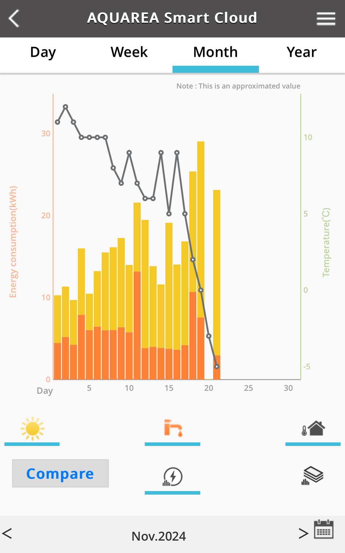

richo106 Posted November 21, 2024 Author Share Posted November 21, 2024 Hi @JohnMo Thank you very much for both replies regarding the energy usage and cosy tariff Regarding the cosy tariff I think it works well in the summer months so I can just do my DHW during the cheaper periods, also it has worked well from Sept to around now with just a little bit of heat required to maintain a nice temperature However in the winter months I going to run it 24/7 (with it ramping down during expensive period) I can also still programme it re-heat my DHW during the cheaper periods It will be interesting to monitor the energy usage during the milder days, as mentioned this is first time using a system like this so I am learning on the job I have attached my energy usage from my ASHP for the month so far and its pretty much spot on with what you said regarding the amount of energy quoted - quite a clear correlation with outside energy temps! Link to comment Share on other sites More sharing options...
