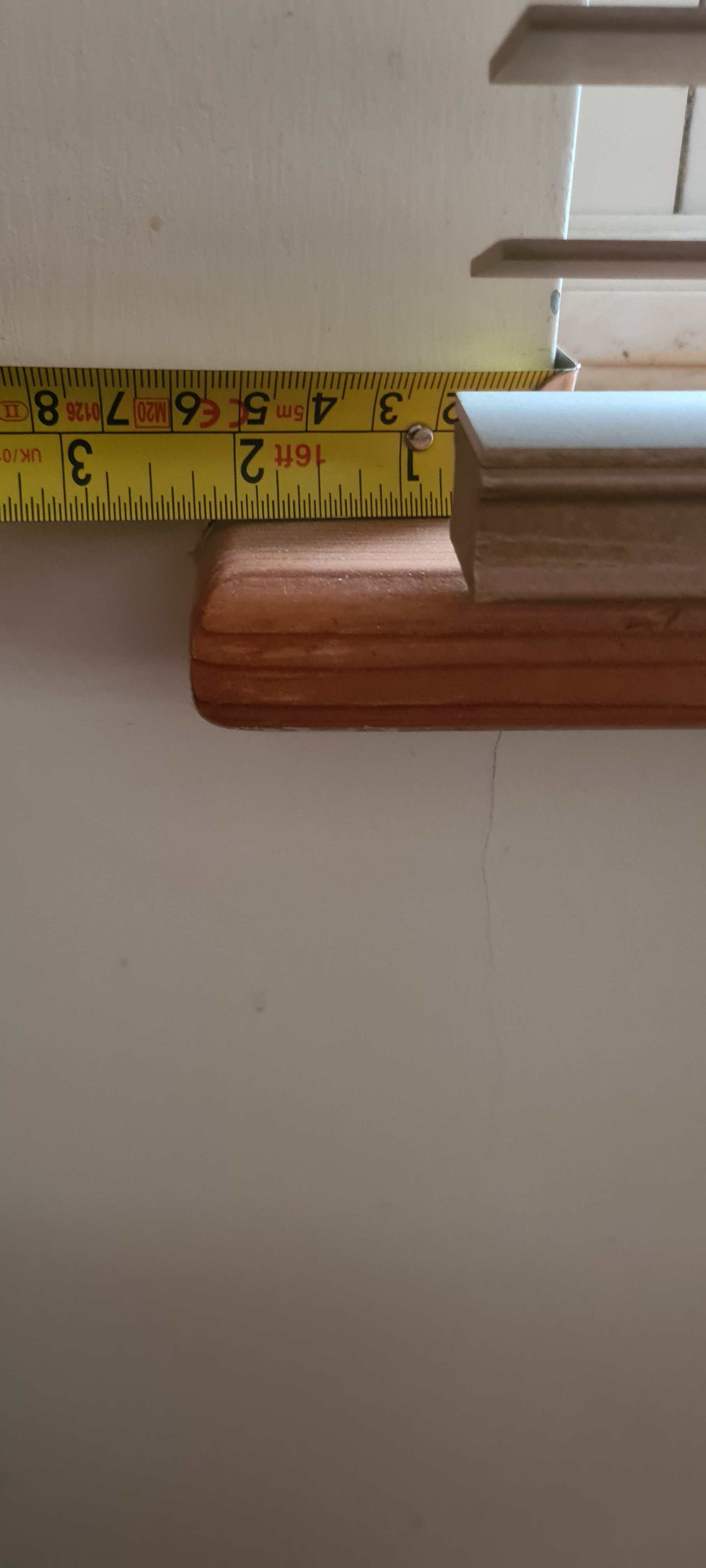

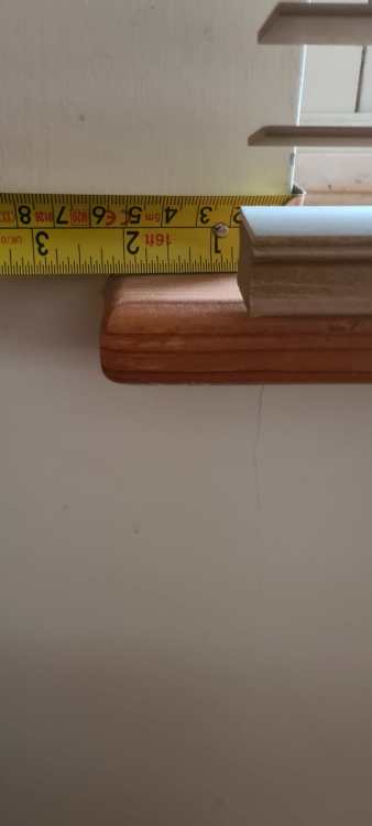

Barnboy Posted November 18, 2024 Posted November 18, 2024 (edited) I dont know if this should be in here or the plastering topic so sorry if I'm in the wrong group. My plasterer wants my oak window sills fitted before plastering but I'm not sure if where they protrude into the room, as shown in my dodgy photo, (photo is of someone else's house that I took measurments from ) should I butt the ears up to the plasterboard or notch the plasterboard so that the sill board ears slip in the recess made and slide back to the stud work ? Edited November 18, 2024 by Barnboy Photo is not of my sill boards
Chanmenie Posted November 18, 2024 Posted November 18, 2024 (edited) I cut the plasterboard so the window boards “ears” were back to the block behind the plasterboard, Slide the board in to the plasterboard, draw round the ears then cut with a multitool Edited November 18, 2024 by Chanmenie
Russell griffiths Posted November 19, 2024 Posted November 19, 2024 If it’s oak. YOU need to tape them up thoroughly don’t leave the plasterer to do it, pink plaster in the grain is impossible to remove, or get a coat of whatever you are putting on the oak, then tape them.
Alan Ambrose Posted November 19, 2024 Posted November 19, 2024 Or cover the wood entirely with plastic & tape. Also don't let anything metal near them - they'll get black patches v fast. Actually, I might be inclined to fit them after the plastering and then seal around them after.
Barnboy Posted November 20, 2024 Author Posted November 20, 2024 I will be priming the underside and non visible edges and oiling/waxing the outward faces. The plasterer has shown me his own house with the same oak and he's done a beautiful job plastering around them. Hopefully he does the same to mine. 1
Chanmenie Posted November 20, 2024 Posted November 20, 2024 14 hours ago, Barnboy said: I will be priming the underside and non visible edges and oiling/waxing the outward faces. The plasterer has shown me his own house with the same oak and he's done a beautiful job plastering around them. Hopefully he does the same to mine. Yeah some plasterers can take care. I was lucky too, my plasterer is old school he does things properly.
