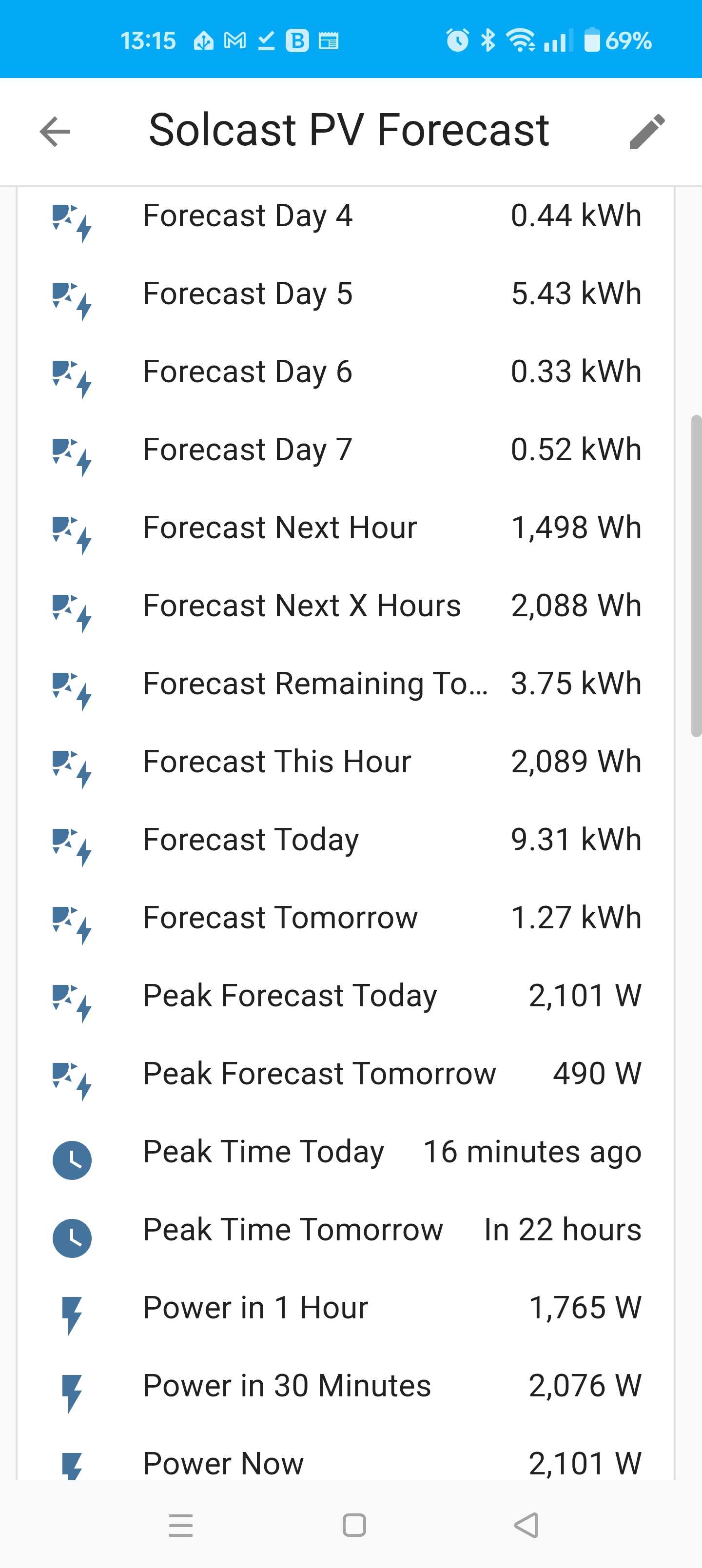

JohnMo Posted November 18, 2024 Share Posted November 18, 2024 Home assistant will track sun angles if you want, it also has integration with solar forecasting such as Solcast. So you get all this sort of information So you don't need to know really what is actually going down the wires, with CT clamps etc. Mine is currently putting 5kW into the floor and 3kW into DHW, that stops at predetermine battery SoC or 2.5 hrs before sun set which ever comes first. All software driven via home assistant. The big solid state relay does what home assistant says for the immersion, while a small Shelly relay sets the heat pump at a higher flow temp, so it will run on demand. 1 Link to comment Share on other sites More sharing options...
