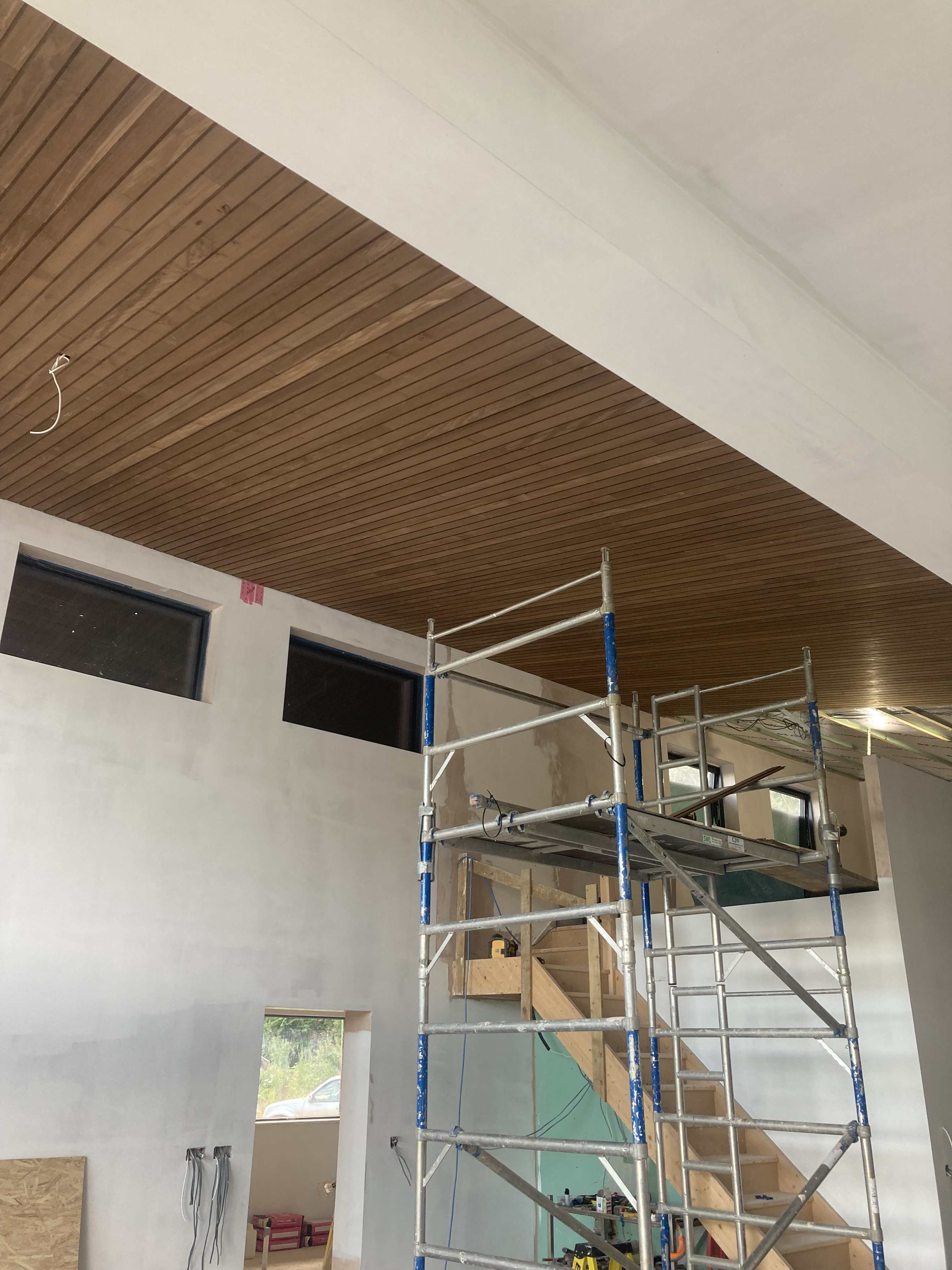

This looks fab! What sort of wood did you use? I can’t see visible fixings (looking at the pic on my phone) - how did you fix it in place. Like your scaff too!

You won’t guess the timber if I gave you 20 guesses
we wanted red cedar to match the rest of the house, this would have been about £100 a metre, had a look at a local sawmill who had loads on display, I chose this on its weight and price. You can’t be fixing oak up there the weight would just be silly.
this is poplar, that has been heat treated to preserve it, weighs absolutely nothing. Came in at half the price of cedar.
secret fixed with stainless nails in the groove so you can’t see it.
it has a trim to still go on around the edges.
Edited by Russell griffiths

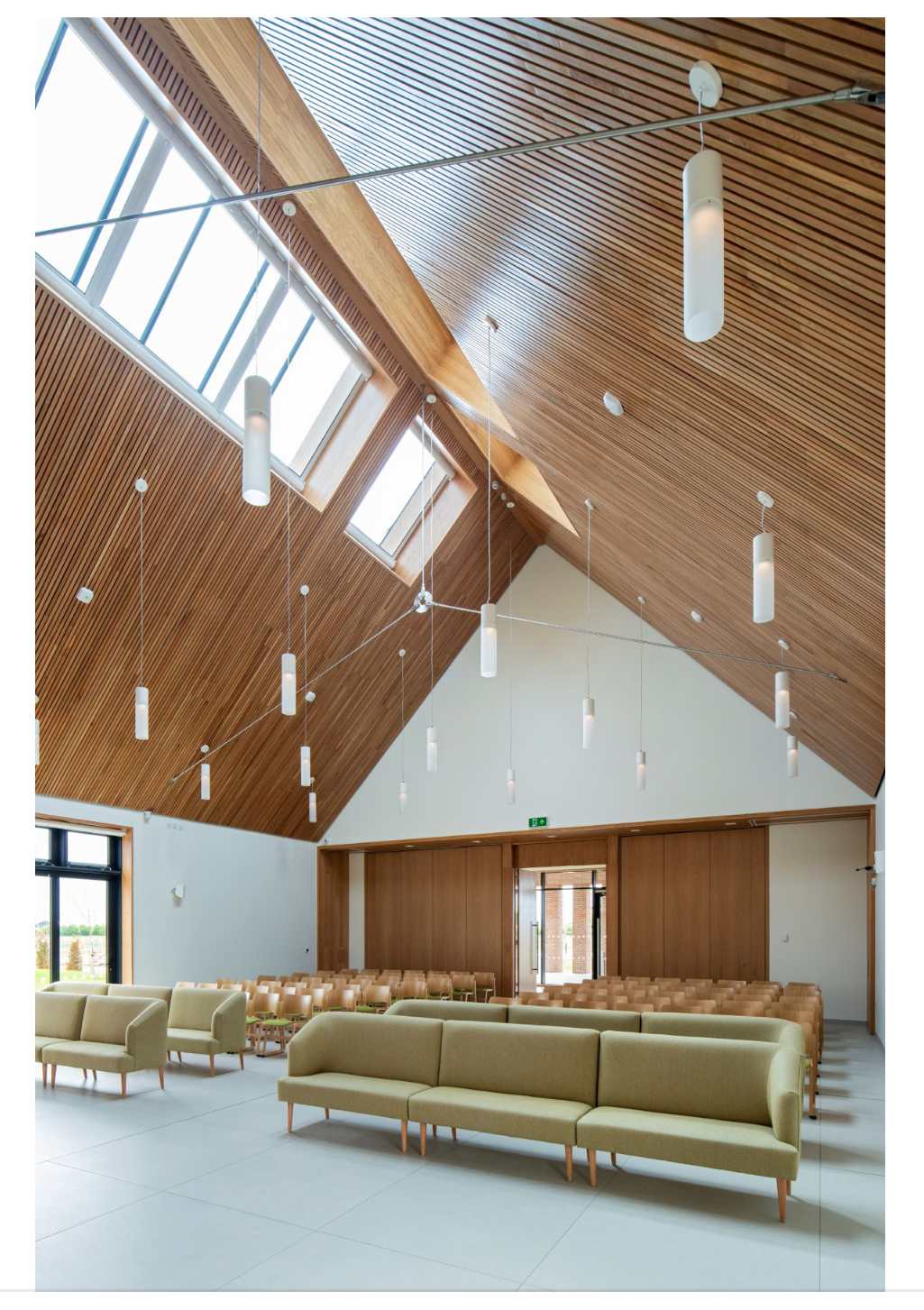

Oak CAN look great. Here’s something I did with an architect and a bespoke joinery contractor in a crematorium.
The architect gave a concept, I designed a unitised solution, and the contractor fabricated and installed.
A softwood frame with acoustic insulation within the frame, wrapped in acoustic fabric with the battens pinned to the frame in staggered lengths (uniformly so the next panel married up) and hung on a unistrut frame to shroud the building steel. Here we had composite panels forming the main roof which was cloaked in slate. The oak was treated with fire rated lacquer for spread of fire along with rated fabrics and mineral wool insulation.
I considered oak to be far to heavy for ceiling installation, but I suppose on a steeper angle maybe the weight doesn’t give the impression that it’s all hanging on the fixings.
plasterboard is heavy stuff, so I’m probably overthinking the weight side of it.

@BadgerBodgertell us more about that beautiful ceiling. What timber and dimensions, shadow gap, how was it kept straight in such long runs?

I can’t remember the precise details but I recall the battens being approx 28 x 35. The panels were made up in a workshop so I’m not exactly sure how they were kept straight but it was furniture grade timber. The subframe was a ladder frame at around 450mm centres and the battens were double pinned and made good with wax at the same centres. The battens were left the oversail by 450, 300 and 150 mm to ensure a staggered joint and those were then pinned to the next panel etc. The reveals were a veneered mdf board.
The timber was bought as soon as we got the design through which was then delivered and left to acclimate in the workshop for 3 months. This ensure we could select the most true lengths and so that we had timber from the same trees and area to ensure a uniform colouring.

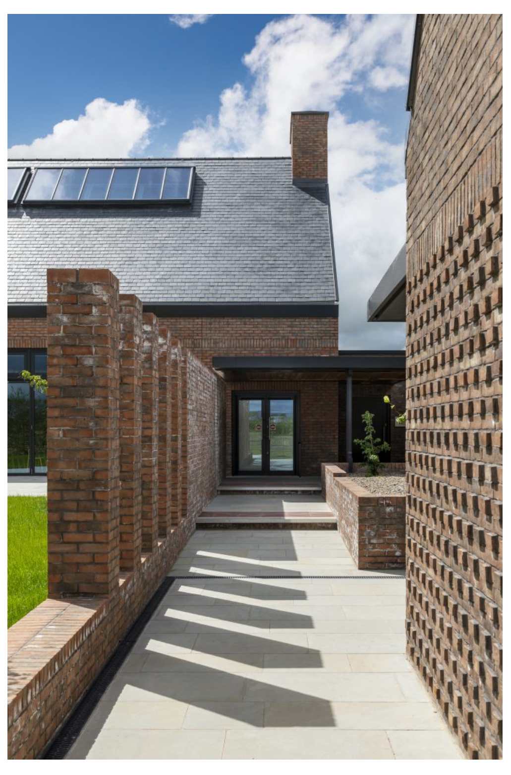

The brickwork outside was almost as impressive… the eflourescence you see on the columns has gone now.
The photos were taken professionally for Benchmark architects the lead designer. I forget who the engineers were. The project was for Hambleton district council in North Yorkshire. One of those jobs you’ll always look back on!
