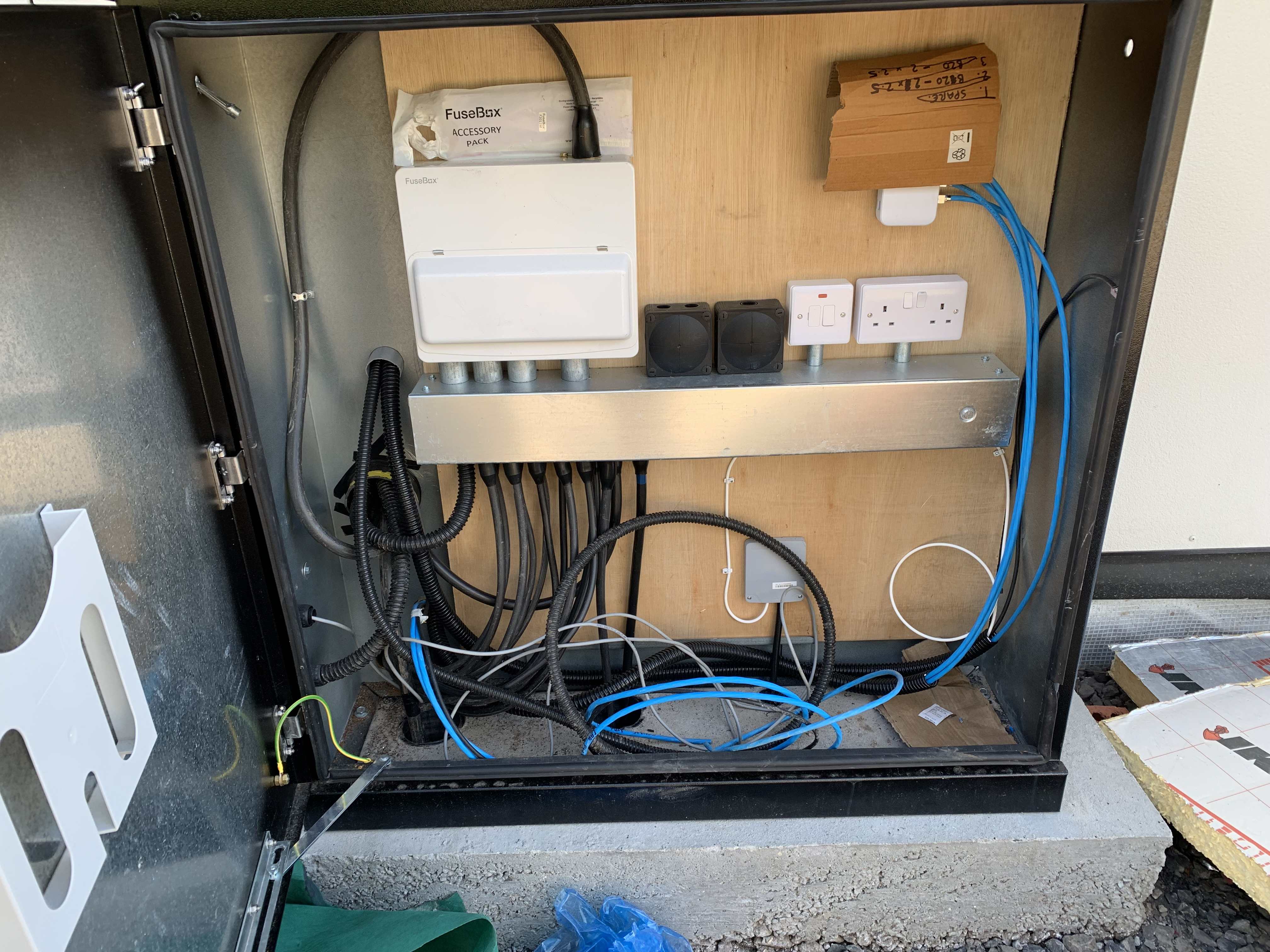

PNAmble Posted November 9 Share Posted November 9 We have the openreach box outside in a kiosk with all other external services, so that we only have one two ducts (power and data) into the airtight house. The Openreach box is the grey one. The openreach cable then goes into the plant room when it connects to the other OpenReach box. From there it connects into my data cabinet. A cat6 cable then comes back out into the kiosk (through the same duct) to a mini switch which feeds all external data requirements. Eg EVC, CcTV, Access Points. we had to use openreach provided ducting from the pavement to the kiosk. Provided FoC by Openreach. Link to comment Share on other sites More sharing options...
Russell griffiths Posted November 9 Share Posted November 9 I obviously don’t know what type and size of house you are building. but I would not take the cable inside to a cupboard unless this is going to be a dedicated service cupboard that all your cat 6 cables go back to. I’ve just had all my internet data stuff installed in the house and we are very low tech, but we still had something like 13 cat 6 cables feeding back into this area. much easier to get it all put in the dedicated plant room or where the consumer unit goes. Link to comment Share on other sites More sharing options...
PNAmble Posted November 9 Share Posted November 9 4 minutes ago, Russell griffiths said: much easier to get it all put in the dedicated plant room or where the consumer unit goes Totally agree. Somethings are best hard wired. Also don’t rely on the providers router wifi. These are always rubbish. Hardwired dedicated access points are much more reliable. As it’s a new build it’s easy to do it. We went cat6a which was probably overkill and they are a bugger to terminate and bend. Link to comment Share on other sites More sharing options...
