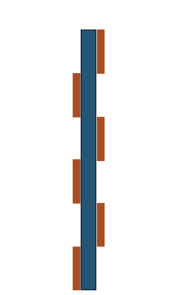

Bancroft Posted Wednesday at 12:08 Share Posted Wednesday at 12:08 50 x 25 seems a very 'square' section for fencing - is there a particular reason for using that? Going to take a lot of fixings! Also, wider slats would reduce any bowing and thus remove the need for intermediate support. Wood tends to expand across the grain so two thoughts on this: You shouldn't need to leave expansion joints at the end as expansion lengthways over 1.8 metres should be minimal. 50mm across the width shouldn't create massive expansion but if you're only leaving a 8mm gap then that expansion might be noticeable if one timber decides to expand down and the adjacent one expands up. To be honest, though, probably only noticeable to the person who fits it (ie you!) No experience of the privacy screening fabric but I'd imagine it will decay/split well before the fence needs replacing. Also, I presume the privacy screening fabric must be on the outer side of the fence (if you get the shadow effect from your garden) which must make the outside look just like a wall of black fabric? We're looking at a similar style of fence but using wider timbers alternately attached to each side of the post. This should allow wind through but still create a visual barrier - plus allow plants to grow both sides of the fence at the same time. 1 Link to comment Share on other sites More sharing options...
ProDave Posted Wednesday at 12:13 Share Posted Wednesday at 12:13 We did as above with 150mm by 20mm planks, either side of the posts. Plenty strong enough to space posts at 2 metres and no additional support needed for the planks. All standard stuff from fence suppliers. Planks either side of the post like that give privacy while allowing wind to pass through. 1 Link to comment Share on other sites More sharing options...

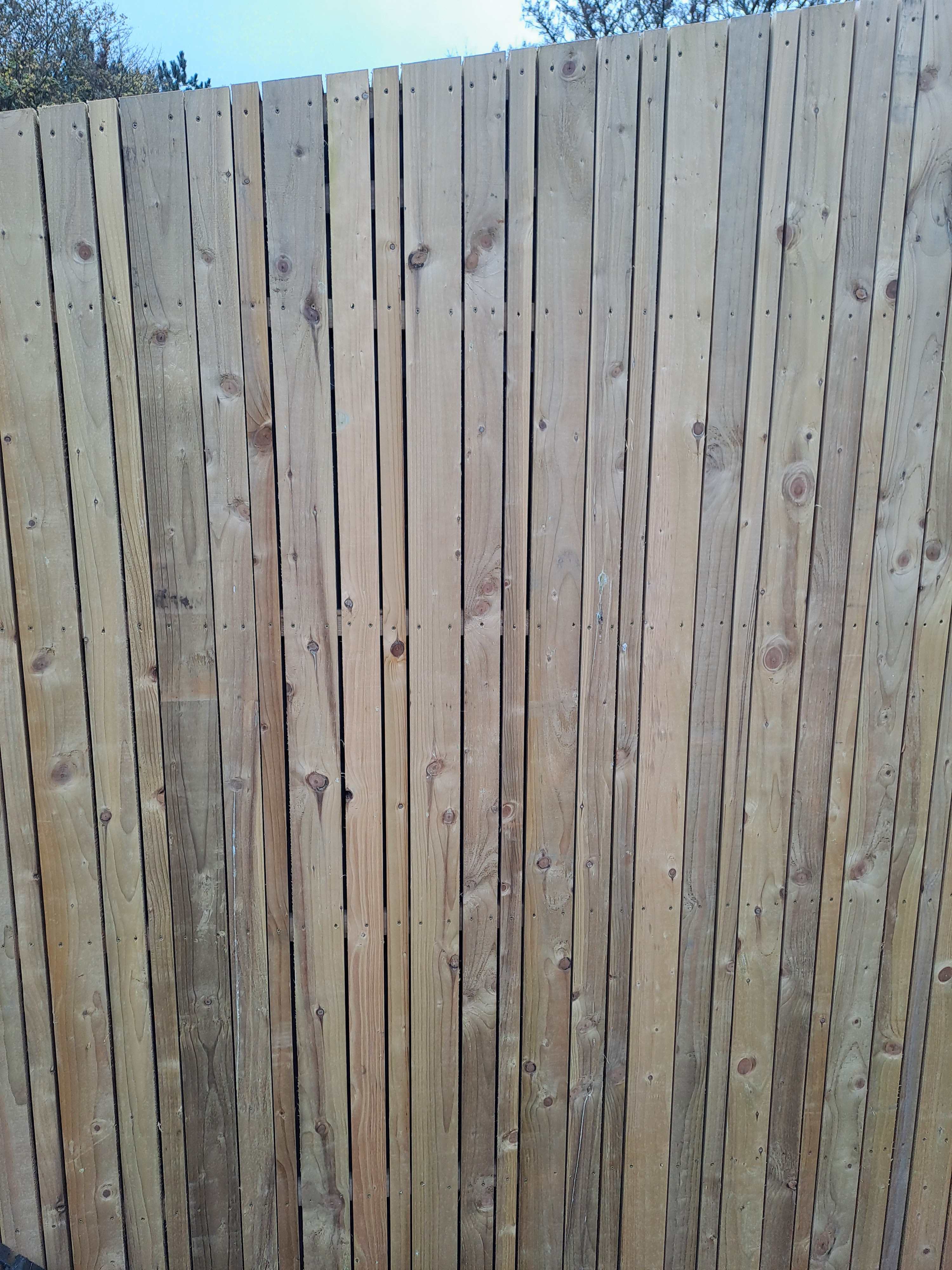

Conor Posted Wednesday at 12:13 Share Posted Wednesday at 12:13 At 8mm gaps you won't see the fabric (unless right up close and square on) so I wouldn't bother. Here's a pic of my shipping container cladding, 25, 70, and 100mm boards, with 5-8mm gaps. Theres light grey membrane behind but you can't see it. 1 Link to comment Share on other sites More sharing options...
