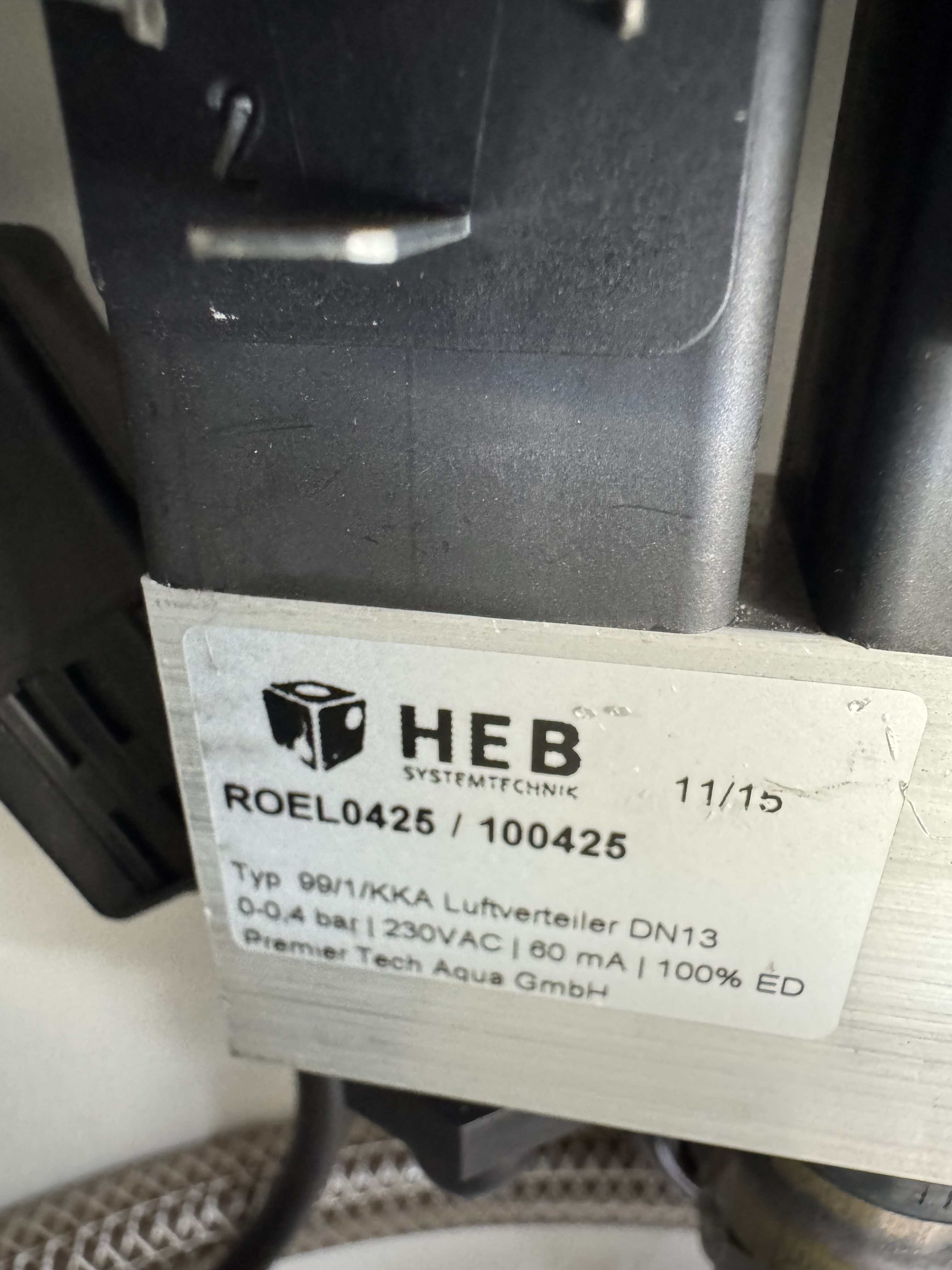

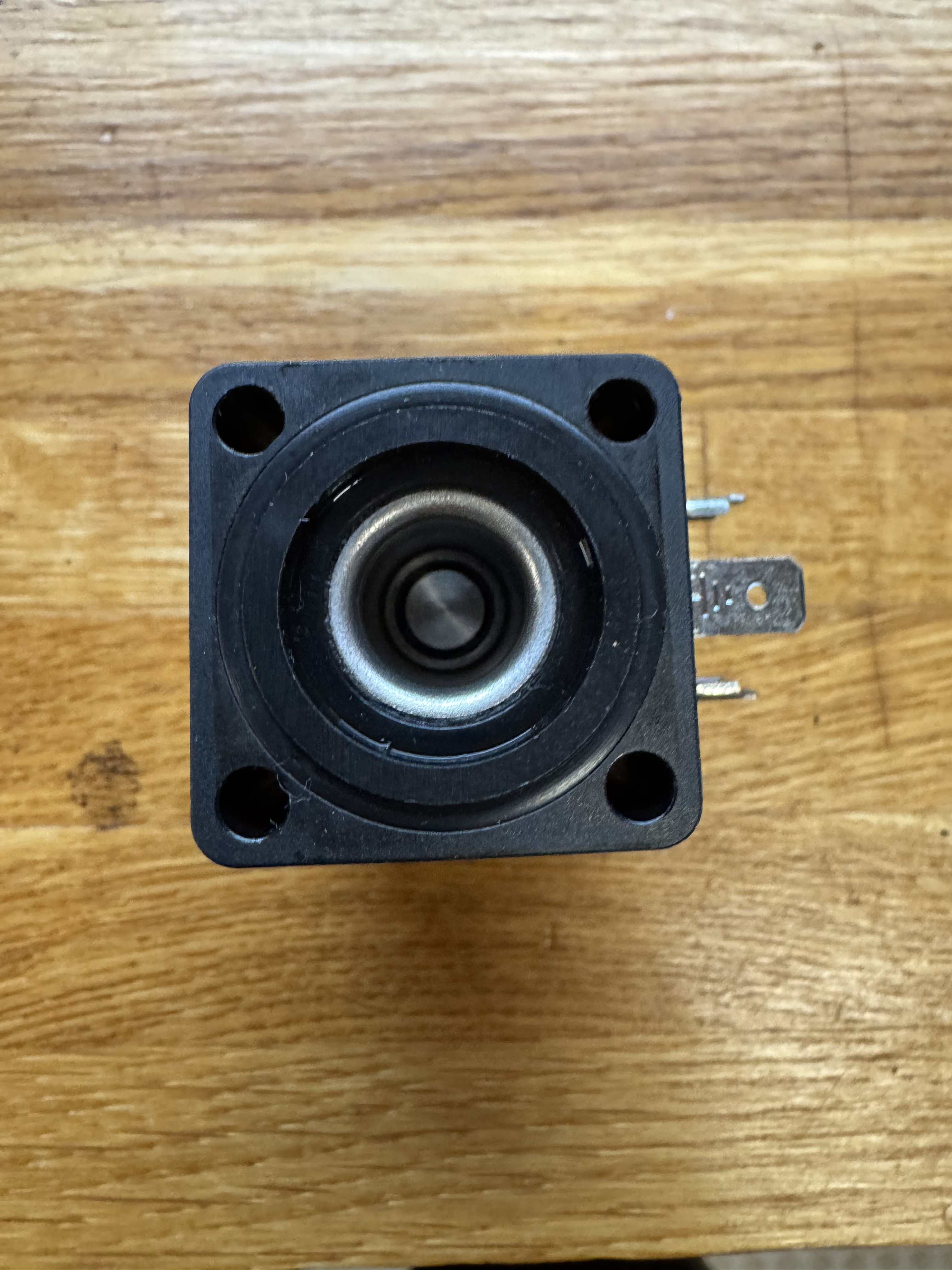

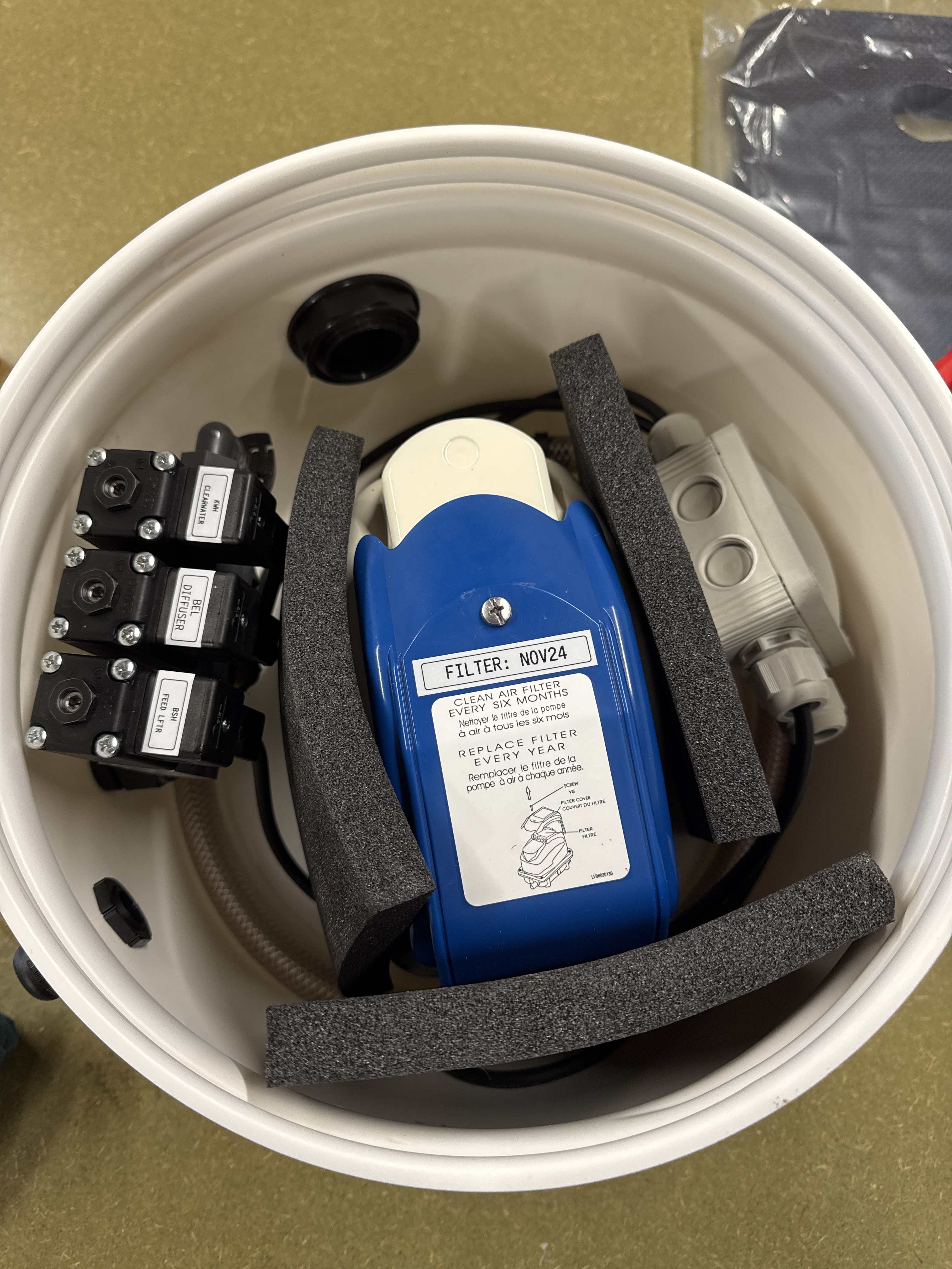

Andyh747 Posted Tuesday at 08:55 Share Posted Tuesday at 08:55 Hi all, I've had a Rewatec Solido gravity system installed since 2016 with no issues since installation. However the system stopped operating recently and I traced the fault to the blower (Hiblow XP-60). I've replaced the pump and that is now working fine. However a second fault has been identified which is a faulty solenoid coil on the air distribution manifold. I'm in contact with the manufacturer/supplier Premier Aquatech but struggling to get a replacement solenoid coil - they've changed the system and mine is an older version. A very long shot here but does anyone have any spare solenoid coils which will fit this system? I've attached a photo of the system and the coil. Before anyone asks if I've confirmed the coil is faulty I have. I tested resistance and also swapped the coils around which confirmed the coil is not working. I could use an alternative solenoid valve assembly and bypass the manifold but would prefer to just replace the faulty coil. Thanks for any help as we're currently without an operating plant. Link to comment Share on other sites More sharing options...
crooksey Posted Tuesday at 14:56 Share Posted Tuesday at 14:56 Isn't this just a normally/open closed solenoid coil? Link to comment Share on other sites More sharing options...

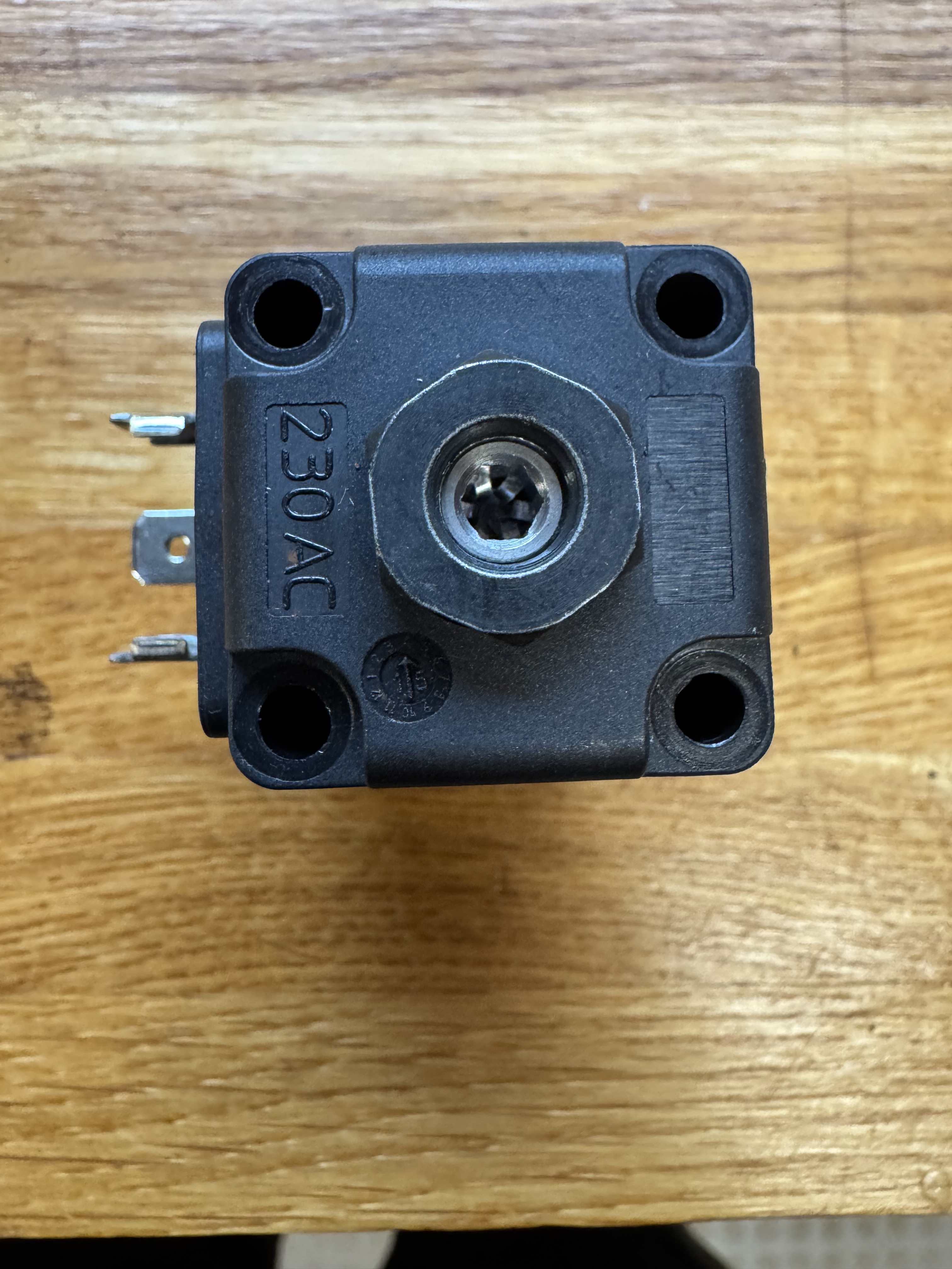

Andyh747 Posted Tuesday at 16:36 Author Share Posted Tuesday at 16:36 (edited) Yes but it is specifically designed to seal onto the manifold. There's a protruding ring on the base of the coil which seats onto the manifold. I can't find a match anywhere. Edited Tuesday at 16:37 by Andyh747 Link to comment Share on other sites More sharing options...

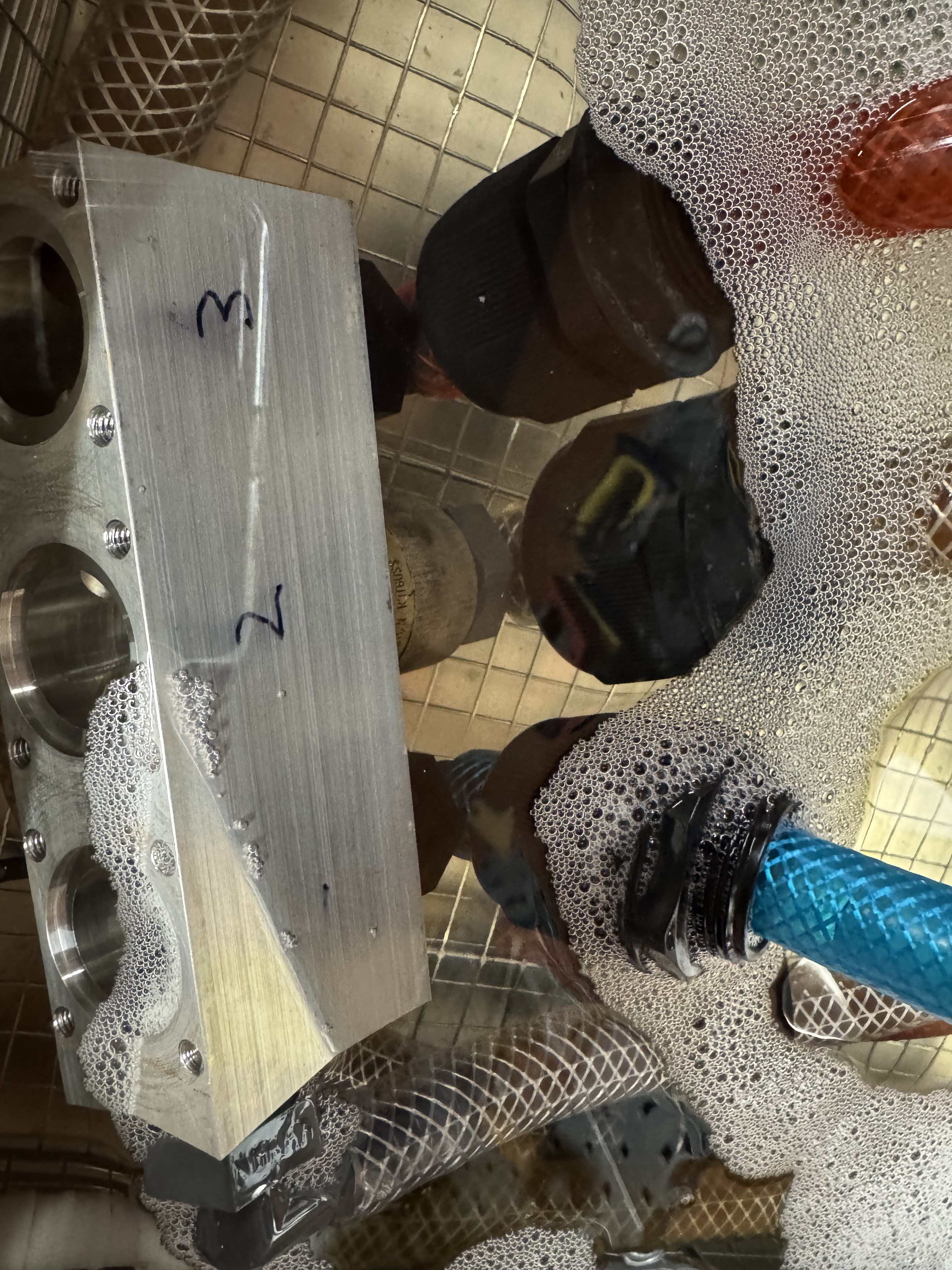

dpmiller Posted Tuesday at 16:48 Share Posted Tuesday at 16:48 built-up heads like that are more common on hydraulics, I think. Can you get piccys of the whole manifold assy- are the 3 valve just bushed together or is it a single base? what's the thread size of the hose fitting? Link to comment Share on other sites More sharing options...
Andyh747 Posted Tuesday at 16:52 Author Share Posted Tuesday at 16:52 I've attached another couple of photos. One was taken while I was cleaning the manifold. If you need more let me know. It's a single base and each coil has a spring loaded valve which is normally closed to seal that port. When commanded the valve opens allowing air through the correct hose. Link to comment Share on other sites More sharing options...

dpmiller Posted Tuesday at 17:00 Share Posted Tuesday at 17:00 here https://shop.yoviro.com/produkte/magnetventile/1032/luftverteilerleiste-3-fach-mit-anschlusstuellen?number=00020020 Link to comment Share on other sites More sharing options...

Andyh747 Posted Tuesday at 17:02 Author Share Posted Tuesday at 17:02 Just now, dpmiller said: here https://shop.yoviro.com/produkte/magnetventile/1032/luftverteilerleiste-3-fach-mit-anschlusstuellen?number=00020020 That looks like it - great find. Pity I have to buy the whole thing though. Only need the coil. However if it's the only option then so be it. Link to comment Share on other sites More sharing options...
dpmiller Posted Tuesday at 17:04 Share Posted Tuesday at 17:04 they do a single valve at 137€ too, but that's not dear really Link to comment Share on other sites More sharing options...
