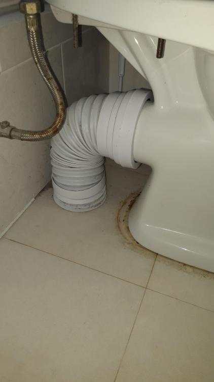

Late 60’s build. Got a soil stack - plastic 110mm connecting directly into a clay 4 inch elbow at ground level.
Unfortunately and obviously, the OD of the plastic is smaller than clay pipe so it doesn’t fit properly. It will have been like this since built. I’m thinking there used to be mortar around the joint to seal, but this has failed over the years. When toilet is flushed you can see it slightly bubbling around the join and it’s very slightly damp, but not affecting surrounding area. However, I’m worried about what happens if the pipework backs up. Surely that join needs to be waterproof!!
How should I rectify? See picture below. Thanks in advance.

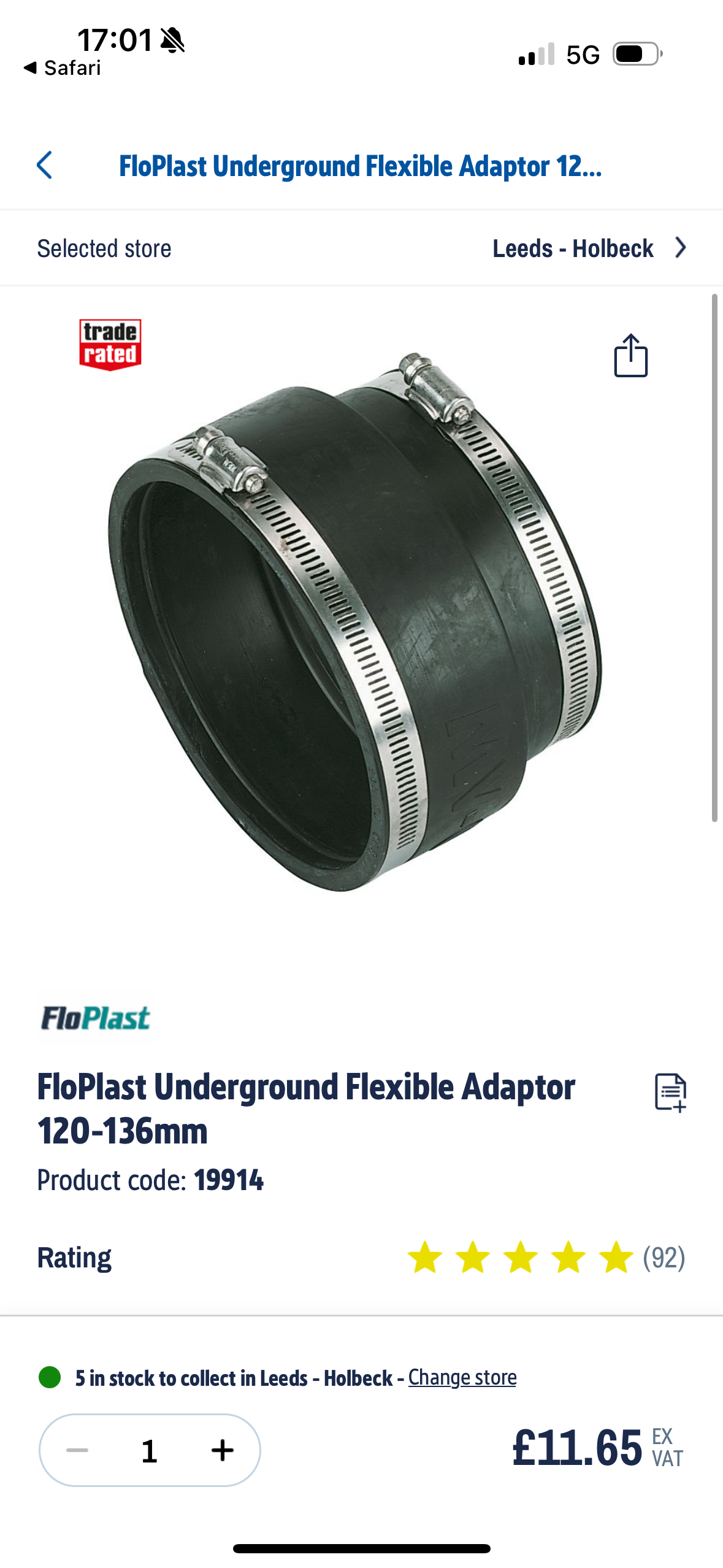

If you are willing to remove the PVC and re- plumb… Either band seal which comes with a variety of OD variations or you might have some luck with a male/female adaptor.

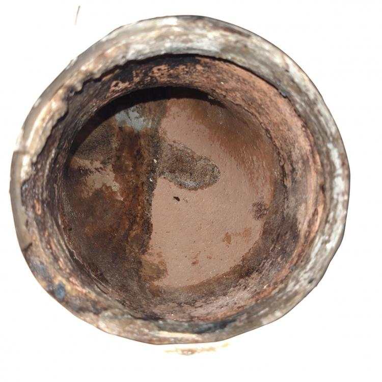

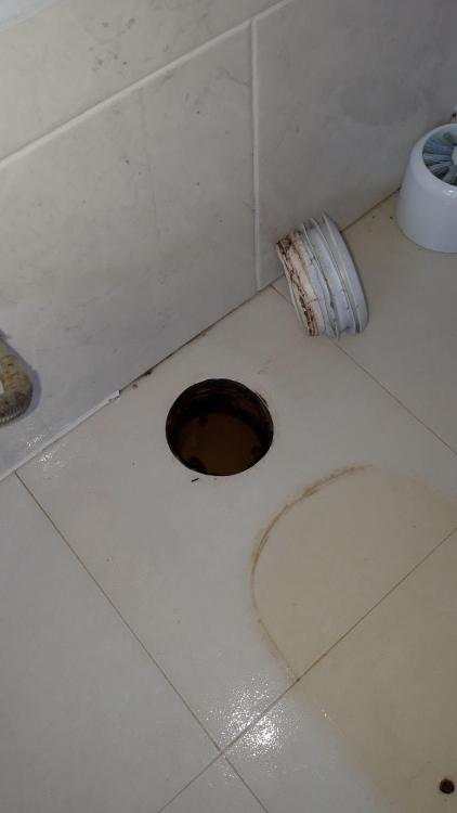

Is is external? I had to deal with this. A nice bathroom with new tiles sat straight on top of an old clay elbow:
IMG-20200828-WA0018.thumb.jpeg.293d7d9a08b9e6fc83e8e19d3ecad5f1.jpeg.6522ce7ffa7e7d5584f0c79d65226de0.jpeg
IMG-20200830-WA0002.thumb.jpeg.6dea4a0c07bd97de6e92e0809346f5a5.jpeg.1922fab136c051bb8a8399e161e7d260.jpeg
20200830_105812.thumb.jpg.59bac541aef4d47dd88d59068734c33f.jpg.4482bbeb69a4a2d2fd7398aa091279ab.jpg

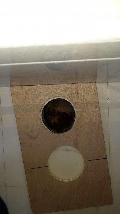

I made a ply template first to drill and neaten the ragged hole in the tile and substrate:
IMG-20200830-WA0008.thumb.jpeg.4f176f4161afd08192b3cbcbfb34d9f9.jpeg.8a1900da299ba51509b6b093f1f59e85.jpeg

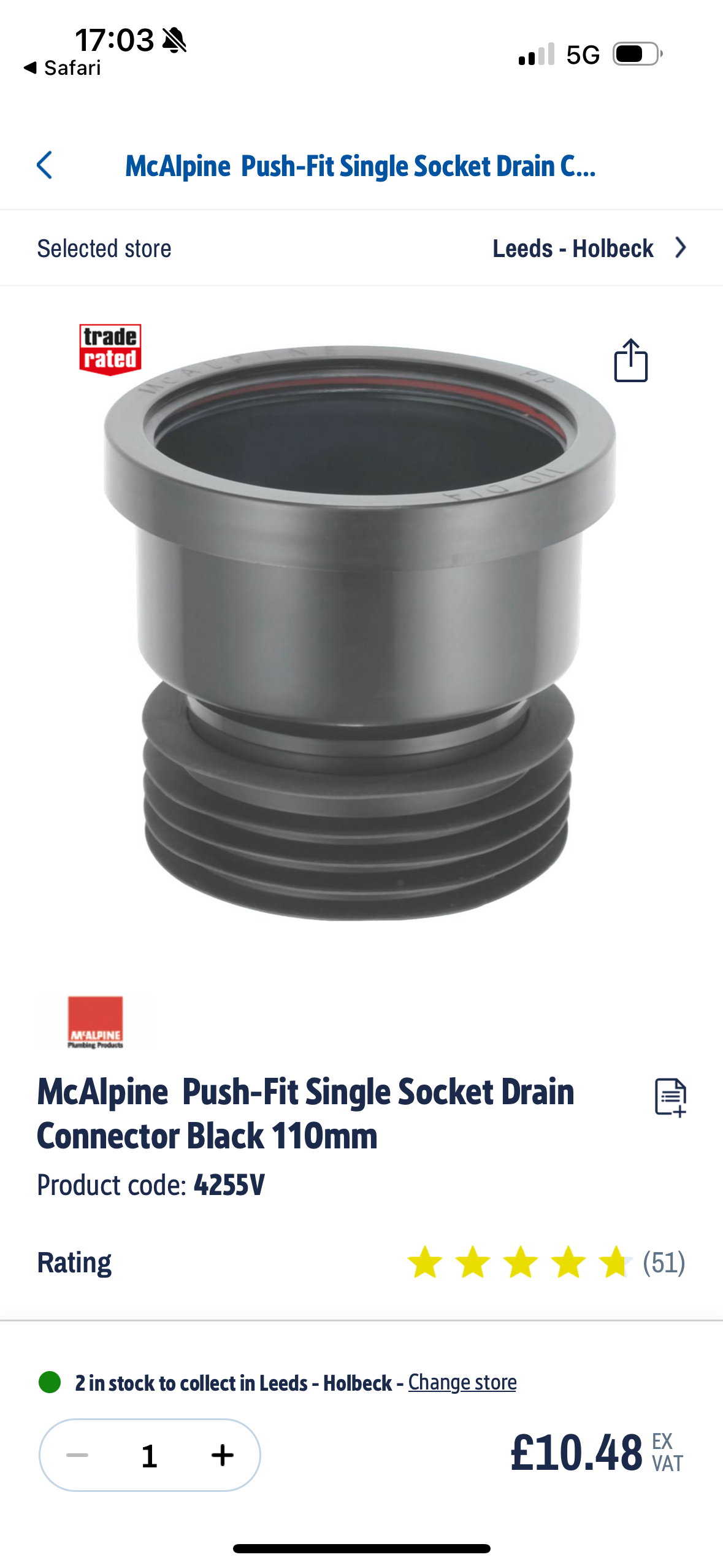

Then used a Floplast, finned adapter Screwfix stock number 15330 I think) that went down inside the clay pipe. Found it better oddly that a McAlpine one. Principle is the same for yours. You just need the 110m to finned adapter:
IMG-20200830-WA0020.thumb.jpeg.cd9609cead273529ce43d8eb34451d5a(1).jpeg.650f9c1e5a418dd01b39a81552064ff7.jpeg
I finished off with a really neat bead of BT1 after the last picture.
That and actually screwed the pan down properly!

The finned pipe connectors are for fitting inside a clay PIPE, not a clay FITTING/ELBOW like I have? (apologies for caps)
My clay elbow is designed for a clay pipe to fit into it? A complete cock up by the original builders in the 60’s imo.

 Sure, this is the band seal catalogue. There are a seemingly infinite number of variations on the theme…
 http://www.dureycastings.co.uk/uploads/DOCS/naylor-bandseals-brochure.pdf
They can be bought from pretty much any builders merchant although they may carry a different manufacturer such as flexseal. The benefit with this is they are quite a tolerant connection in relation to size and position.
Whilst the products  I posted may not specifically be the correct arrangement alternative variations on size are generally available, you just have to take your measurements and search for them.

Your correct I think but I've no idea what that existing, leaky "adapter" is that connects the grey 110mm to the clay elbow. Have you a Vernier caliper to give some ideas of diameter?
I wonder if this "4VFC2P" would work, as in get rid of the old adapter then fit this with a good slug of CT1 or similar:
https://www.drainfast.co.uk/products/underground/drainage/110mm/4110mm-dsocket-clay-plastic-adaptor
Thanks both of you. I think those adaptors are for connecting clay PIPE to plastic. Not clay fitting to plastic. I don’t believe there’s a fitting for that. If there is, I certainly can’t find it. A design cock up from when it was built.

The mortar collar in your second picture was a very common method.  Looking closer at your first picture it appears there's some small bits of stone / aggregate left and the rest has broken away?
If you don't want to remove / re-do, then if that's just mortar at the bottom I'd vacuum /scrub/clean it as best as and re-mortar any gaps after wetting with SBR. Then I'd paint with this, maybe even form a little brim at the bottom with tightly wrapped dpc and pour in so it self levels which is one of it's properties. More flexible than a mortar collar I'd reckon.
