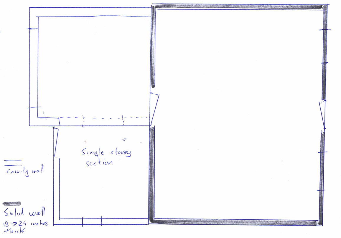

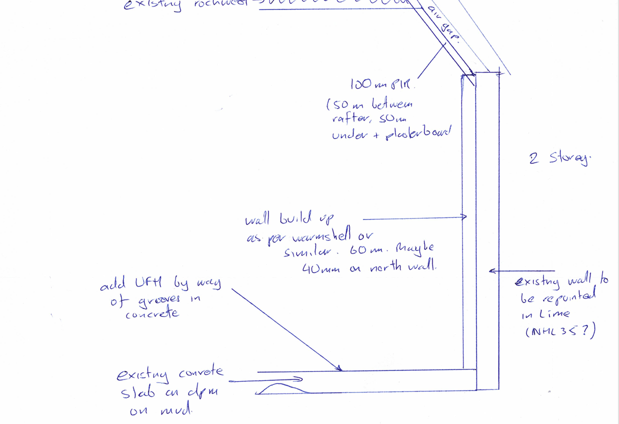

Roger440 Posted October 30, 2024 Author Posted October 30, 2024 Ok, heres some crude sketches of my plans as they stand at the moment. As you will see, the back of the house is cavity wall, not solid. Ive not worried about this too much at moment as this is a bit more conventional, though still going round in circles re EPS beards. The insulation system referred to is: https://woodfibre.co.uk/internal-wall-insulation-iwi-28-w.asp Hopefully its mostly self explanatory? Any comments welcome.

Redbeard Posted November 2, 2024 Posted November 2, 2024 OK: 150 PIR on the sloping ceilings would meet the Regs. 60 WF on the walls wouldn't, but you can put a cogent argument that you are reducing interstitial condensation risks and thus potentially extending the life of the building at a slight 'energy cost'. If I understand you correctly I think you are saying that if you cannot comply to the letter you may be better saving the BC costs and doing the best you can. I think the issue may arise when you come to sell, when the buyer's solicitor asks re works and re BC approval. If there is none they throw up their hands in horror but ultimately agree to be a lot less horrified if you drop the price, probably by an amount far in excess of the BC fee. Yes I know about indemnity policies and so on, but (a) that they cost and (b) that you cannot apparently get one if BC are already aware of the breach, which they may be via the potential purchaser's enquiries. I hope this helps. I don't expect everyone to agree with me but, in old examiner-speak it at least 'shows my workings'.
Roger440 Posted November 2, 2024 Author Posted November 2, 2024 36 minutes ago, Redbeard said: OK: 150 PIR on the sloping ceilings would meet the Regs. 60 WF on the walls wouldn't, but you can put a cogent argument that you are reducing interstitial condensation risks and thus potentially extending the life of the building at a slight 'energy cost'. If I understand you correctly I think you are saying that if you cannot comply to the letter you may be better saving the BC costs and doing the best you can. I think the issue may arise when you come to sell, when the buyer's solicitor asks re works and re BC approval. If there is none they throw up their hands in horror but ultimately agree to be a lot less horrified if you drop the price, probably by an amount far in excess of the BC fee. Yes I know about indemnity policies and so on, but (a) that they cost and (b) that you cannot apparently get one if BC are already aware of the breach, which they may be via the potential purchaser's enquiries. I hope this helps. I don't expect everyone to agree with me but, in old examiner-speak it at least 'shows my workings'. Im intending to die here, but that may not pan out, so yes, when selling it can be an issue. Traditionally an indemnity policy is peanuts, because the risk of action was essentially zero. I bought this house in the full knowledge that nothing that had been done, boiler aside, had certification. My previous house proved that such certification, of which there was plenty, was to all practical intents, worthless. Had i relied on it as evidence of compliance i would have been most disappointed. But, yes, going forward, logically those indemnity policies will go up in cost as the risk of enforcement increases. But to get to the nub of it, if it was just the BC fee, that would be OK. But its not like i can present my sketches and say, i want to do this, is that OK? Unless ive very much misunderstood, im going to need "proper" drawings, SAP assesment, maybe a WUFI condensation risk analaysis for the walls. None of these will tell me anything i dont already know. However, i cant do any of these things myself. Things things are not £50. So i either spend significant sums on these things, with no guarantee of acceptance as i am departing from the regs, and the risk of further reports and / or changes to what i can do. Then ill have to do the same again later when i do the windows. And the back of the house, the cavity wall bit. Each time another 4 figure sum. It makes no sense to keep shelling out for things that add nothing to the house, for a project that even without those additional report costs etc is way beyond the 15 year payback period to which the regs refer. Essentially, my choices are do it by the rules with lots of extra cost incurred, with no certainty what the final cost will be, just do it with out approval, or do nothing and buy more oil (which is the financially sensible option). My takeaway so far is that i could probably get approval for my plans, but at considerable additional cost. Cost which adds nothing to the final result. Though im struggling to believe anyone will let me do UFH on an uninsulated slab?!? Im conflicted given the new penalties...........................................

Redbeard Posted May 29, 2025 Posted May 29, 2025 On 02/11/2024 at 22:55, Roger440 said: But its not like i can present my sketches and say, i want to do this, is that OK? Unless ive very much misunderstood, im going to need "proper" drawings, SAP assesment, maybe a WUFI condensation risk analaysis for the walls. None of these will tell me anything i dont already know. Not sure if that is entirely true. You can still submit a Building Notice (which just says 'in no less than 2 days time from now I propose to start this work. You can come and look, and here's your fee). It works for work you are confident about, but you cannot guarantee that your BC will talk to you about it before you start. In my LA I am fairly confident they will agree with my rationale, even if the U value achieved is slightly worse than the B.Regs target. I don't think the Bldg Notice procedure has changed from what I describe. It hadn't in Oct last year, anyway, when I used 100mm wood-fibre to achieve a U value of around 0.35, against a target of 0.30. Under a Bldg Notice I *have* been asked (where relevant) to provide structural calcs. I *have not* ever been asked for 'proper' dwgs, SAP calcs or WUFI (though I have sometimes offered the latter.
Roger440 Posted May 29, 2025 Author Posted May 29, 2025 4 hours ago, Redbeard said: Not sure if that is entirely true. You can still submit a Building Notice (which just says 'in no less than 2 days time from now I propose to start this work. You can come and look, and here's your fee). It works for work you are confident about, but you cannot guarantee that your BC will talk to you about it before you start. In my LA I am fairly confident they will agree with my rationale, even if the U value achieved is slightly worse than the B.Regs target. I don't think the Bldg Notice procedure has changed from what I describe. It hadn't in Oct last year, anyway, when I used 100mm wood-fibre to achieve a U value of around 0.35, against a target of 0.30. Under a Bldg Notice I *have* been asked (where relevant) to provide structural calcs. I *have not* ever been asked for 'proper' dwgs, SAP calcs or WUFI (though I have sometimes offered the latter. Its probably far to say, theres a wide range of experiences, especially in the last year. Were your previous experiences before or after the changes to the system? Its clear that there was a lot more "judgment" going on before the changes. Im confident that what i want to do is sensible (and pretty much what most people would do in the circumstance), i have no confidence it will be accepted, without either all the supporting docs, or at all. Which rather precludes doing it under building notice as the risk of having to do it twice is too high.. Structural calcs wont be a problem for me as im not making any structural changes. On a purely technical note, 100mm of wood fibre to a solid wall is well past what most people would suggest is wise. Or was this more conventional construction?
Redbeard Posted May 29, 2025 Posted May 29, 2025 58 minutes ago, Roger440 said: Were your previous experiences before or after the changes to the system? After. I had to complete the relevant pro formas. I was client, PD and PC. 59 minutes ago, Roger440 said: On a purely technical note, 100mm of wood fibre to a solid wall is well past what most people would suggest is wise. To the end of that sentence I would add 'without a WUFI calc'. In this particular case I did not have one, but have had them for the same house and same orientation so I was confident to go on past experience in this particular case. My starting-point with IWI is always trying for 100mm unless WUFI says 'no'. 1
