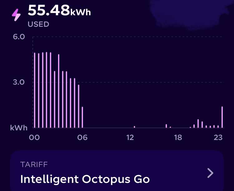

JamesPa Posted October 27, 2024 Author Posted October 27, 2024 (edited) On 26/10/2024 at 21:13, Simon R said: Without a battery far more would have been exported as it is generated at times when we couldn't use it. Any residual left in my battery gets used to charge my EV leaving just 20% in the battery to get me through breakfast and into PV time. It's not perfect by any means but it helps. Expand Sorry but the battery doesn't help carbon emissions. If excess generation is exported instead of being used by you then others on your street 'cause' less carbon emissions as a result of a proportion of 'their' electricity coming from your PV rather than a power station. The global (and even local) outcome is (more or less) the same with or without a battery. The only carbon benefit would be if you can store in a battery and use at times when carbon intensity is higher (in lieu of import). So far as I am aware batteries don't yet respond to the carbon intensity of the grid, they respond to price which does not appear to be a good proxy for carbon intensity (unless someone can show that carbon intensity and price are well correlated which hasn't occurred to date). Edited October 27, 2024 by JamesPa

Simon R Posted October 27, 2024 Posted October 27, 2024 On 27/10/2024 at 18:10, JamesPa said: Sorry but the battery doesn't help carbon emissions. If excess generation is exported instead of being used by you then others on your street 'cause' less carbon emissions as a result of a proportion of 'their' electricity coming from your PV rather than a power station. Expand I think we're both suffering a bit of confirmation bias, I could easily be wrong. The carbon intensity if the grid is not linear. The very times I'm using electricity are the times when the grid carbon intensity is at it's greatest. If having a battery helps smooth this great. I would love to think that if enough people had batteries it would prevent the firing of a gas turbine. Think local , act global. I'm not an expert, but I do care.
JamesPa Posted October 27, 2024 Author Posted October 27, 2024 On 27/10/2024 at 19:40, Simon R said: . I would love to think that if enough people had batteries it would prevent the firing of a gas turbine. Expand If they had batteries and solar then yes, on days it's sunny. But unless there is no local real time use for excess PV generated, the batteries aren't helping. This will likely occur when we have a lot more PV than we currently do, but at present there can't be many places in the UK where that is the case (we will know when we start getting charged for export not paid). In the absence of PV saturation and unless price and carbon intensity correlate, or they specifically charge and discharge their batteries to minimise carbon intensity not cost, then probably not.
JamesPa Posted October 27, 2024 Author Posted October 27, 2024 (edited) On 27/10/2024 at 19:40, Simon R said: The very times I'm using electricity are the times when the grid carbon intensity is at it's greatest Expand If that's the case for you then I grant a battery may help. However most people reputedly use a battery to minimise cost and, in the absence of a good correlation between cost and carbon intensity then that's not the same as minimising carbon. We could really do with some solid information on this, nothing would please me more than to find evidence that domestic batteries do minimise carbon as it would make the case for me to simplify my energy management! That said it may well be that consumer batteries are needed to reduce the infrastructure costs of a decarbonised grid to acceptable levels. Without a doubt electrification places strains on the grid which will require expensive infrastructure upgrades. These can be mitigated in part by load management. Whether we need batteries to do this or alternatively the combination of the management of car charging and using houses to store heat energy by managing heat pumps, I don't know. I'm not even sure that the industry has yet reached a position on this. My understanding is that, until recently, they were focussed on grid reinforcement (at our considerable expense) not demand management. I also understand that this may change now that NESO has been brought into public ownership. Edited October 27, 2024 by JamesPa 1

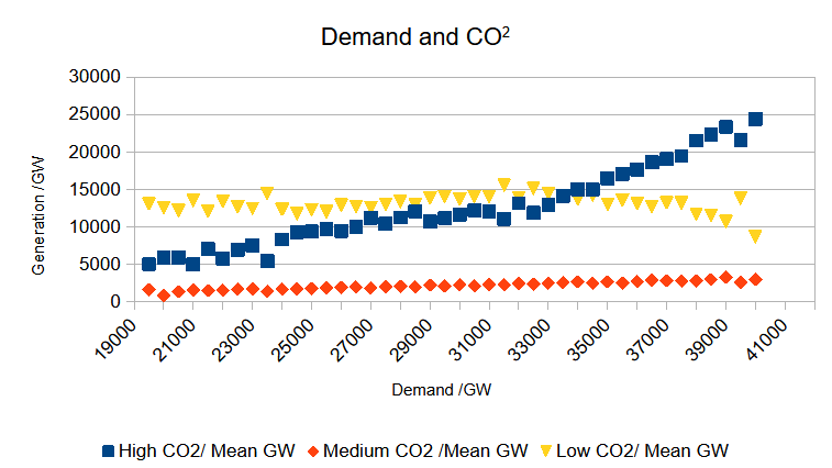

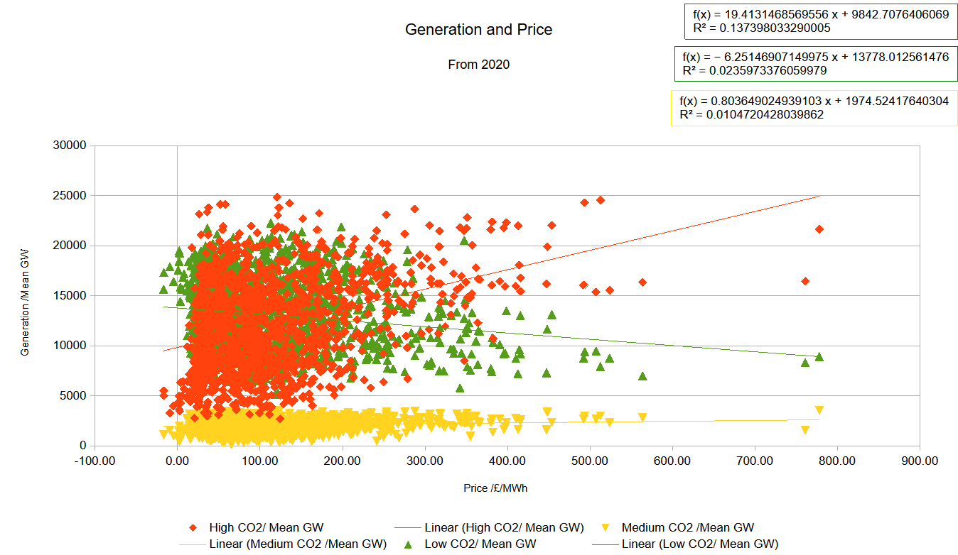

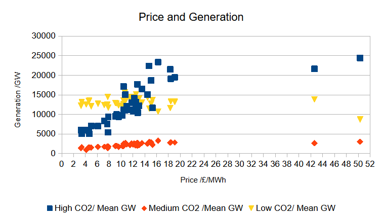

SteamyTea Posted October 27, 2024 Posted October 27, 2024 Right. As usual, with statistics, life is never easy. This is a correlation chart that plots price and generation. I have grouped the generation by CO2, Coal, Gas, Oil are high CO2, Biomass and Pumped are medium CO2, and Nuclear, Wind, Solar and Hydro as low CO2. The data runs from Jan 1st 2020 to 26th October 2024. More to follow

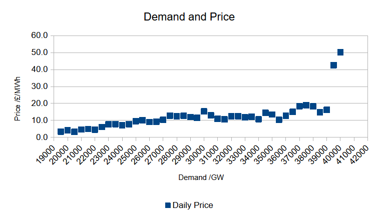

SteamyTea Posted October 27, 2024 Posted October 27, 2024 Right Some quick chart plotting against demand. The main thing I can glean from this very quick analysis is that two things happen. CO2 is lower when generation is lower i.e. <33000 GW and that charging batteries when demand is lower will increase demand, and therefore increase CO2. (I may have got the axis title wrong and actually mean MW not GW, shall have to check later, like tomorrow, as it is past my bed time)
