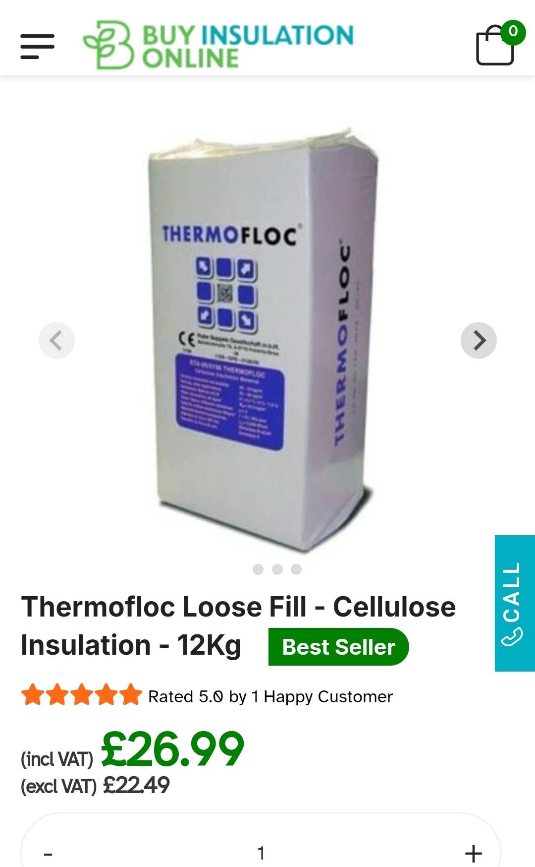

For walls it needs to be 60kg/M3.  So approx £135/m3 plus install inc VAT.
Screenshot_2024-10-16-23-21-48-361_com.android.chrome-edit.thumb.jpg.0288f948a9bad5943af954c2f3698fc4.jpg
Not sure but I think that means it’s circa £16/m2 (exc.) at 140mm which is the same as I found nyrock frame slab for, and that has no installation costs (as a little old and round bald guy will be running round fitting the nyrock for free!).

m³ Vs m²
Cellulose is about £19/m² plus install. I have a feeling an installed price from a supplier would be much the same as they buy in bulk.
Don't forget the airtighess benefits it offers too.
