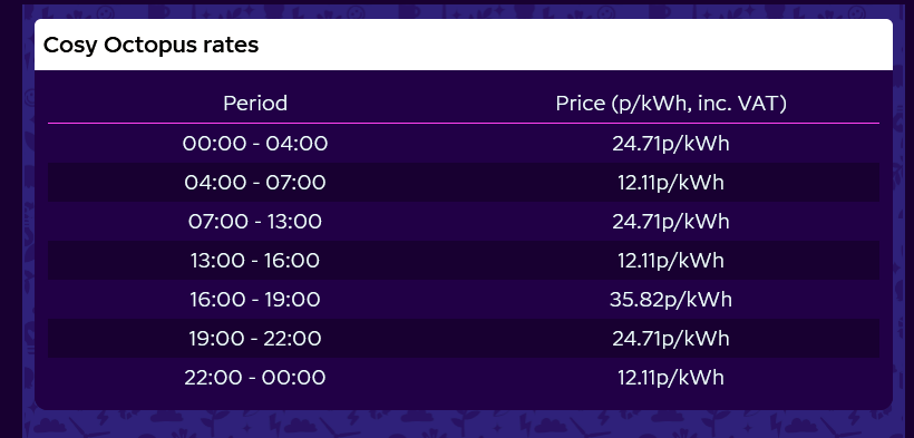

PhilT Posted October 23, 2024 Posted October 23, 2024 On 17/10/2024 at 07:13, JamesPa said: Probably so, but Octopus Cosy is really a battery tarrif not a heat pump tarrif. If you don't have a battery then I can't see it's useful to those with a heat pump. Expand I beg to disagree. If you already have a heat pump then Cosy makes financial sense without a battery. Getting a battery by itself just for Cosy would not be financially justifiable. For a heat pump consuming say 3,000kWh pa there would be a potential maximum saving of (3,000 x 12p) = £360 pa, with no up front investment, having already bought the heat pump. For a battery only, for an average consumption of 3,000kWh pa, the potential maximum saving would be the same at £360pa, but with a big up front investment. Considering the alternative use of your money at a few % interest on a fixed deposit account for 10 years after which you get all your money back, I would not consider getting a battery just for Cosy. Happy to be challenged on this.

JamesPa Posted October 23, 2024 Posted October 23, 2024 (edited) On 23/10/2024 at 14:07, PhilT said: For a heat pump consuming say 3,000kWh pa there would be a potential maximum saving of (3,000 x 12p) = £360 pa, with no up front investment, having already bought the heat pump. Expand If you only run the heat pump during the low rate periods then yes, but that will clobber the heat pump efficiency as you will need a higher flow temperature to deliver the same amount of energy. And you have to offset any saving against the extra daytime/peak cost. Ovo currently offers 15p/kWh for the entirety of your heat pump consumption irrespective of time of day, provided you have the right heat pump. I reckon that's unbeatable if you qualify, but also unsustainable for OVO Edited October 23, 2024 by JamesPa 1
