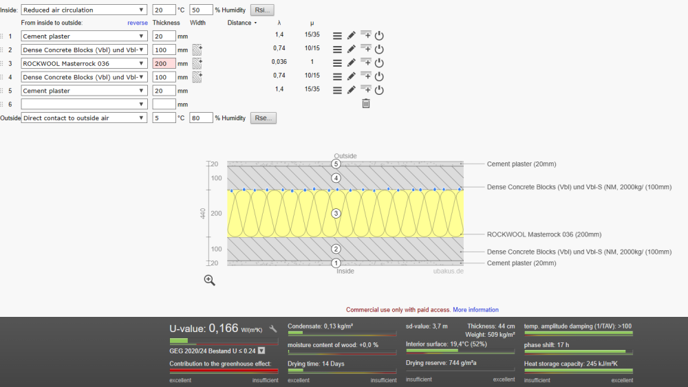

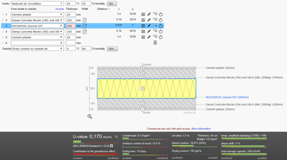

Jane W Posted May 3, 2025 Author Posted May 3, 2025 On 27/04/2025 at 09:13, Ben1984 said: My current thinking is that it can't be done. I've also arrived at the same conclusion. I'd like wet plaster so probably going with 375 cavity. Going to check out prices of dritherm 32 vs 36 as I've been told you get much better deals on dritherm 36, which brings medium density blocks + brick outer in with u value of 0.18. Dritherm 32 would give 0.16 iirc.
Ben1984 Posted May 3, 2025 Posted May 3, 2025 9 hours ago, Jane W said: I've also arrived at the same conclusion. I'd like wet plaster so probably going with 375 cavity. Going to check out prices of dritherm 32 vs 36 as I've been told you get much better deals on dritherm 36, which brings medium density blocks + brick outer in with u value of 0.18. Dritherm 32 would give 0.16 iirc. 375 cavity? I presume you mean 375mm wall with 175mm cavity. The price difference between 32 and 36 dritherm is significant! This thread has convinced me that a wider cavity is the way forward for my project. If internal space really was a priority I might even consider PIR over 32 dritherm.

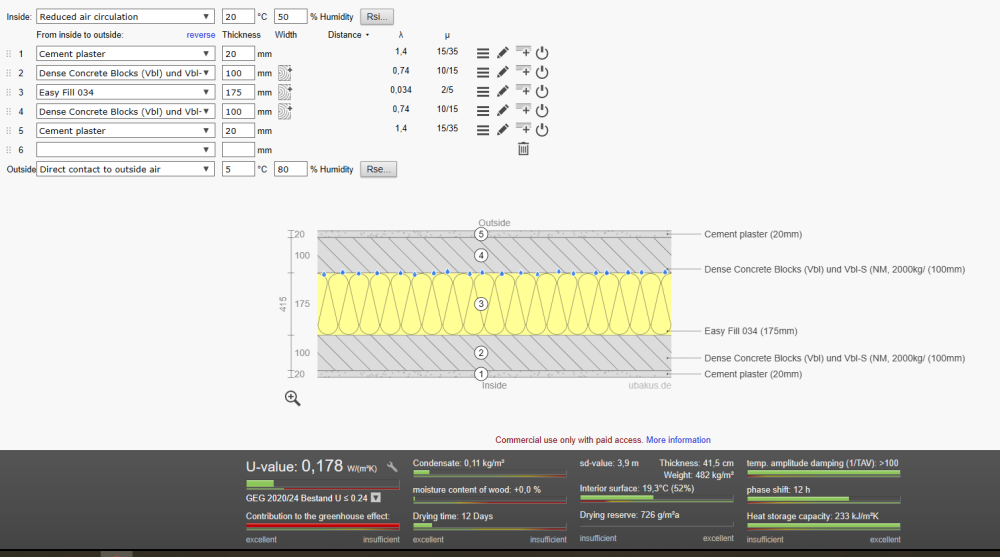

SBMS Posted May 3, 2025 Posted May 3, 2025 6 minutes ago, Ben1984 said: 375 cavity? I presume you mean 375mm wall with 175mm cavity. The price difference between 32 and 36 dritherm is significant! This thread has convinced me that a wider cavity is the way forward for my project. If internal space really was a priority I might even consider PIR over 32 dritherm. Why not fill with EPS beads? Similar to 32 dritherm in thermal resistance (0.033) and cheaper when I priced ours up. FYI we are a 200mm cavity brick and block with beads and are at around 0.14 u value.
Ben1984 Posted May 4, 2025 Posted May 4, 2025 11 hours ago, SBMS said: Why not fill with EPS beads? Similar to 32 dritherm in thermal resistance (0.033) and cheaper when I priced ours up. FYI we are a 200mm cavity brick and block with beads and are at around 0.14 u value. I'm doing the blockwork (along with everything else) on our build which means there are no installation costs for the dritherml, just my time. I would have to pay a contractor to blow in the EPS beads so in my circumstances I suspect it would add to the overall cost of the structure. I have used cavity batts many times before and I know that I can install them well. I have no personal experience with EPS beads and while they could perform slightly better I perceive them as a risk so i'm reluctant to use them.
SBMS Posted May 4, 2025 Posted May 4, 2025 12 hours ago, Ben1984 said: I'm doing the blockwork (along with everything else) on our build which means there are no installation costs for the dritherml, just my time. I would have to pay a contractor to blow in the EPS beads so in my circumstances I suspect it would add to the overall cost of the structure. I have used cavity batts many times before and I know that I can install them well. I have no personal experience with EPS beads and while they could perform slightly better I perceive them as a risk so i'm reluctant to use them. Fair enough however pumped beads installed for me was less per sqm than I could get dritherm at. I think a pumped installation will get every nook and cranny that is tricky to do by hand, but each to their own 👍
