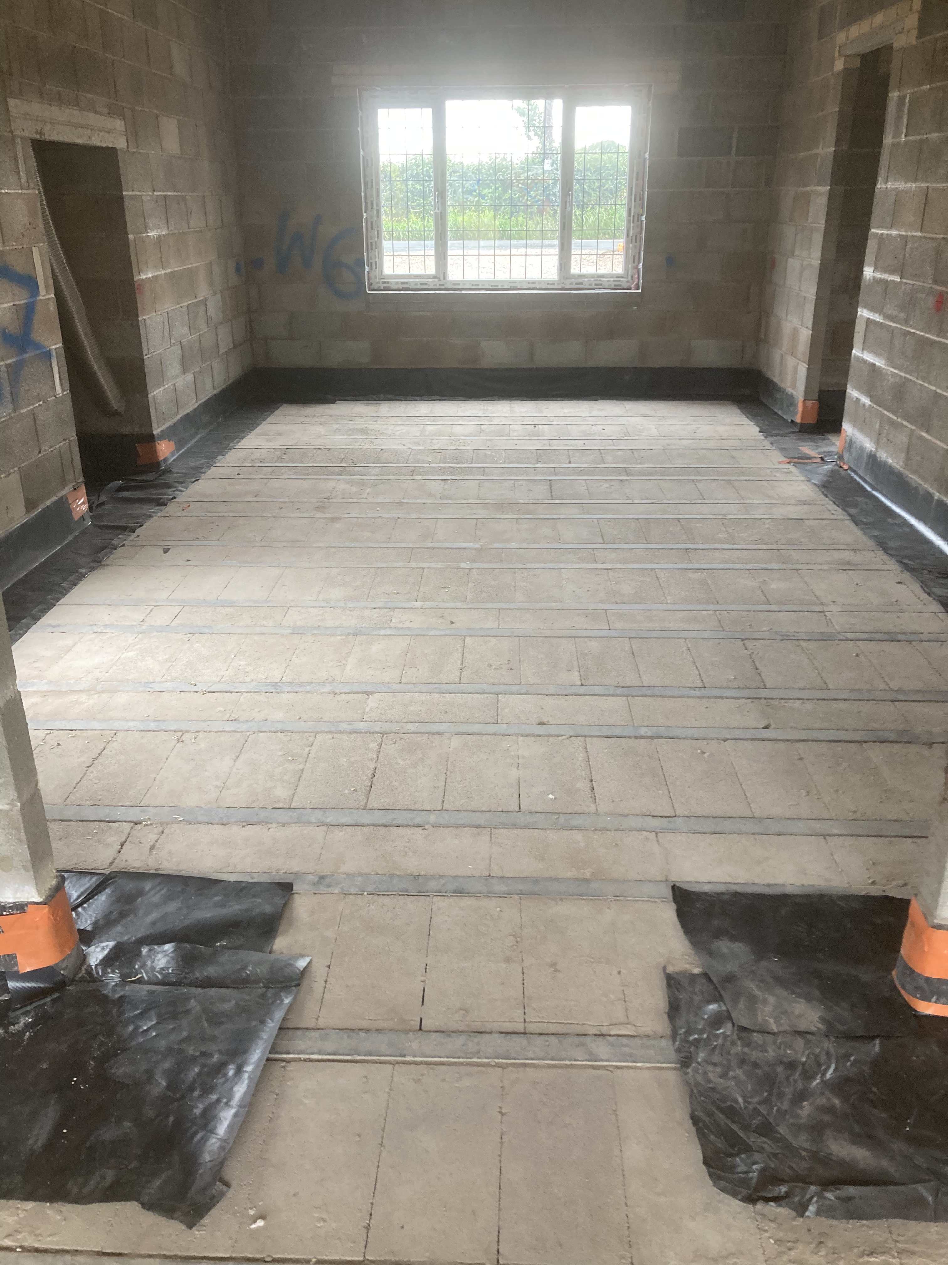

CalvinHobbes Posted October 13, 2024 Share Posted October 13, 2024 Looks like we might be doing this, need to know where to stick the membrane to at edge...etc. anyone have pics? Link to comment Share on other sites More sharing options...
Iceverge Posted October 13, 2024 Share Posted October 13, 2024 More details needed. Is it for a shower or a foundation or flat roof or something else? Link to comment Share on other sites More sharing options...
nod Posted October 13, 2024 Share Posted October 13, 2024 I normally run a meter apron around all the walls 2 Link to comment Share on other sites More sharing options...
CalvinHobbes Posted October 15, 2024 Author Share Posted October 15, 2024 On 13/10/2024 at 20:04, Iceverge said: More details needed. Is it for a shower or a foundation or flat roof or something else? It's for the whole ground floor. The front of the house is slab, the back poured. So we need to get down the membrane get the PIR, stagger it, tape and what a long edges internal, external? What about in bathrooms around pipes? Link to comment Share on other sites More sharing options...
CalvinHobbes Posted October 15, 2024 Author Share Posted October 15, 2024 On 13/10/2024 at 21:51, nod said: I normally run a meter apron around all the walls Brilliant 👍 😍 Link to comment Share on other sites More sharing options...
CalvinHobbes Posted October 15, 2024 Author Share Posted October 15, 2024 So we need to put in water pipes between the layers? Like the pipe to feed water to the island. So we cut out the insulation for them so the top insulation lies flat? Anyone any pics? Link to comment Share on other sites More sharing options...
